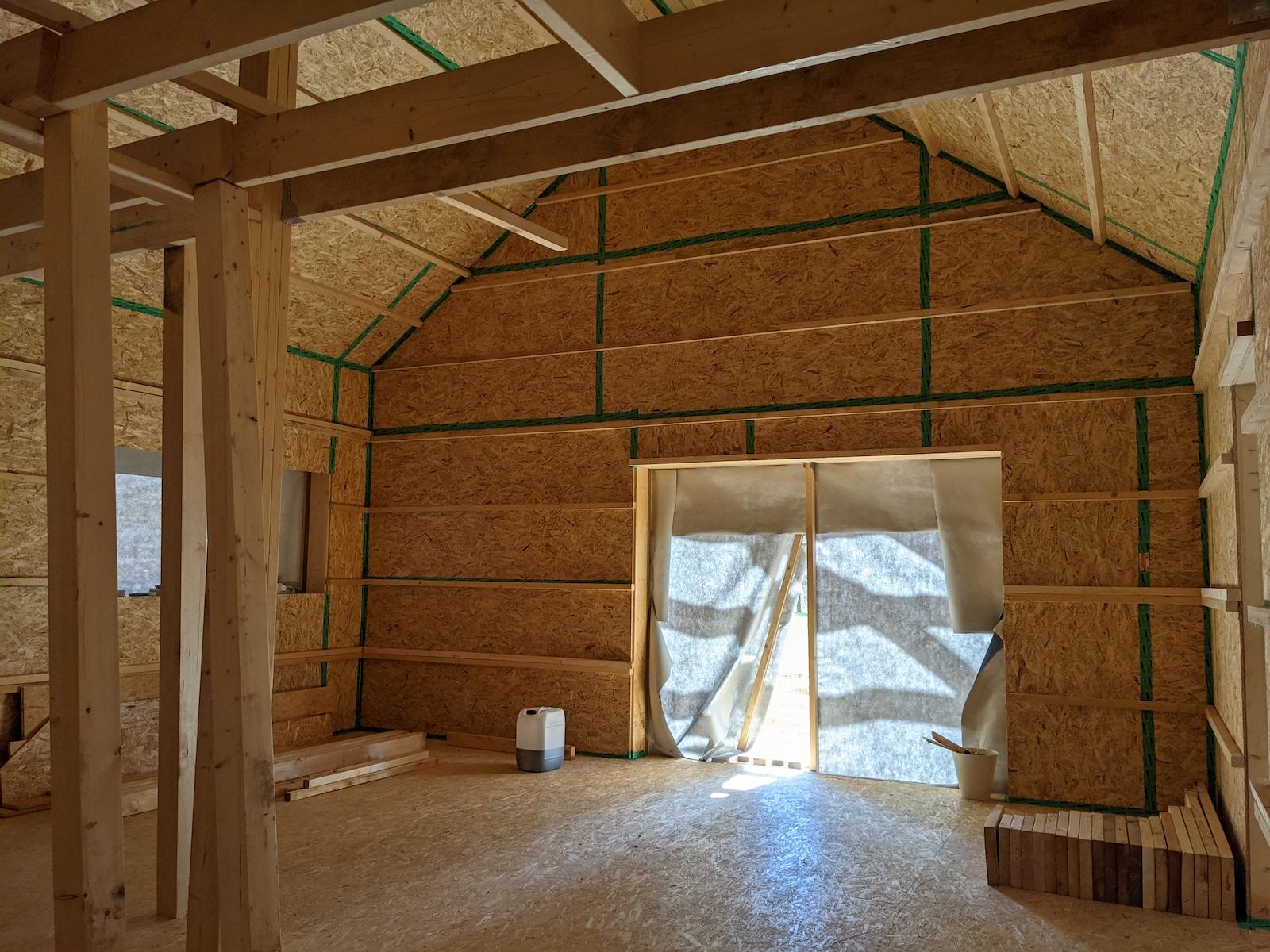

Would also build frame without OSB. Just a diagonal on the opposite side. Add OSB afterwards. Minimises weight to lift and you can square up the the house this way then nail it all before it moves. You can also let it get wet (the solid timber) if you must before having a couple of dry days going crazy with the OSB and getting it covered up before it turns to weetabix? Walls were built in max 6 x 3 metre sections here. 10 studs. Header and sole plate. 2x8s so approx 200 kg a section. 2 men to lift; 1 man to prop and stabilise with rope until secured.

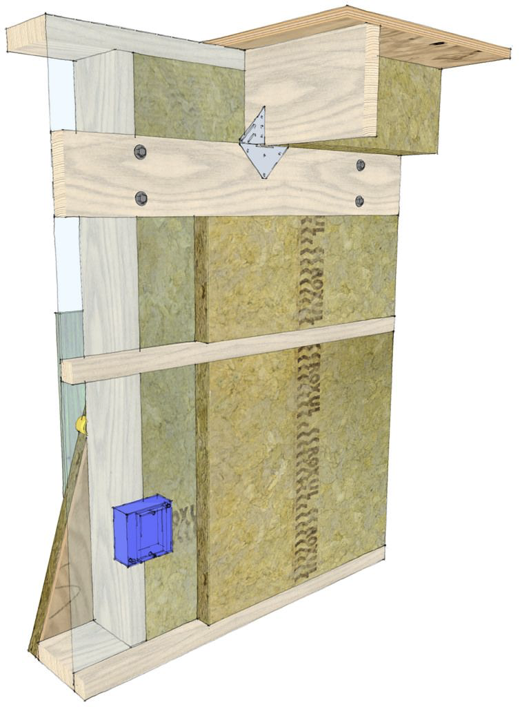

Use 18 mm for making structural box beams? 9/10/11/12 mm is PLENTY for sheathing to give shear resistance. It's also walkable on 600 centres for the purposes of adding insulation / putting on a roof etch as long as you're not a particularly fat bastard or jumping up and down etc. For headers...I would do this next time: https://bygghouse.com/wp-content/uploads/2017/02/Summary-of-Swedish-Wall-Element-Construction.pdf http://blog.lamidesign.com/p/swedish-platform-framing-info.html (single header, bring the wall studs all the way up to the level with the floor, then put your "second header" vertically against the inside of the wall to carry the floor load - after you've lapped your airtightness membrane over the top of the header ready to sandwich it under the floorboard. Tape the bottom piece of airtightness membrane down onto the floorboards before you build the next level of wall on top. It'll then be squashed down by the sol plate of the floor above. Roof trusses can be treated the same way. Those little diamond tiedowns pick up the roof truss at the top, then the header on the two side ears, and (if aligned) the wall stud on the bottom ear...but from the outside not from the inside. so that there's nothing to interrupt your airtightness membrane...that you remembered to lap over the top of the header, taped to the existing wall membrane, before you sat the trusses on top of it. Use some little tiling battens to squash the taped joint flat for extra security if you like.

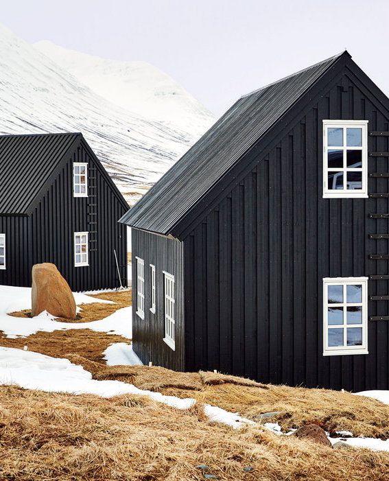

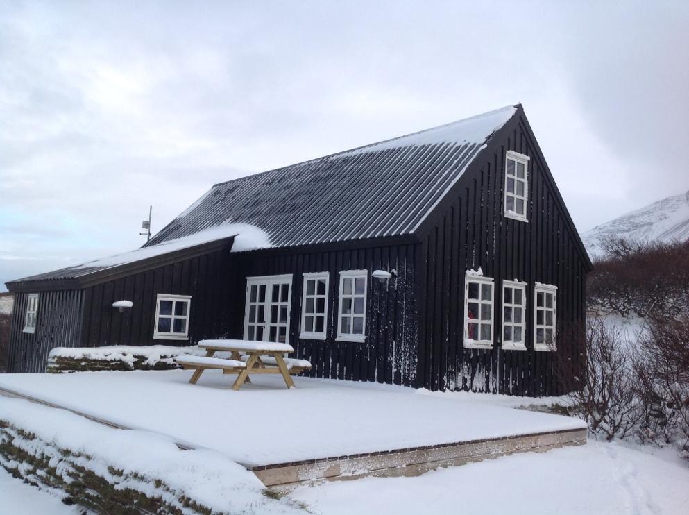

Creating "frameless" look by overcladding frames?
markocosic replied to markocosic's topic in Windows & Glazing

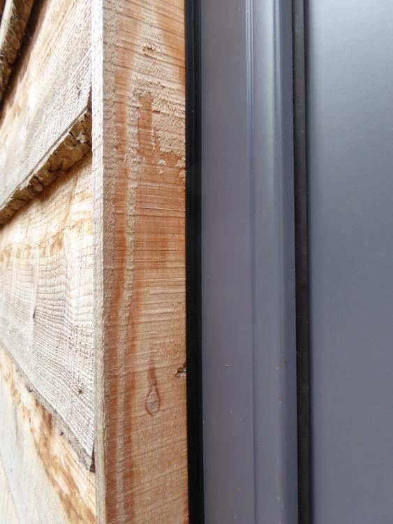

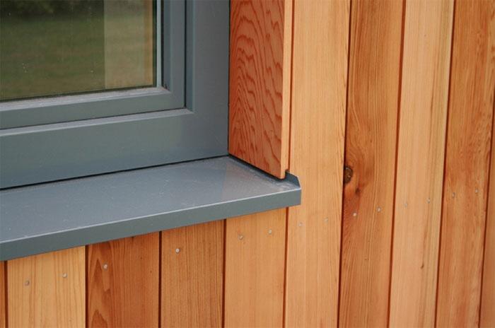

White: (and poking out past cladding) Dark: (but again reveals poking out past cladding) I can't find dark examples where the reveals sit behind the cladding. Probably because it'd be a PITA to make and swapping out the occasional rotten reveal isn't a dealbreaker. -

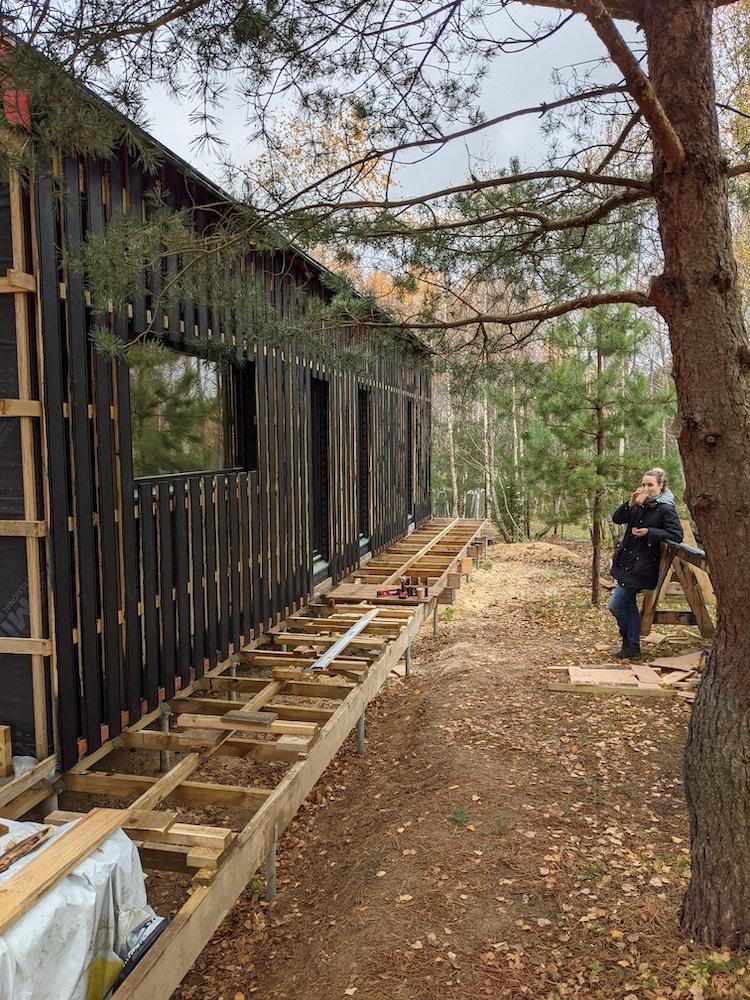

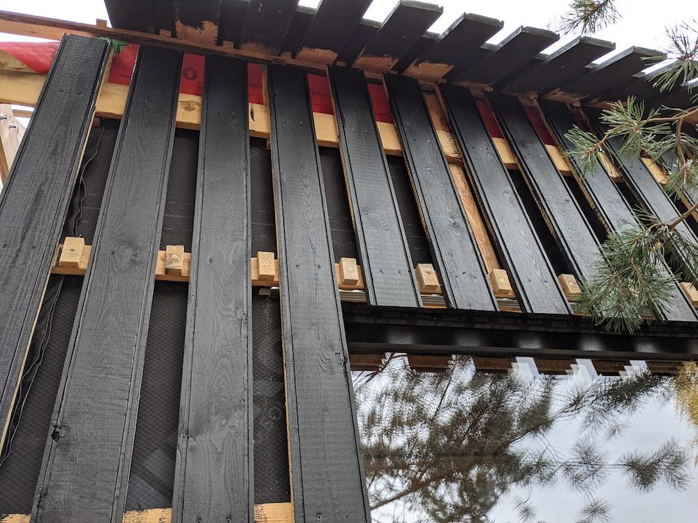

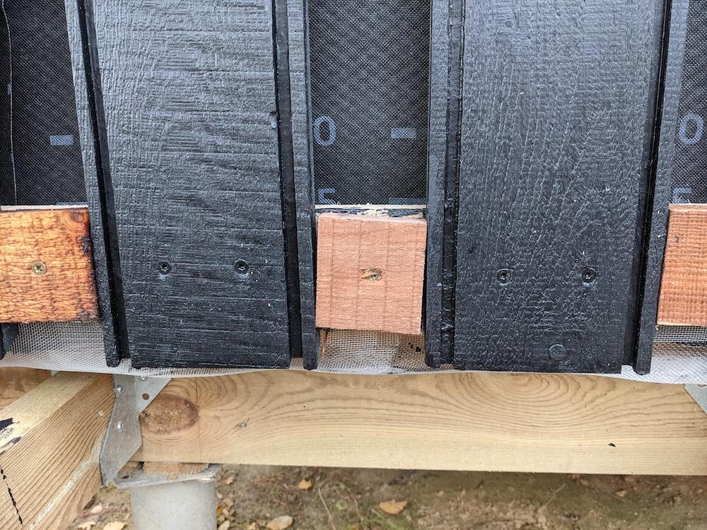

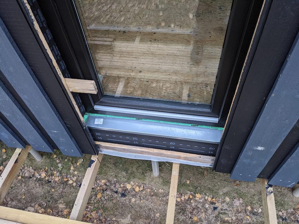

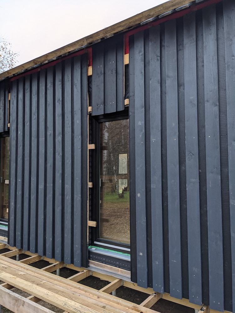

Screwdriver for window changes. I imagine that the UPVC frames will outlast the cladding immediately around the window anyhow. Progress has been made: Here's a tip for doing the bottom of board-on-board cladding. You need blocking between the 'inner' boards to close off the gap to avoid insects making it their home. (the ventilation happens behind the horiontal battens and is closed off by a "U" of metal mesh between the face of the horizontal batten and the face of the house) Don't cut these to exact length. Cut them short and fit them on an angle to suit the (variable) gap between each board. This is fast and there's no danger of them ever over-expanding forcing things apart should they find themselves damp. Mainly it's fast. Current window detail is this: There's a little metal channel above each window to catch any water running down the membrane. Probably total overkill but given that the roof is also wooden and there's a non zero chance of a knot falling out etc we might get water running down that membrane. This will keep it from falling on the horizontal cladding board above the window. You can see some crumbs on the wall membrane from where it was only membrane on the roof/walls (with these little channels above the windows) for 6 months. It did help keep water away from the windows during this time. Drip edge above is a 30 degree cut on the end of the boards. There'll be a horiontal board between the window frame and these to close the top of the reveal. Either side of the window finishes as an "inner" board to make the detailing a little less painful. This will be trimmed to width in situ then a vertical board fits behind it and across to the frame as the sides of the reveal. Perhaps I'll trim them back more and have the "sides" os the reveal poke out beyond the cladding boards like JSH's horizontal cladding in the earlier post. This is bottom of the reveal. A 'secondary sill' sits upder the window frame (frame drips are on the underside - this in hindsight was a mistake as it would be much easier to clean these and to seal frame<>sill if they were face mounted frame drips) and catches everything from the frame / window reveal tapes and dumps it outboard of the wall membrane but inboard of the cladding (i.e. anything getting in here disappears behind the cladding) Over the top of this is going to be a wooden sill / step that's loadbearing, pretty, and mostly waterproof but doesn't need to be completely waterproof. Now that my wife has an idea of what the finished item will look like (the outer boards still need all the screws putting in and their final coat of black rather than grey)... ...I think these are definitely not going to be frameless and it's all a bit RAL9005 at the moment. It might even get a decorative reveal in a contrast colour. I'll leave this detail until the 11th hour so that she can decide. Perhaps post a few photos for her to choose between too... -

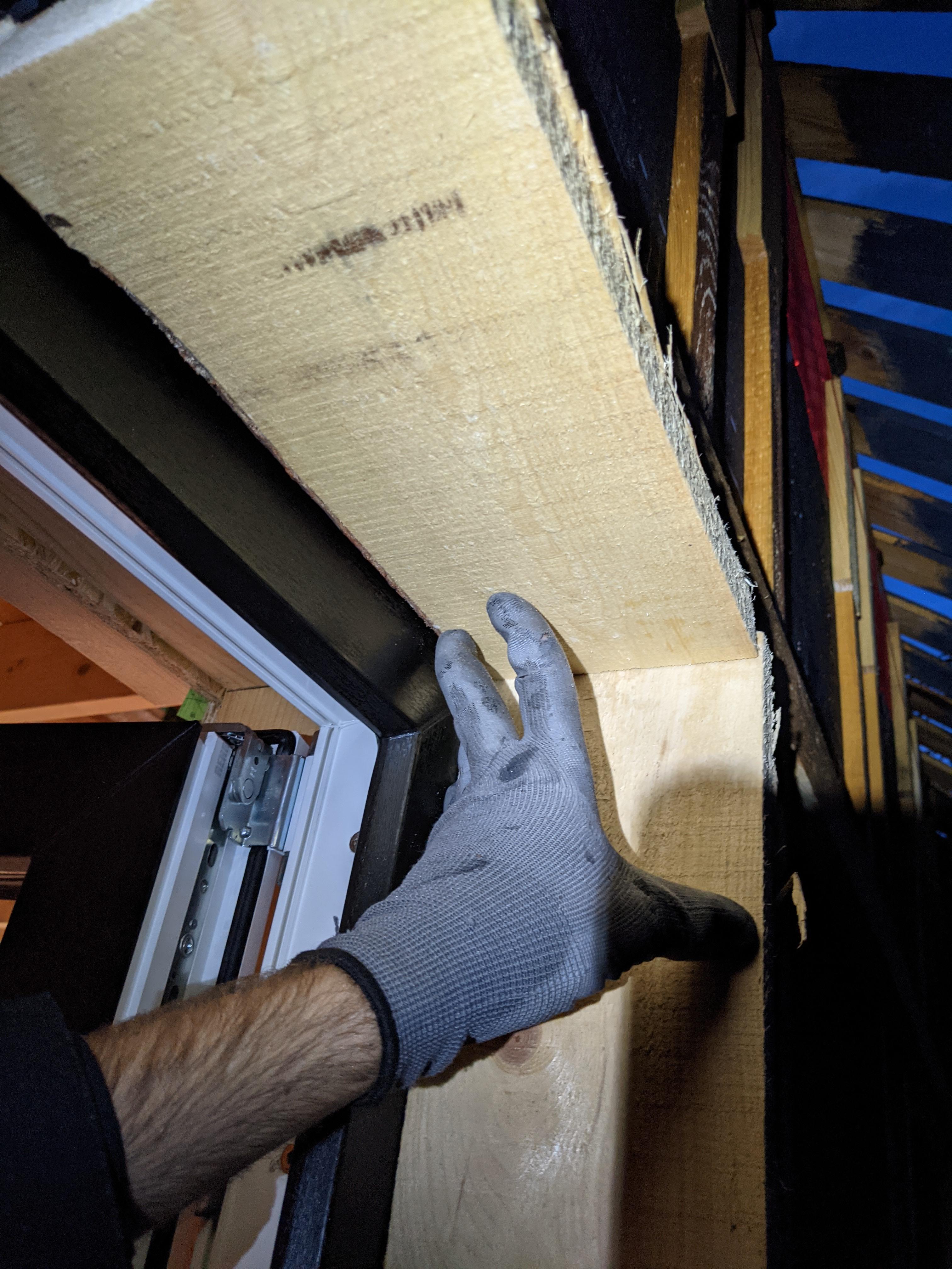

Thanks folks, We're not worried too about water for the frames / house - it's water tight as is and the cladding is more for UV / mechanical protection. Imagine this (incl metal sill pan under window frame with the frame weep holes into the metal pan) with the wood replaced by a membrane. That's the waterproof later. The cladding then sits on top of that, spaced away with battens, that should deflect most water but doesn't need to be waterproof. Sill detail is DEFINITELY going to match in terms of visible frame. Wooden sill floats above metal pan at the appropriate height too match the sides and top in terms of exposed frame. Metal pan drips between the membrane and the cladding. (i.e. not visible) If it weren't for insects I'd be tempted to leave a gap between the (wooden) cladding and the (uPVC) frame to aid drying of the reveal cladding. With insects to consider a seal is probably in order. I like the JSH finish here.. With dark frame and wood it should disappear: But perhaps sticking the angle the frame so that the wood can move without bringing the angle with it. (150 mm reveal could move +/-3 mm? ) Or just black foam strip and be done with unless/ until the insects cause trouble? Accuracy and long term stability if shrinking the reveal is a valid concern. 0-15 mm you'd see. 40-55 mm you'd see less. Wood moves. It's never going to be "right" if done "frameless" is it? Best argument for not doing it? We'll have a play. Probably they only way to really see if swmbo likes they look or not! -
We have inward opening windows (Basic uPVC in 'near black fake wood' finish) We have a wooden roof and will have when clashing to match. This was going to be our window detail: (overcladding about 20 mm of the outer frame leaving perhaps 55 mm visible all round - the actual wall cladding is outboard of this 120-150 mm deep reveal) We could also move this to cover "all" of the outer frame leaving just the inner part of the frame visible. Anybody seen this done before? Does it look like a feature or a bodge? I can't picture it as it stands. Thanks

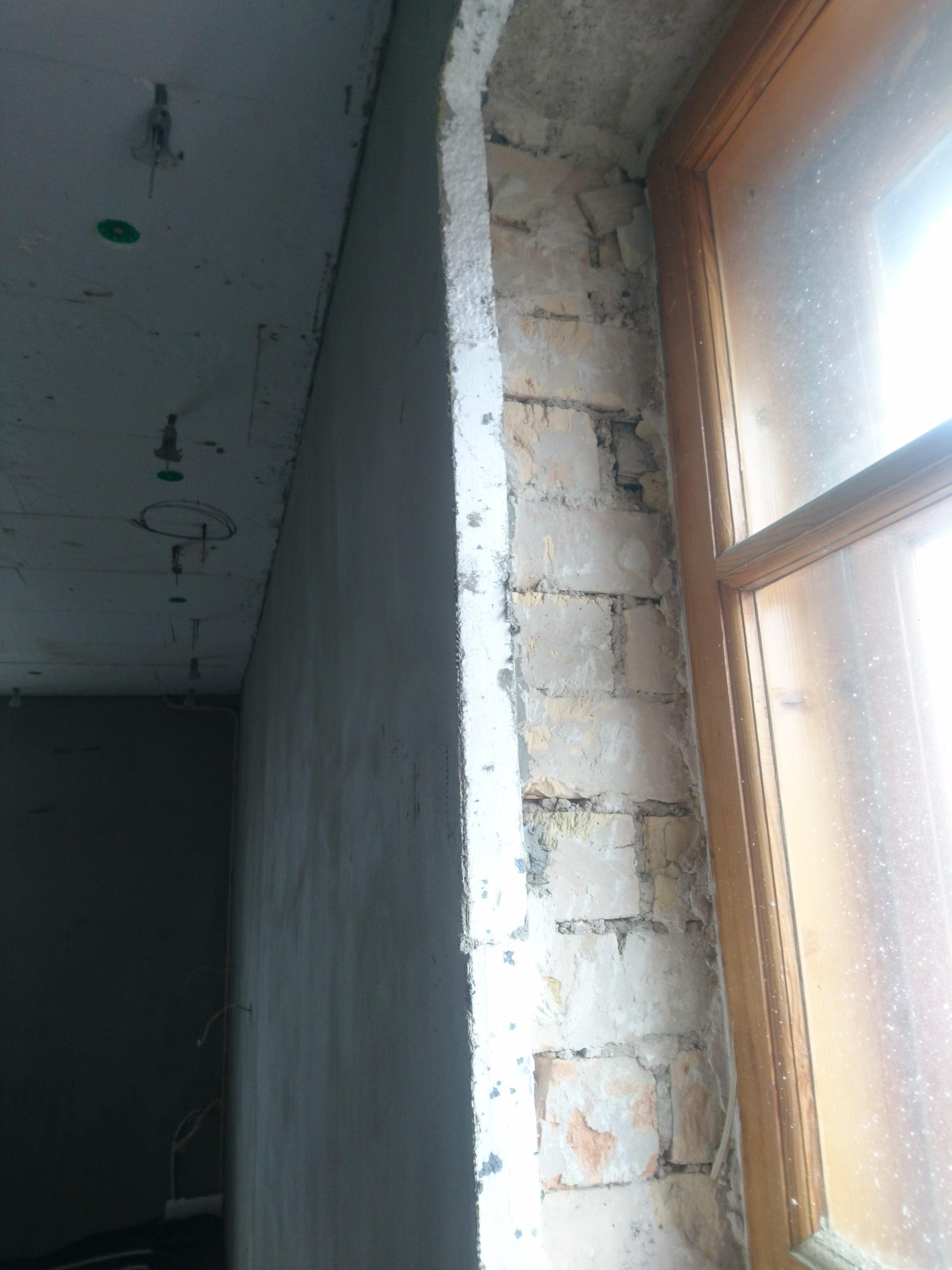

Surface ends up about 4 mm render then 3 mm plaster on top of that. (the soft white stuff not the hard pink stuff) Compared with dot and dab then skim there's no chance of getting hairline cracks between boards. It's quite tough yet flexible and basically had scrim tape/mesh...everywhere. Waiting on new windows in this shot: -

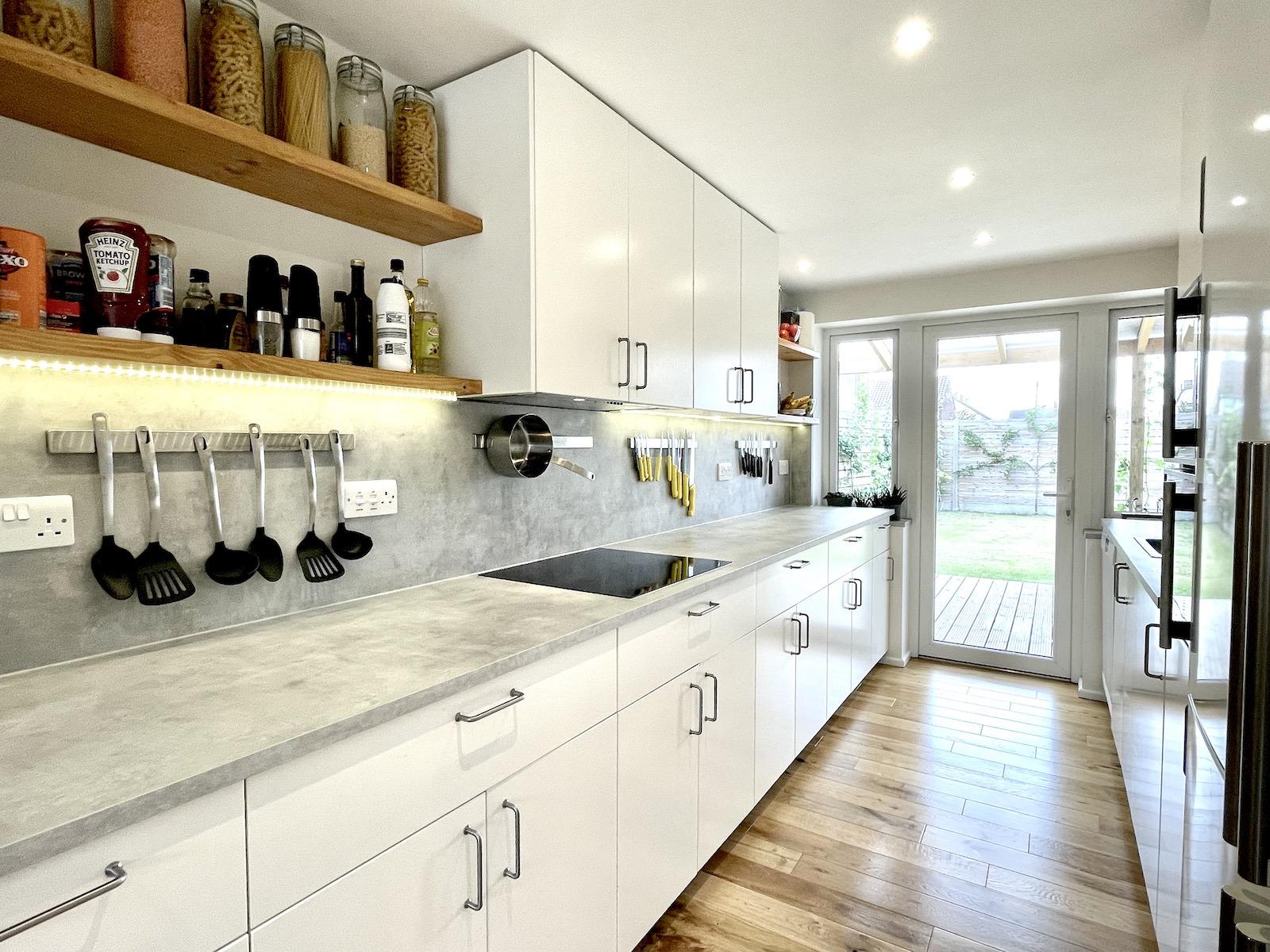

Kitchen extract - Ever used/fitted/made a downdraught one?
markocosic replied to markocosic's topic in Ventilation
Recirculation is still up for debate. I'm sceptical because life experience of recirculation to date has been awful (shitty flats with grease filled asthmatic mouse recirculation hoods) whereas extract hoods have been decent (at extracting anyhow). Too sceptical to rely purely on recirc. It's a newbuild. It's tight and it's having MVHR. Hob would be going to the left of the bucket. It could also go in front of the window to the left but I fear that would be insanity unless you like drawing on grease or you had a pop-up downdraught extractor / splash guard behind the hob. (such as http://www.hobcoversdirect.co.uk/index.html very practical but icky style) The MVHR has a bypass on the extract. It's a proper* bypass with motorised shutters to close flow through the core and a motorised bypass to go around it. By default it opens when the indoor temperature rises too much. It can also be controlled manually. Boost flowrate is 500 m3/hr at 100 Pa drop. It is very tempting to pipe the extract the hood into this. "Low" hob extract = boost and bypass the MVHR (only) and extracts steam in near silence. "High" hob extract boosts and bypasses the MVHR and adds the hob extractor fan in series to counter the duct / filter pressure drop. "No" hob extract is also an option if it's only steam. (allow the regular MVHR to clear the moisture) Or extract to outdoors. Or setup as a recirculation hob with the option to shove it through the wall later. It wouldn't be done for energy saving. (bypassed MVHR is the same as pure extract) It'd be for noise as much as anything else. Extracting from the oven is also up for debate. (if you roast meat or you roast potatoes in fat etc then fan ovens vent grease) Perhaps we should extract into the oven then bake all the grease out occasionally... https://www.berbel.de/dunstabzuege/zubehoer/umluft-zubehoer/umluftfilter-permalyt/ *Another MVHR unit that I bought had a joke bypass. There was a tiny flap next to the core with a wax filled actuator that would - slowly - open as the temperature rose. No blanking of the core. Just a flap that in theory moved with heat and in theory bypassed some air so that they could tick the box for having a summer bypass. The same absolute jokers (Brookvent) also refused to sell spare parts so the entire MVHR unit needs to be replaced if anything fails. -
A few threads. Consensus appears to be Novy, Bora, Gaggenau hobs (if you have to ask you can't afford) Consensus also appears to be in-hob extract better than pop-up extract (surprising; but could be as much to do with crummy mechanisms as the fundamentals of extracting at height?) IKEA are starting to do this style. Still rather spendy and Noisy as all heck though: https://www.ikea.com/gb/en/p/foerdelaktig-induction-hob-integrated-extractor-ikea-700-black-50449403/ If you wanted to DIY an in-worktop extract you could add a pair of smaller hobs. It'd probably be a pig to clean though and probably not save you anything once you'd finished faffing. https://www.ikea.com/gb/en/p/vaelbildad-induction-hob-ikea-300-black-20467592/ Probably time to hold this thought for a while. -

Kitchen extractors... Anybody used a downdraught unit? Fitted one? DIY made one? This looks attractive as a concept: Do they actually work? We have a cathedral ceiling to the kitchen/living space and would like a clear wall (1) for aesthetic reasons and (2) for cleanliness. I'm thinking of making one - perhaps the same thing but with the extract "grille" wall mounted into the splashback with a duct dropping down the service void. Hob will be electric induction. Why? I hate cleaning the things and she hates how they look. We have the IKEA 'underwerk' unit in the current house. It's relatively invisible (hidden in one cupboard and boiler hidden in the matching cupboard); it doesn't block your sightline and you don't smash your head on it (we're both 6'); and it can extract steam. Unfortunately the duct runs upwards before existing the wall and it drips condensation back when not in use. For example condensed grease from a previous steak fry gets softened by steam from a subsequent stew and will ooze back onto the worktop. (it has a mesh grease filter but it isn't enough) Or you get grease / tomato splashes up the wall and on the underside of the cooker hood that are a pain to clean. (you could say that we're clumsy) The buttons on the bottom of that...get sticky. That off white cupboard...also gets stickier and less white rather quicker between cleans than we'd like. It feels like a downdraught unit or a "letterbox" in the wall; with a clear wall and worktop; might extract the steam and make clearing up the grease/tomato/flying spaghetti from the flat surfaces easier.

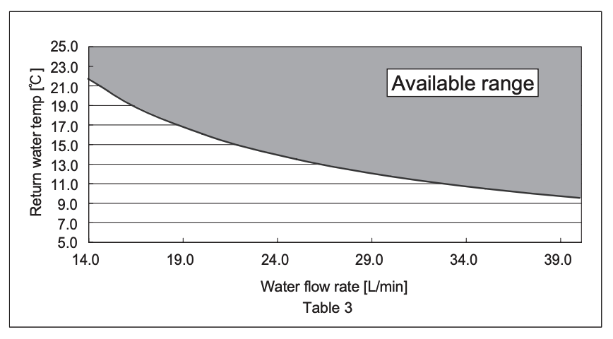

This is the installation manual for the hot water cylinder; not the hat pump. A quick Google for PUHZ-HW140 confirms your flowrate requirements though. Flowrate and return temperature needs to be in the range below in order for the unit to operate. If the flowrate through your secondary system (the rads / UFH) and through the 4-pipe low loss header is HIGHER than the flowrate from the heat pump through the 4-pipe low loss header then you're going to have temperature dilution issues. I would set UFH flowrate to 18l/min, DHW flowrate to 18 l/min, and radiator flowrate to 22l/mum (max, with all TRVs full open) And the heat pump flowrate to the maximum. Now you can run: - DHW only - UFH only - UFH and DHW - UFH and any amount of radiator up to 100% open I would set UFH to 18l/min, DHW to 18 l/min, and radiators to 22l/mum (max, with all TRVs full open) Now you can run: - DHW only - UFH only - UFH and DHW - UFH and any amount of radiator up to 100% open That will resolve your dilution issue. I would also fit a buffer (a volumiser if you prefer) on the heat pump side of the space heating circuit (flow or return; return probably better) to reduce cycling when the load being drawn off is lower than the heat pump is able to modulate to. 50-100 litres. A small direct unvented hot water cylinder will work. I would also eliminate the 4-pipe header and drive everything directly form the heat pump; using zone valves for the different circuits instead of using pumps. And that's your priority order for biggest bang per buck.
