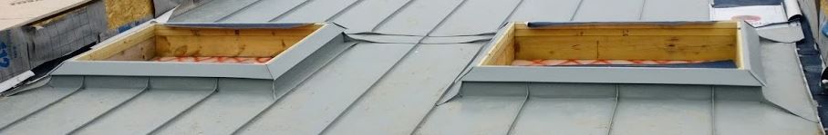

  11. What material you going with? I understand that with steel, another more ductile material needs to be introduced for the flashings, which then does not give the traditional appearance. I've gone with Aluminium in the end (was initially going with Colourcoat Urban), and here's mine (in progress): My details a little more complex than it needs to be, with the extra 45 degree chamfer profile on top. I lined the outside of the up stand with celotex, but this was too wide for the roof light mount, so needed the 45 degree angle to bring the width back down to the width required by the mount.

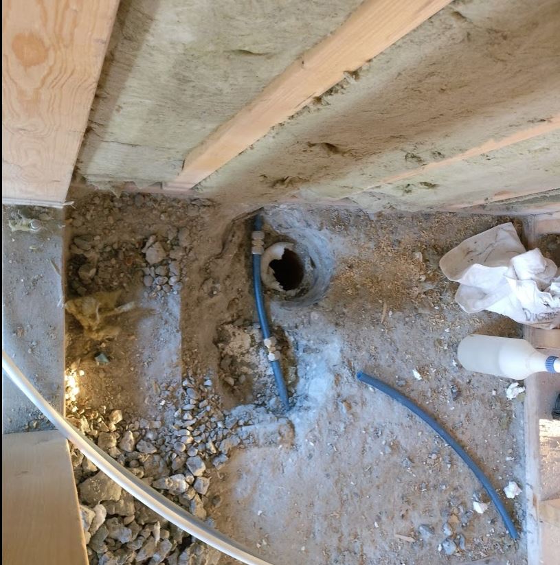

  17. I thought I knew where all my pipes were...apparently I'm not able to keep track of 2.5km of pipe: I'm sure it wasn't laid that close to a shower drain, but that's where it ended up. In truth it was an easy fix...but your heart sinks when you notice the manifold pressure has dropped to zero.
