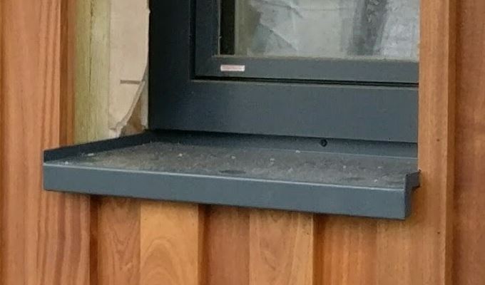

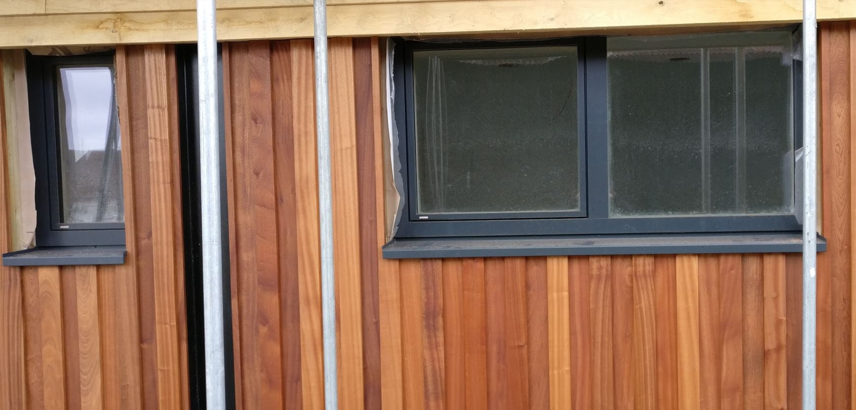

My Cills are 260mm deep. The outer face of the windows are 75mm back from the TF Structure, outside of which I have a 94mm vent gap plus 38mm cladding. This is for Internorm windows where the Cill attaches to a Cill spacer under the frame which is at least 10mm (maybe 15mm) under-flush to the front face of the windows. The Cills have a drip feature on the outer edge where there is a return flange back underneath the outer edge of the Cill making the edge of the Cill at least 10mm thick, and there is at least 10mm clearance between the back edge of this return and the outer surface of my cladding. Edited to add: [Cladding not yet complete into reveal] For Full height windows and doors, on ours the Cills are narrower since there is no cladding and vent gap, just plinth wall below DPC. Wouldn't that be the same for you?
