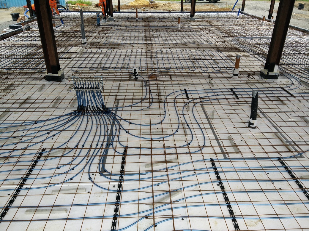

  3. For mine, which has been installed, but not commissioned (I'm just up to floor level), the calculated 6* layout was 300mm centres within a 100mm thick slab. I went with 200 centers for better cooling performance, if it is needed. Thickness of slab at the footing shouldn't affect heat loss assuming EPS thickness is maintained, however the retaining wall may as it is extra connected area that is unheated. This will need to be taken into account for your heat loss calcs so may require closer pipe spacing in the floor to make allowance. My pipe is clipped to the EPS, with mesh over, and I do have a pipe run running under a load bearing wall. For me I was told I only need sleaving if there's a joint in the slab, which I haven't got. Here's my a link to a thread showing my floor:

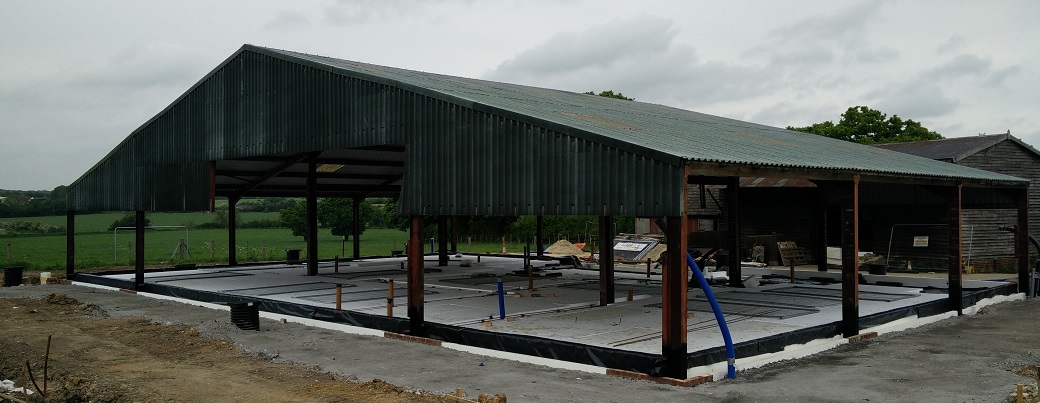

  8. @Calvinmiddle I had seen the Glastonbury holiday home previously, and like what they have done. I looked at all options and have a very conservative LPA that insisted on maintaining the shape and form of the agricultural building. The banner image on my profile shows a rendering of what we have Approved. There will be a new timber frame warm roof under the existing. And then I'll ply deck the existing and put on a standing seam rainscreen. @DeeJunFan Thanks, We're very lucky with the site, especially as it was already part of the family Farm. @PeterW Yep, UFH clipped to the EPS and A193 mesh laid over the top. I felt there was less chance of any damage to the UFH pipe. Floor is 300mm EPS - 0.1 U Value Walls are 300mm blown cellulose fibre - 0.12 U Value. Roof is 350mm blown cellulose fibre - 0.11 U Value. Structure is cold-bridge free.

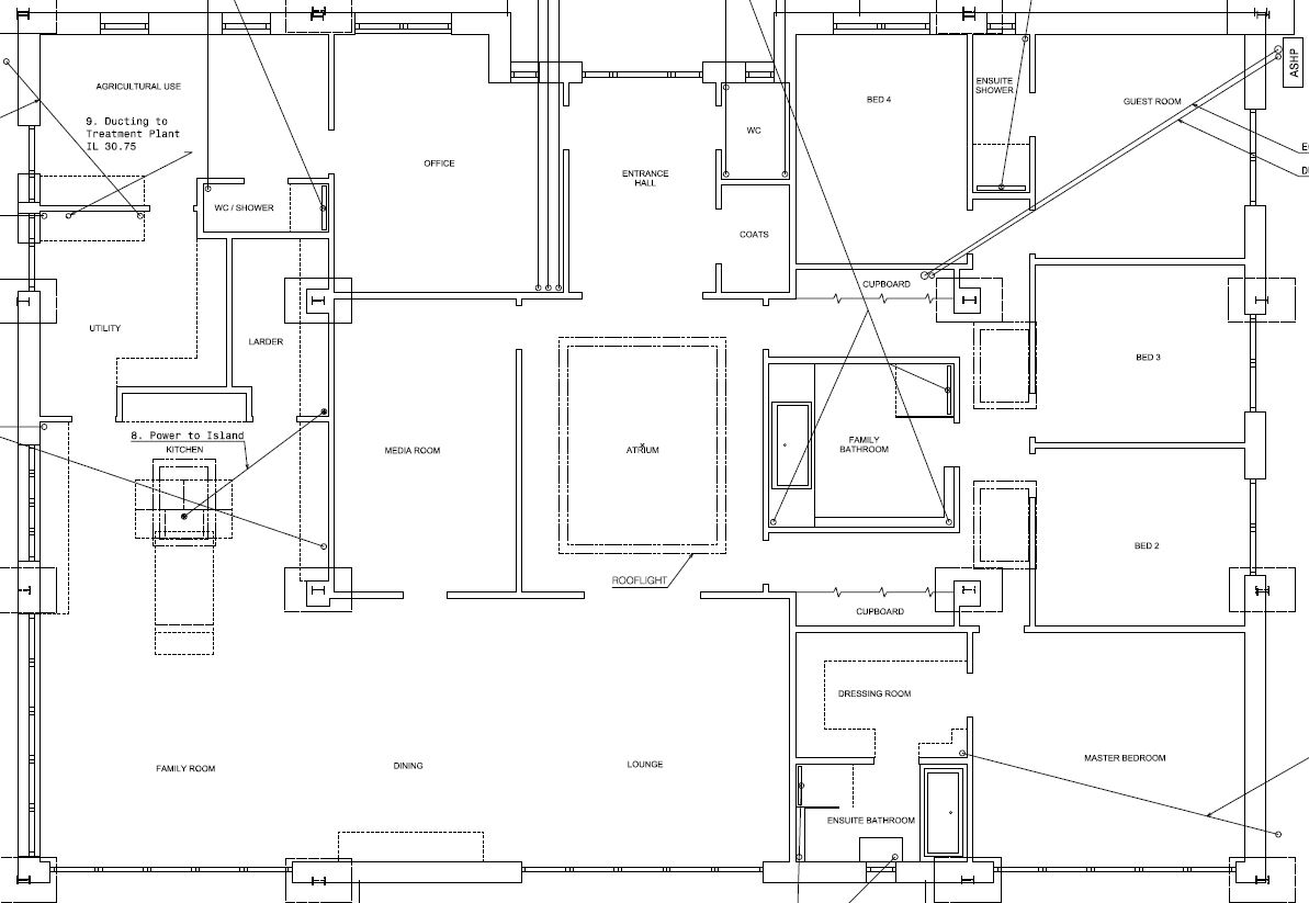

  9. Thanks @Redoctober , The structure is a portal-framed, ex-cowshed, I've grown to appreciate it... Here's a snapshot of the planned interior layout. Planning restrictions mean we'll be on a single level, although will have ceilings in some rooms with "Service Area" above.

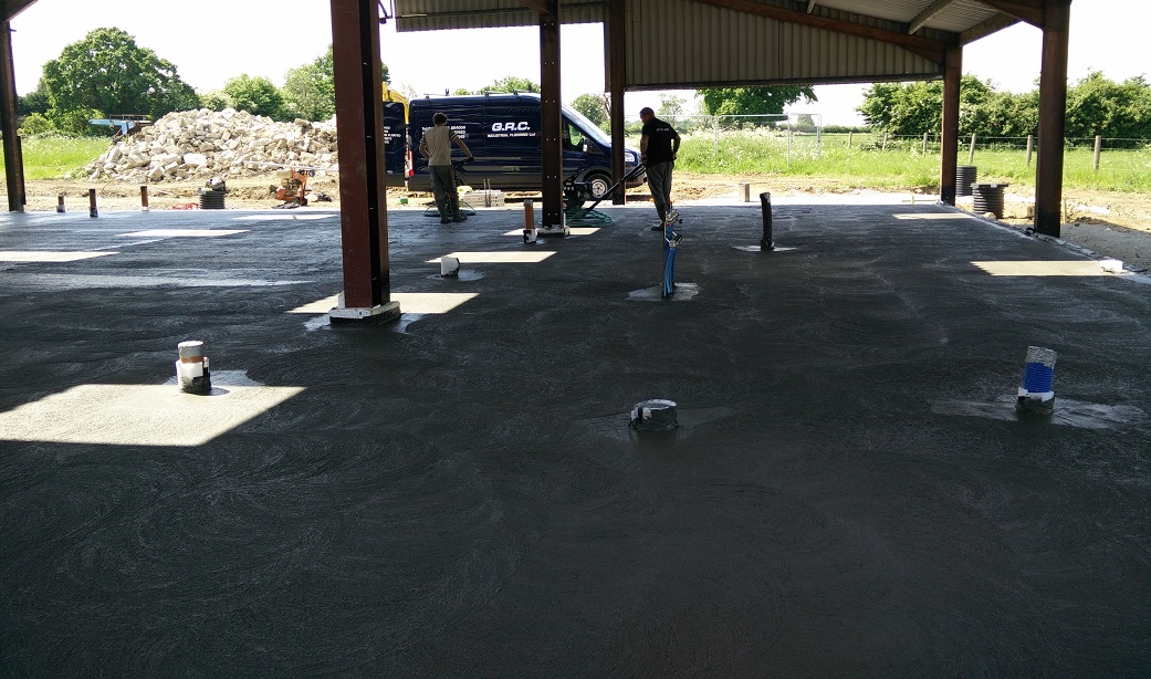

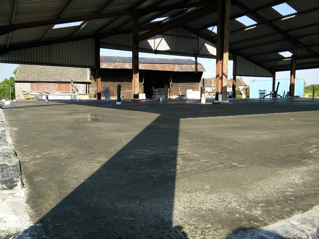

  10. Found another image on the camera showing the finish of the floor, while the power-floating was being finished.

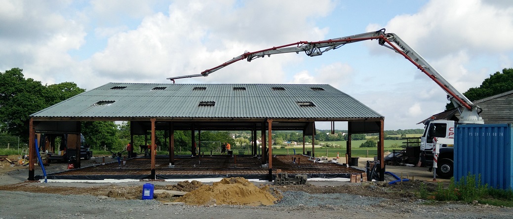

  11. In my introduction I said I looked forward to sharing the highs and lows - well this week has been one full of highs! Monday it was finishing the EPS: Tuesday it was installing the UFH: Wednesday was finishing the steels: Thursday (today) was a BIG day - Concreting Day. First load in by 08:30 Power-floating starting at 11:00 while the last few loads are going in All finished and perfectly smooth by 17:00 I can't imagine there will be many weeks like this one.
  12. We've just this morning finished laying a similar area of UFH. Used over 2km pipe (at 200mm centres) on 2 manifolds with 22 loops. With nearly all the hardware there to run as multi-zone, apart from some extra thermistors, we've decided to split it into 10 or 12 zones to see if we can keep the bedrooms a little cooler and bathrooms a little warmer. Like others are suggesting, it would be very easy to make it appear multi-zone if your BC officer was sensitive to this aspect.
