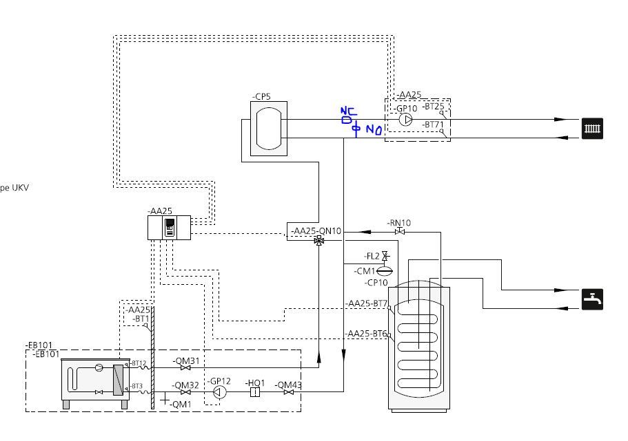

  9. I'm going with an off-the-shelf solution from Nibe, which does cool the buffer. I'm having a 200ltr buffer which will hold about one third of the fluid in my system, requiring additional energy to cool initially. After that it's just the energy losses (heat gain from environment) of the buffer that would drop the efficiency I would have thought. But, it may help reduce short cycling when cooling requirements are low. If it proves to not require the buffer for cooling then I may look to re-plumb and bypass the buffer in cooling mode.
