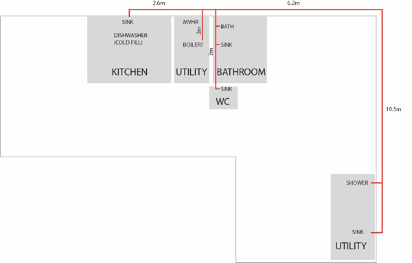

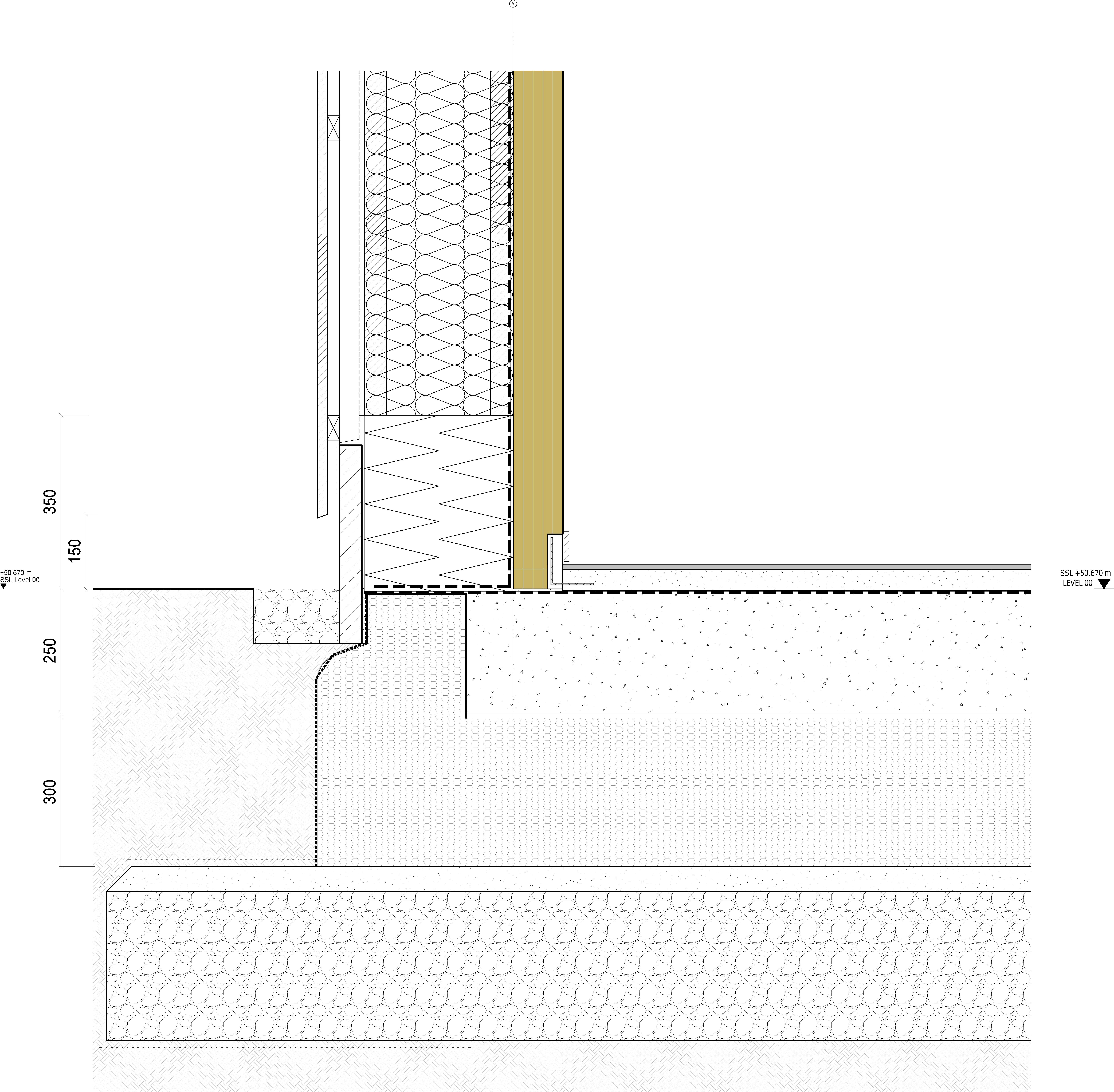

  6. ProDave, thanks for the point on services. I should have been clearer - we went to see a similar CLT passivhaus in Hackney whilst we still lived nearby and decided that galv conduit surface mounted on the walls is not the end of the world as long as we locate it carefully. Our layout (below) means we generally have a 'servant space' (utility, ensuite etc.) adjacent to a furniture wall in a living space (bedrooms etc.) so I'm not that worried about locating drops etc. at this stage JSH, thanks for the pointers on vapour movement etc. I think our insulation envelope is fairly consistent around the building, although I'm struggling slightly with the base of the Larsen trusses and whether they can just sit on rigid insulation as the detail below. I have been assuming XPS here due to the higher risk of saturation at this level but this doesn't really sit well with your point about condensing outwards etc. Self-adhesive DPM on the outer face of the CLT should keep this dry and separated from any external water (plus it forms a backup airtightness layer at junctions. jack, thanks for the weekend viewing. No intention of going it alone on our build - professionals with a mobile crane all the way! They have attended site already and we've agreed a construction plan for this phase.
  7. Hello folks, So many replies already! CLT choice was a mixture of personal preference (aesthetic/reduced maintenance appeal of exposed inner surfaces) and the more practical robustness and airtightness qualities of the solid material. I subsequently found that our soil conditions and the isoquick raft approach meant that we would likely require a lightweight building anyway. Throw in some access issues (TPO'd trees, shared driveway) and the idea of offsite prefabrication was also appealing... ProDave we have enough built-in storage ideas that I'm not too worried about hiding service distribution and we're even open to the idea of exposed galv conduit & MVHR ducts if we have to, although I may end up putting a ceiling in just to reduce the amount of exposed timber surfaces! IanR, jack is correct, the CLT is the inner skin (equivalent of a v. thick OSB sheathing board). The Larsens (or likely Steico I-Joists) then just act as non-structural spacers to hold the cladding out far enough (450mm!) to allow cladding the CLT in dense rockwool. I've got some detailing challenges around the base of the trusses (to stop them wicking water) and I remain a little worried about freeze/thaw cycles on the outer chord since this is effectively uninsulated and exposed to moisture variation. Hoping to model this in Psi-Therm/WUFI to see if it's a serious issue but I don't know either package so will be feeling my way a bit... So far no-one appears to sell tannalised I-joist equivalents of tile battens. Nickfromwales, I have a very scruffy hand drawn plumbing schematic which I hope to CAD up soon and share. In the meantime I've attached an older diagram that explains the basics. Essentially the bungalow format means all water distribution is on the ground floor and horizontal pipe length is the biggest issue. Originally I was looking at doing all this from a central point in the Utility room (as per the diagram) but realised it would probably be much better to just split the SunAmps and have the secondary one standalone in the en-suite. Alphonsox, thank you for the suggestion of modelling the SAPV's as an instantaneous heater. This is what I've done so far, but it ignores the issue of PV generation to supplement the electricity use. As such, the carbon factor of the heater is fairly detrimental from a PHPP aspect (i.e. it assumes all grid provided) and probably worse than it would be in reality. Thanks for all the responses so far.

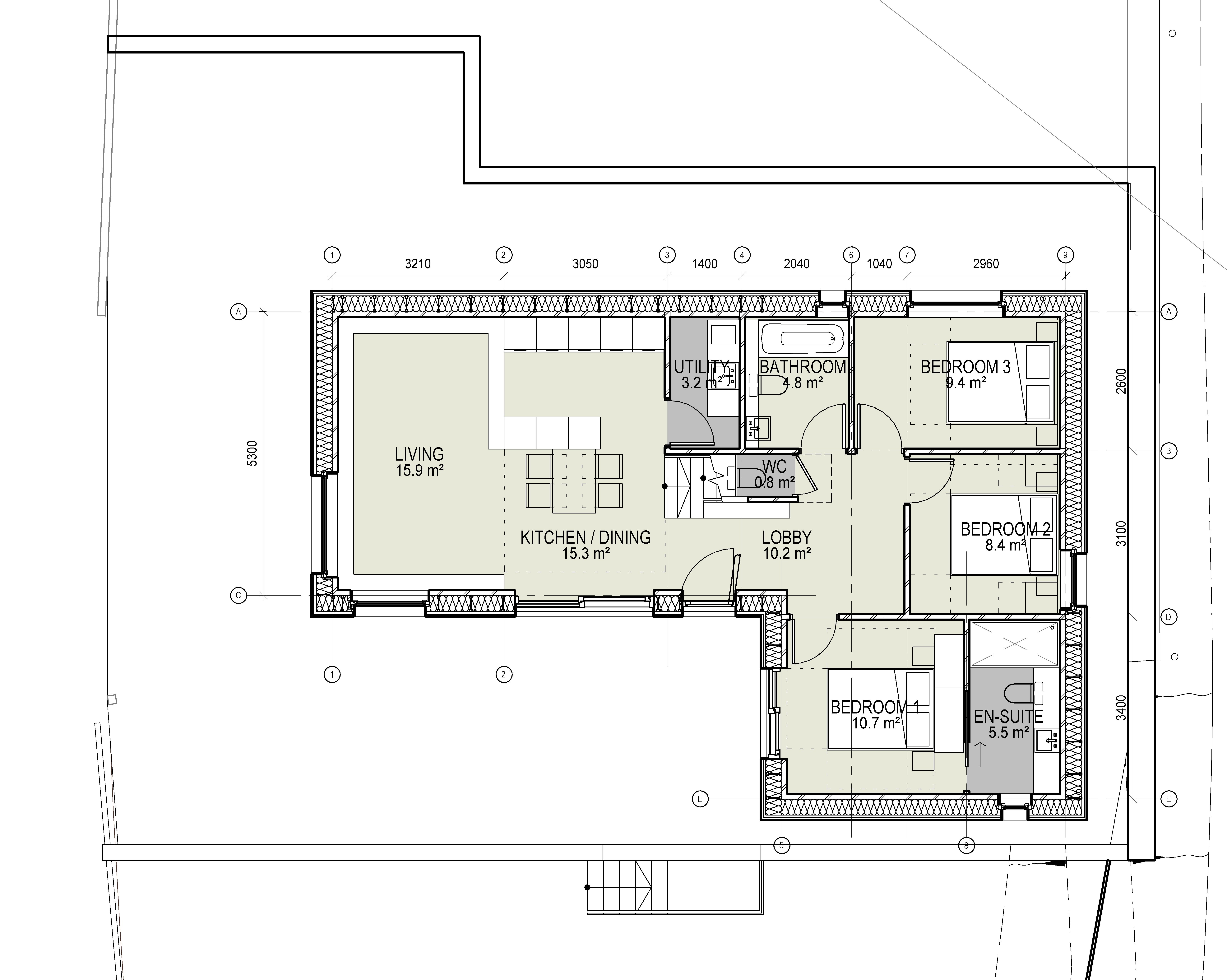

  8. Hello all, I've been over on the forum (GBF) for some years now and thought it was now time to join this one too as we have a self build about to go live. In brief it's a new-build bungalow (with mezzanine) on a rural site near Bath. Plot bought with full planning permission which I amended to get elevations more favourable to PHPP. Aiming for Passivhaus standards despite a tricky form heat loss factor (4.2) due to the aforementioned planning consent (pitched roof, L-shaped plan). So U-values of 0.07 to walls and roof, 0.08 to slab. Construction is CLT frame on isoquick raft, rockwool insulation (vermin and arson concerns) between Larsen trusses, with timber rainscreen to walls and slates to roof. All electric too as no gas nearby - I'm intending to use electric towel rails to provide space heating and two separate SunAmp units to provide localised DHW. I'll start a separate topic on this, but if anyone has any tips on how to model the SunAmps in PHPP I'd be really grateful! Thanks in advance, T
