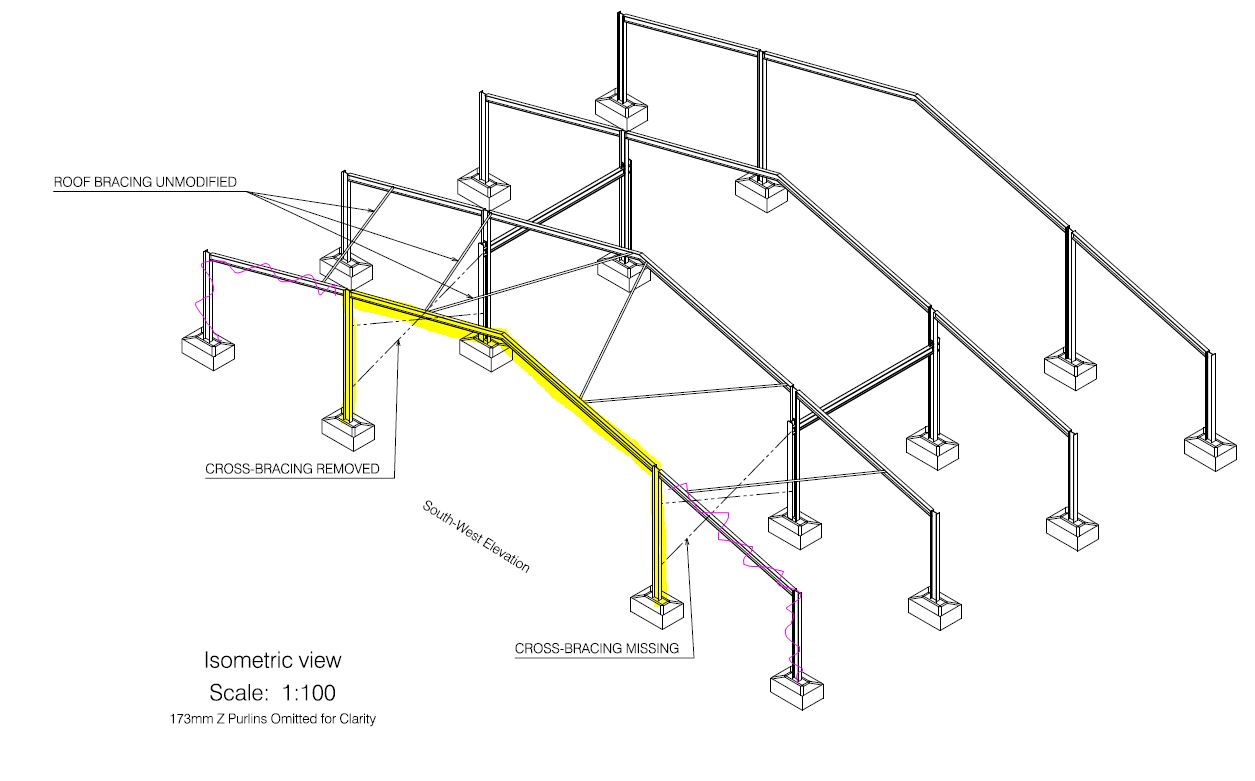

Cheap, Thermally Efficient Non-Structural Wall Detail
IanR replied to Nick's topic in General Construction Issues
A 12m span is easily achievable in the typical steel sizing used for Agricultural barns, without stepping up to the monsters used these days in warehouses and distribution centres. The sketch below was for the structural changes I made to the primary frame of my barn. The high lighted yellow portion is the main barn span and is what your are describing and the areas crossed out on the first portal are lean-to bays that are add-ons. The distance between the two high-lighted vertical columns is 45 feet (13.7m). The width of each bay 19'6" (6m). Ridge height around 6.5m. Columns are 10" x 5.75" and the roof portals are 8" x 5.25". Not shown are the 173mm Z Purlins and 9" x 3" Eaves Beam timbers similar to what you describe. Typically the first bay is braced as shown and the follow on bays lean against the braced one. I removed the low level cross-bracing (simple 2" tube) as it got in the way of an open area I wanted and had to replace it with the giant goal-post arrangement you can see between the internal columns of the centre bay. As I said previously, the portal frame structure is designed for a light-weight roof, ie. profiled sheet steel, corrugated cement board or insulated profiled panels. I'm not sure it will hold up the weight of structure required for a domestic warm roof that you'll be after in your double volume area. I'm not sure how much this image shows: The steels are half in - half out the external wall. The sheathing on the timber structure actually notches around the steels so the wall narrows across the width of the steel. And then when the cladding does its bit, the lower portion of the steels are visible and the upper covered, as per planning requirement. I know I sound like a broken record, but in your shoes I'd do it with a large glulam ridge beam and I-Joist roof structure. I'd hate to add up what it's cost me to integrate the steel frame. But I had no choice, my planning is for a conversion, not a new build. -
Ah, this is two storeys Are you expecting a completely open ground floor, with no internal columns? You'll need a Structural Engineer to work out the most economic way of achieving that if you do. If I've understood your orientation correctly I see you needing an 8m steel at first floor (running parallel with the ridge) that will require structural gable end walls for it to sit on. Maybe you need to work up a section. While you are thinking your timber walls will take the wind loading, where are they transmitting those loads to. Do you plan to structurally tie them into the steel frame at the eaves and first floor? Personally I'd start by trying to do it in timber, with steels to reinforce if a timber member gets too big. Having had to work around a steel portal frame I'd certainly try and avoid it in the future. Ridge height is very difficult to control across each of the portals. The wider the span and shallower the pitch the height variance is increasingly sensitive to the length tolerance of the beams and weight on the roof. I assume you'll need 3 portal frames to make up 2 x 5m bays, there's a risk of the ridge not being visibly straight. This goes unnoticed on agricultural buildings, but probably not on a house. Portal frames are also designed for a light-weight roof covering, what did you have in mind? For mine the steels are outside of the thermal envelope. Due to a planning caveat they have to be externally visible in some areas, so also outside the cladding, but covered in others, so behind the cladding. [But: I do have 4 steel columns that are internal to my floor plan, helping hold up the roof, but due to how they are boxed and insulated they technically remains outside the thermal and airtight envelopes] When I mentioned the DHF board that was for the structural timber frame scenario and no steel portal frame. I found it was relatively easy to develop a hybrid (timber and steel) structure where timber walls, inline with and attached to the steel columns, where capable of supplying the racking support to the portal frame and the portal frame capable of dissipating the wind loads on the timber walls. But, if you've got that amount of structural connection between the two how do you then thermally isolate them and stop vapour getting to the steels, unless you can wrap the whole structure with external insulation, leaving just the floor connections to resolve. -

Just taking a step back... The title of this thread is "Cheap, Thermally Efficient Non-Structural Wall Detail", however what you are developing here is a structural wall. Have you talked yourself out of the steel portal frame à la "BarnHaus"? or is this still your current direction. If you are still considering the steel portal frame then you could consider a less structural options than the I-Joists to make of the external walls. At the moment there is a double-count in your strategy ie. both the steel columns (suitably braced) of your portal frame and your I-Joists of your wall detail are independently capable of holding up the roof. My current build is a conversion of a steel portal framed cow-shed and in the early days I enlisted some help from Dr. Ed Green to develop early concepts on integrating the portal frame, due to his involvement with Barnhaus. I wasn't interested in the straw bale insulation, so we looked at several other options. and always the plan was to keep the steel outside the thermal envelope and ensure no warm moisture could get to it. Integrating the steel structure into the timber frame structure adds an extra layer of difficulty. The portals of the the steel frame will require racking bracing at wall level (as well as the roof) and as you have drawn it the racking braces will run through the I-Joists. It would be much easier if the steel columns were external to the wall, but this looses you some floor space you are trying to retain. Mine are half in, half out - a compromise that adds complexity. Your choice of steel portal frame is due to room size. What's the roof, ie. pitched of flat, and what way does it run. It's quite possible you could do this with Glulam and I-Joist to avoid the Steel Portal frame, and simplify your structure. With regards to your I-Joist wall detail, and to play devil's advocate, if cost and wall thickness are critical then there's no need for a service void if you are only running suitably sized cables in the external walls. But you shouldn't run plumbing. Also, your VCL could be achieved with a foil-backed plasterboard if your wall build up is so designed. Also, your outer sheathing could be both racking support and the airtight layer with something like Egger DHF board, avoiding the need for any airtight or VCL membrane. Designed right, its a cost effective solution. -
