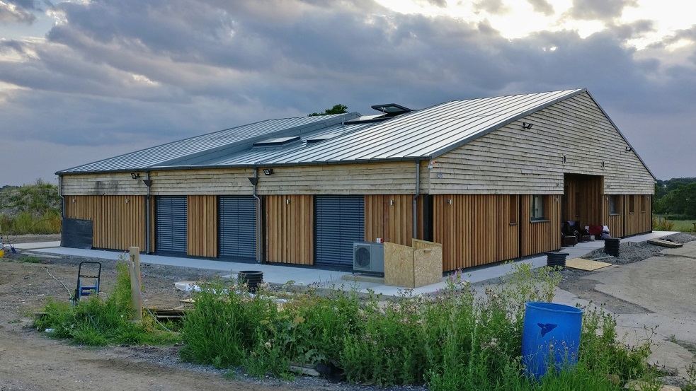

The issue is that there is nothing monitoring the ASHP environment, unlike the inside of the house, rather than the risk level. It's a much lower risk, but if there was a fire you may not know about it until your internal fire alarms alerted you, by which time the fire has penetrated the fabric of the building.
Could that have a chilling effect on your external wall? The expelled air will be below outside air temp. I still have my ducts open to the ASHP position and am just considering whether to run another cable to some sort of sensor/fire alarm, but not sure what would be best.
The Grenfell Tower thread got me thinking about potential fire hazards around the exterior of my house. I have timber cladding with a vent gap over a timber structure, similar to many on this forum and was quite happy about the fire resistance of the structure from an internal fire, and the protection offered from internal fire alarms. I'd never considered a fire starting on the outside of the property. The only item close to the facade of our house, that could potentially cause a fire, is an ASHP, placed 500mm from the external wall. A quick Google search for "heat pump fire" brought up more incidence than I expected, although it is a little dominated by current Carrier/Bryant recall. My assumption is that it is a low risk, however if an external fire did take hold It could be well established before the house occupants became aware of it. What's the consensus? Does the risk need mitigating, and if so by what actions?
