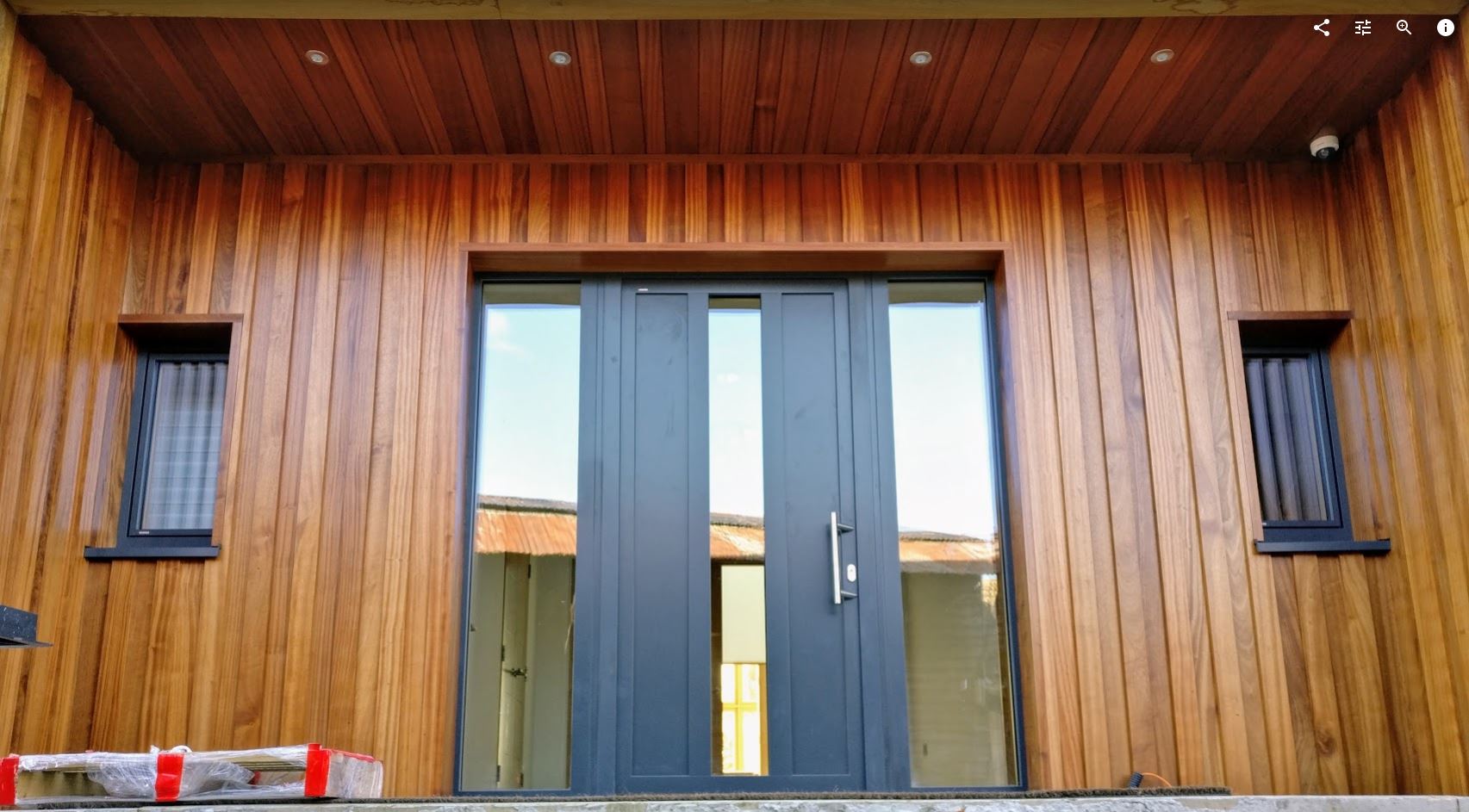

I appreciate Sapele is too dark for what you are after, but I did say I'd get a picture of the porch ceiling. This is also a better representation of the actual colour. The ceiling is done with alternate narrow (94mm) and wide (144mm) boards, bevel edged and butt-jointed. The wall cladding is the same boards but board-on-board. It was the spark's idea to recess the spots into the board, which isn't really noticeable in the pic but is a really nice effect.
We were after a consistent redish-brown to part of our cladding (incl. porch ceiling) and initially thought we'd be going with cedar but were disappointed with the inconsistency of samples where pinks and yellows would be mixed in with the brown we'd expected. In the end we went with Sapele (PAR) and three coats of clear UV resistant Osmo. It's a lovely deep brown, looks like a piece of fine furniture. If there's enough light in the morning when I leave I'll try to get a picture of the porch to post. In the mean time, not the best picture to show the colour, but to give a flavour. Sapele is obviously the lower half, and only one coat of Osmo at this point:
