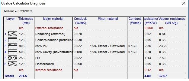

  12. here is my version of your wall, U=0.23, if I remove the 15% timber fractions the U value falls to 0.18
