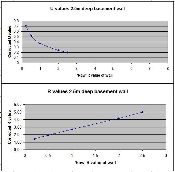

@Thorfun , as it says in the document - I have given it a go - I should add that I never had to do a basement when I was actively doing SAP! If we look at the table we can see that the change in U-values is rapidly declining with depth, particularly at higher R values, therefore I think you can ignore not having values for your depth and use those for 2.5m The first plot shows the U values in the 2.5m column plotted against 'raw' R values in the 1st column. I think it would be difficult to give an accurate U value for a 'raw' R value of 7 from this In the second plot I have calculated R values from the U values in the 2.5m column and plotted these against the 'raw' R values in the first column. Assuming this is a straight line (y=mx + c) then a 'raw' R of seven converts to about 11.61 or a corrected U value of about 0.09
@Thorfun , Here is a slightly out=of-date document which describes the methods for calculation of U-values for below ground walls and floors. Replace the Building Regs U-values and ignore the references to Elemental and Carbon Index methods Basement U-values.pdf
