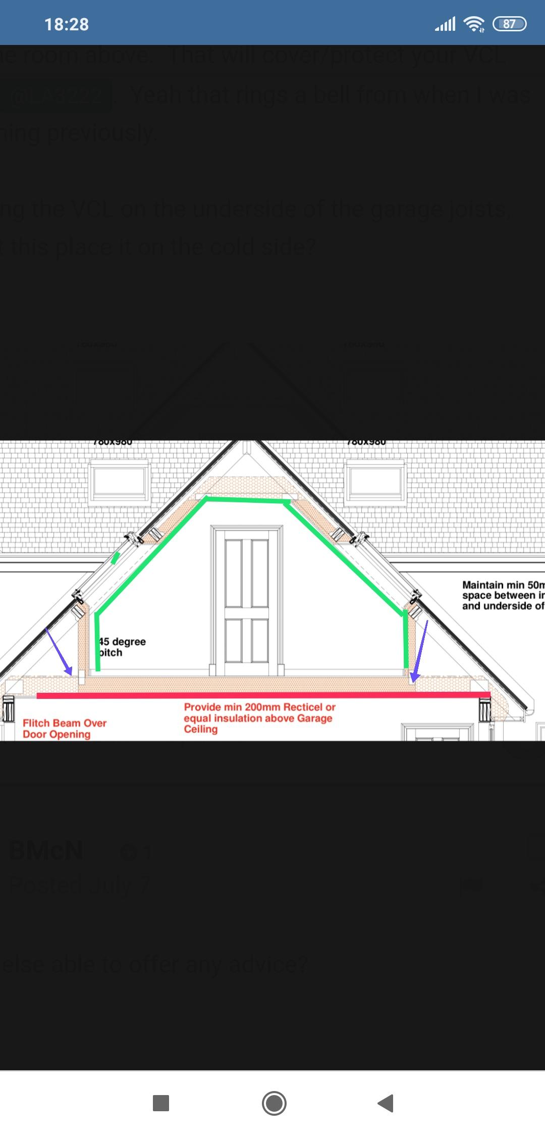

Treat it like two separate envelopes. The issue will be how you deal with the areas with the purple arrows. For attic truss I cut small squares of pir insulation then foamed them in place However when you have services going in and out of the joists then it's very tricky so I used pir and cut out holes where electric cables or plumbing pipes where then taped round them onto the insulation to get it sealed up. It's not an easy job because of where it is. I had the ceiling below boarded out and first fix all done so I could use the ceiling and flooring to help form the squares with the joists.
