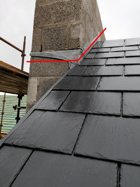

You could mesh and render right over the lead on the face but I wasn't sure how to do the corner where you have that small flap/triangle of lead. With a stop bead that bit of lead comes out from under the bead. If you render down to that triangle of lead and the lead moves I thought the render might crack in that area.
Just a check but... Are there soakers under the lead and slate?
+1 I think in this case you could find a stop bead with a wide mesh (or separate mesh) and fit that lower down so the mesh covers the lead. Would need to use stainless steel screws and SS or lead washers to fix the mesh through the flashing into the brick before rendering. Google found photos of something similar.. https://www.yelp.co.uk/biz_photos/ben-hockey-roofing-chalvington?select=_LLkfuZwwPUKDobw-N4RiQ
