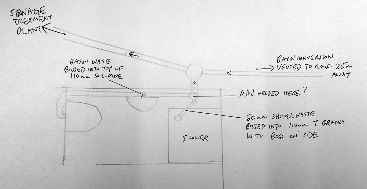

Could I just go for a basin trap with built in AAV as I will have some issues getting an AAV behind the toilet? I think I hadn't quite clicked that an anti syphon trap is essentially an AAV.
I have a small shower room in a small outbuilding/office with waste plumbing as in the drawing. It goes to a sewage treatment plant and this is vented at the end of the run through the roof of a barn conversion about 25m upstream of the shower room/office. In the interest of the toilet not sucking water out of basin/shower traps is my best option: 1. fit anti syphon traps to both shower and basin 2. fit an AAV - if so where should it go? can it go where I indicate on the drawing or should it be closer to the toilet (upstream of the shower and basin) 3. Fit all the above. 4. Don't bother with any of them - it will all be fine!

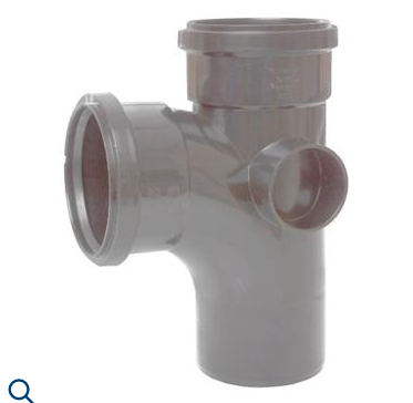

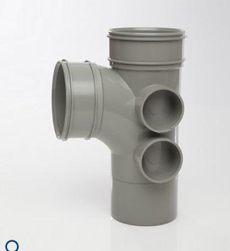

I assumed you can't put a boss on a swept bend and it is mucked in anyway so couldn't get a strap around it if I wanted to. Hence trying to work out the lowest place I can get the shower waste in above the bend.
I don't think I have the height to get the shower to floor level. The bend ifits very closely to the existing pipe/inspection chamber just outside the building so no room to drop in a boss any further down. There is no stack to speak off just the bend into the inspection chamber.
thanks temp - i'll have to have a closer look at the measurements when I get a chance. I had assumed I would need a small step up to the shower which is fine - I just want to keep it to the minimum. When slab and swept bend were put in a while ago the plan didn't include a shower. I appreciate that 50mm of insulation isn't much but it is an insulated limecrete slab already. And yes the swept bend has a female socket in the room so that helps.
I have a toilet and shower in a small downstairs room with a 110mm swept bend finishing 35mm over the top of slab. On top of slab I have 50mm insulation and 25mm tiles. Can I use a 110mm 92.5 single branch 92.5Deg 2 Boss like this with the toilet pipe into 110mm and shower waste into boss at same level? What about using one like this with the shower waste entering below the toilet waste? Is that allowed by building regs or is there too much danger of toilet waste entering the shower waste?
