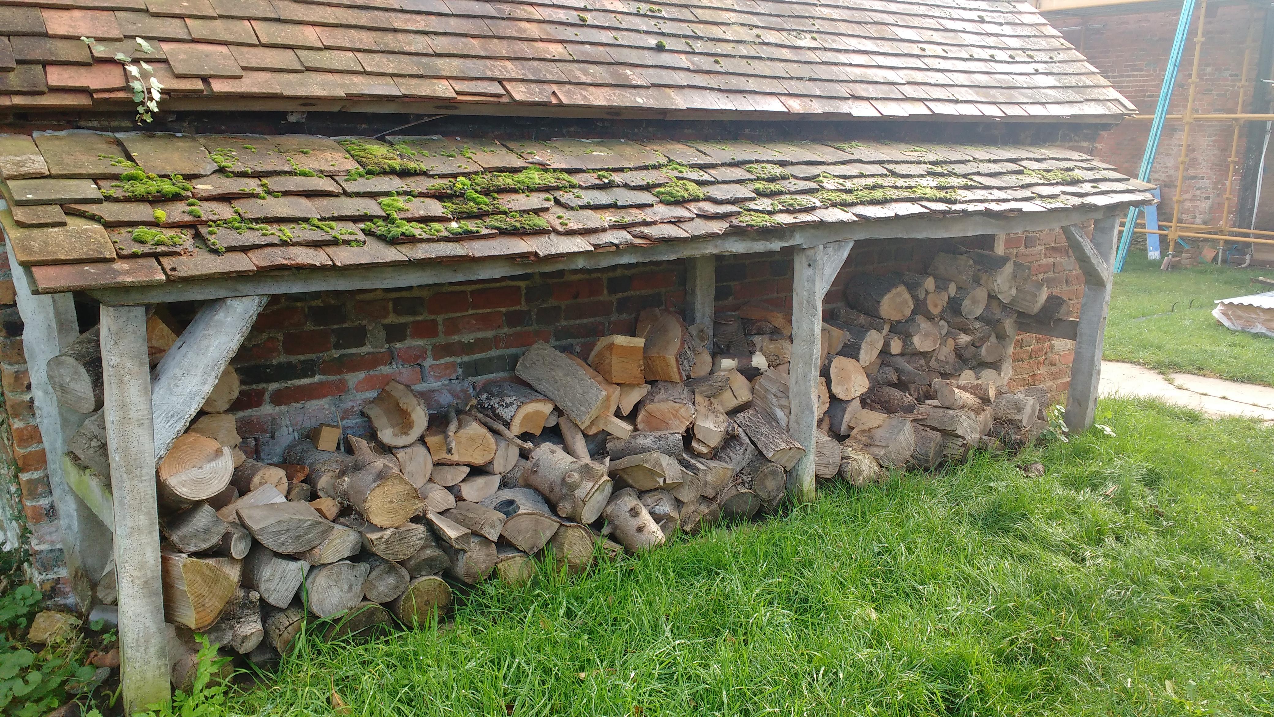

cant beat a good blue one - nice and sturdy, if a bit heavy! i think i might have become a pallet snob
I made mine out of old joists I had pulled out on the house and some left over tiles that didn't quite make the grade for the main roof.
