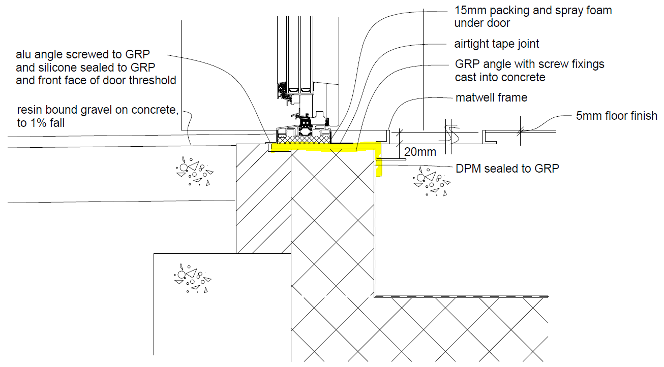

  17. Is it too late to get the Door frame over the EPS upstand, and aligned with the insulation? We used a 9.5mm thick GRP L Section (www.steponsafety.co.uk), sitting on top of the EPS upstand to support the door and window frames. Ours was put in before the slab pour, but they could be fitted after. This threshold is within a covered porch, so we went without the drain, but did tip the outside surface away from the opening by 1°.

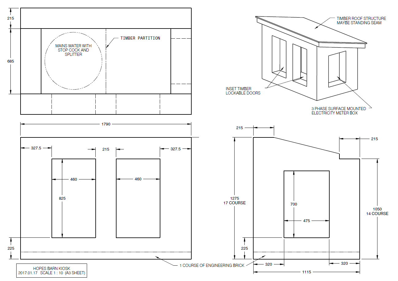

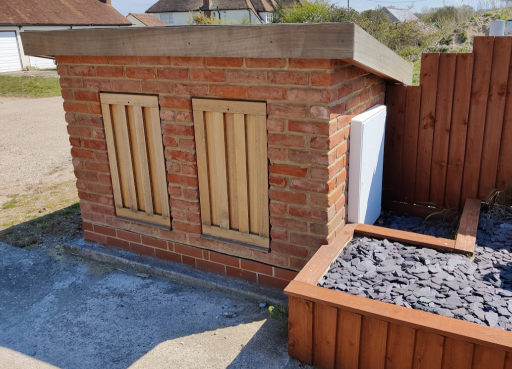

  19. We built a Kiosk for Power, Water and Comms, so is a bit bigger than you require. Similarly, we're around 100m up a track, and having the Kiosk on the edge of the Curtilage, kept us to around about the 100m limit for data and PoE back to the entrance at the start of the Track.
