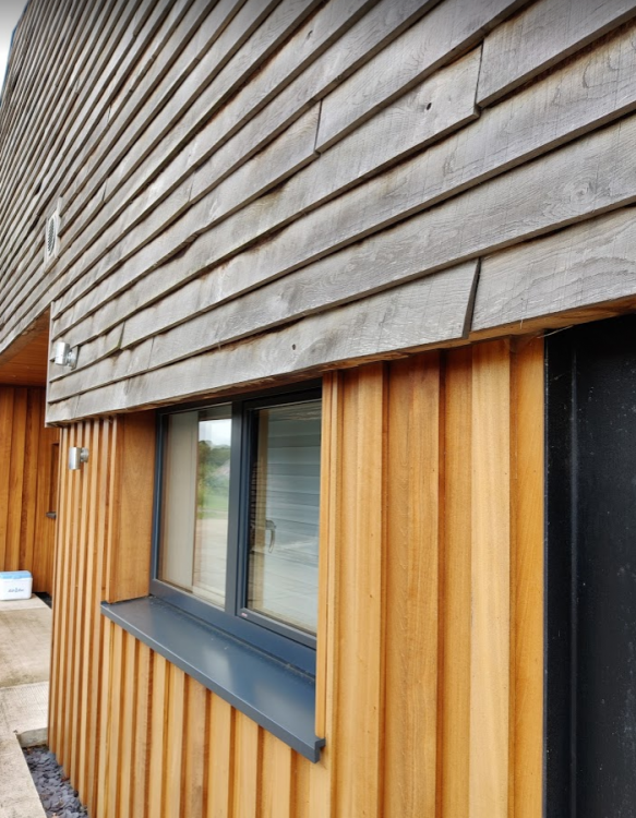

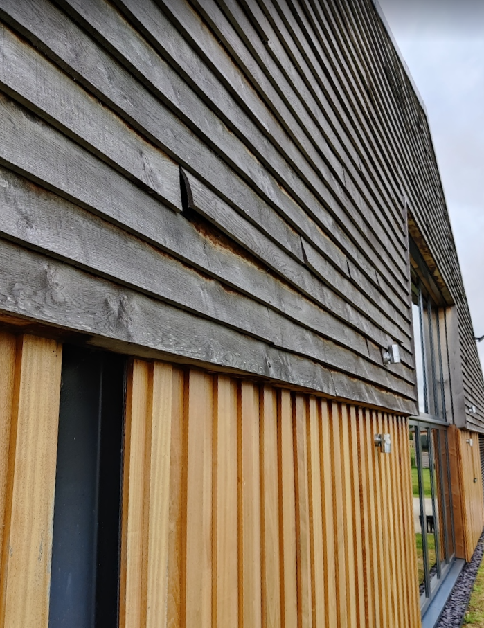

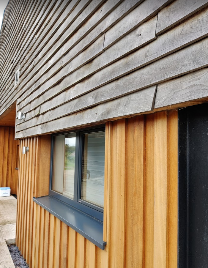

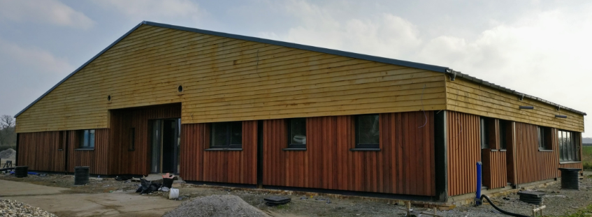

I have fresh sawn European Oak, feather edge, horizontal cladding through the top half of my build. Mines an agricultural conversion and needed to link to an old oak framed adjacent barn. The board size I went with was 17mm to 5mm x 175mm ranging in lengths 2.5 to 3.5mtr My thoughts are that I love the finished look, but if I did it again I'd change what I did a little. 5mm is too thin, there are some splits, and it is in the thin area of the board that the splits occur (around the fixings). I went with around a 30mm - 35mm overlap, which I would increase to 35mm - 40mm. I was persuaded by the very capable chippies to not go with the pre-drill and screw fixing that I had planned, and to go with 1st fix nailing. I'm on the fence whether that was the correct choice. The 1st fix nailing is not strong enough to hold the boards that want to twist, but perhaps screwing would have caused more boards to split as they shrank. All sides of the house eventually silvered evenly, but it did take 3 years or so. The NE & NW facade distorted less and split less, SE & SW have more boards needing some attention. I have probably 4 - 6 boards in 180m² that need replacing, and another 10 that need re-fixing. NE facade SW facade It does take some time for the "fresh" honey colour to start to grey, so you may have to live with a colour clash for a couple of years
