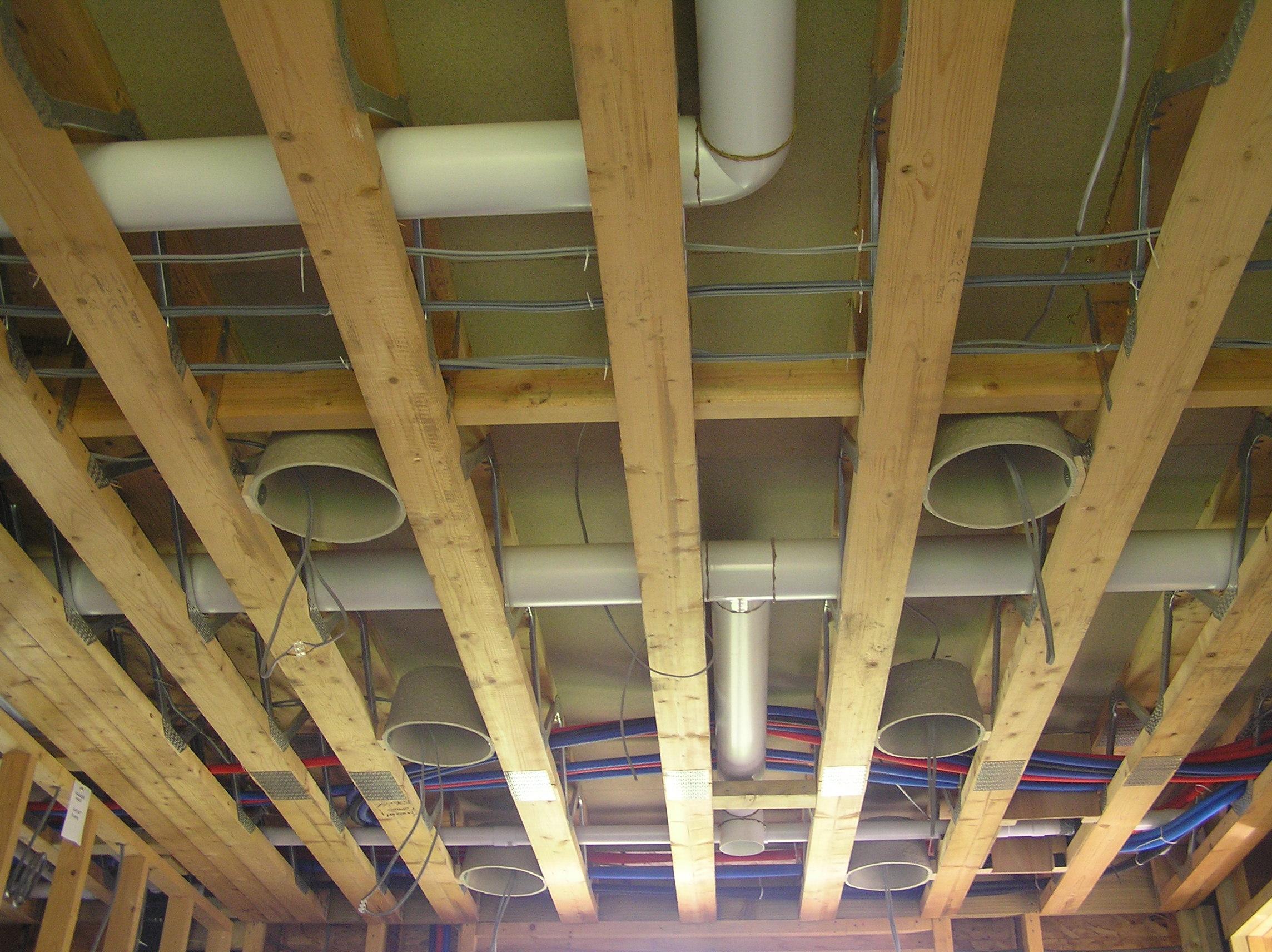

MVHR ducting to outside
Gone West replied to Moira Niedzwiecka's topic in Mechanical Ventilation with Heat Recovery (MVHR)
@Moira Niedzwiecka Hi Moira, the grilles are flat. I cut some cedar battens, I think 20mm square, and made a frame which I attached to the cladding around the duct pipe. I screwed the grille to the frame. The grille, 300mm square, needs to be set away from the end of the duct, 125mm diameter, to allow the airflow into the duct. The total cross sectional area of the holes in the grille must be larger than the cross sectional area of the duct. -
