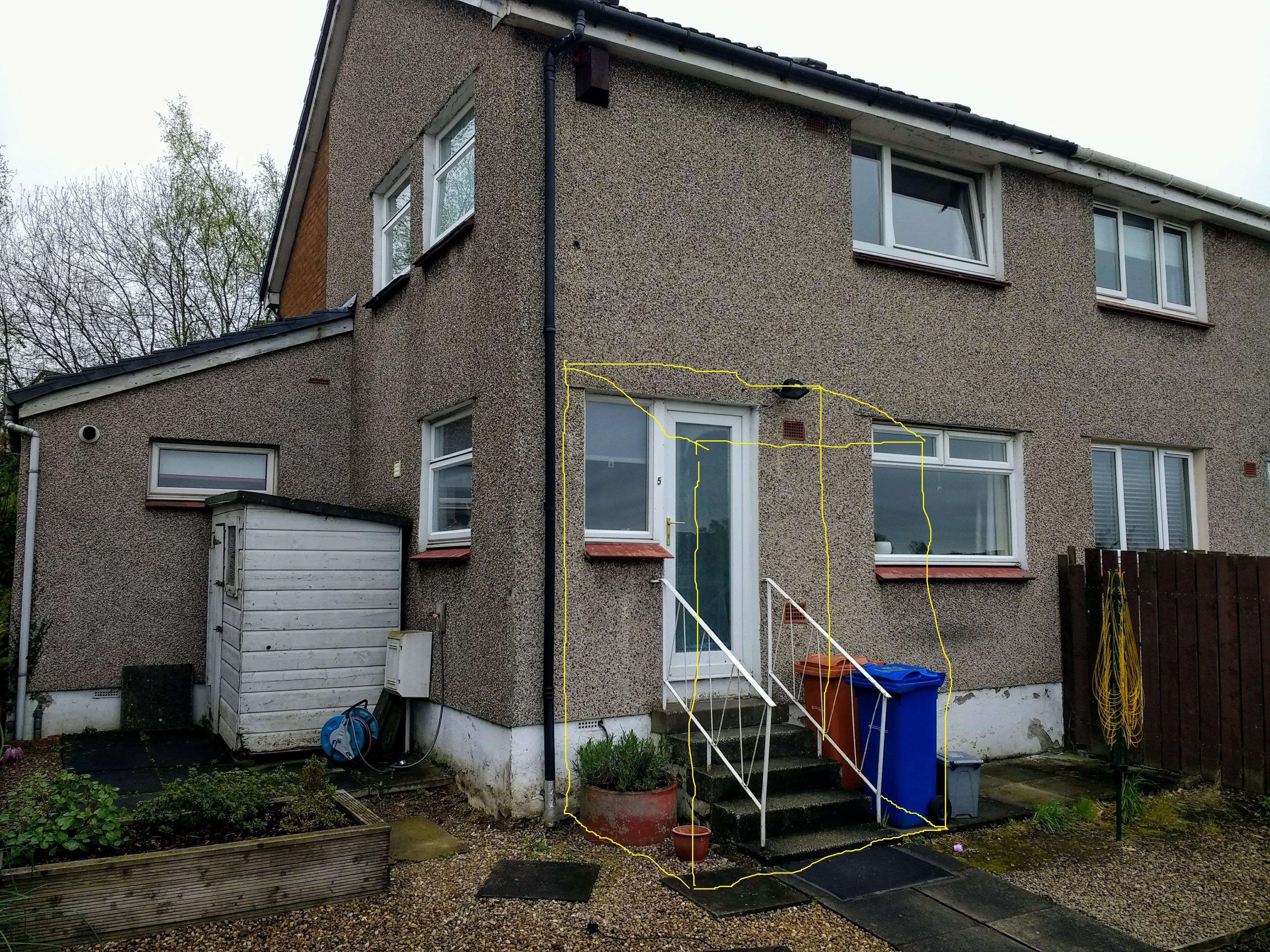

rear porch ideas needed...
Tennentslager replied to Tennentslager's topic in New House & Self Build Design
Ah cheers Mike, Plan is to have it level with present floor, so, new outside steps to the side of the porch. New outside door will open inwards bit existing back door replaced to open outwards -

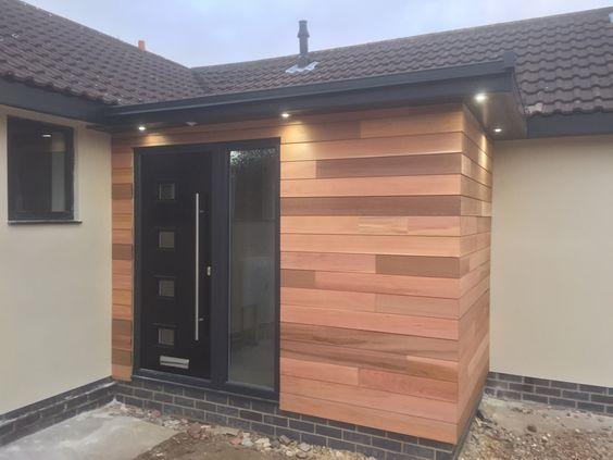

We are knocking out the wall between the kitchen and dining to make one big space but SWMBO wants a porch. Its a good idea as it will stop walking in to the new room directly from outside and i'm sure will be under permitted development. Probably just enough to cover the current outside stairs but what design...? I'm attracted to cedar cladding but maybe just pain old brick. Its more functional than for the look given its a bog standard semi, however as we are on a hill it will be quite noticeable. Ive seen some pics on pintrest but anyone any ideas?
