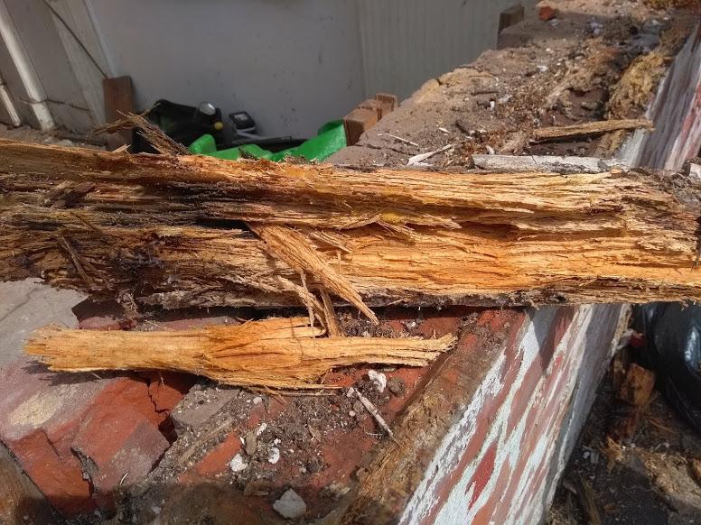

  10. No they were well rotten but according to G "not an issue" ... well they were a bloody issue. Should have seen how easy the lot was to drag down! Got all my money back and an apology. Then he asked if he could carry on and work for me. Anyway, page closed on that one, a room lost but never mind I have an amazing new crew on board now so onwards and upwards.

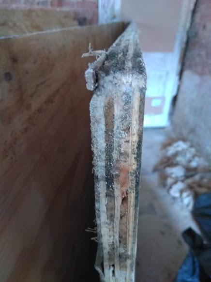

  11. Not at all, his and his sons company deal in BIG developments and are very well known. I asked him to tell me what to do about the structure to get it ready to live in. He said all that was needed was a new roof. I am learning a lot but I am no way experienced enough to know anything about what is and isn't safe. He has visited the site many many times as he was going to do most of the work. I trusted his professional opinion as did my husband. It was only because it looked 'wrong' that I called in someone else (actually two people but one was just for a 3rd opinion) and will now have M do the work. "he probably wanted out by the end of day-2 as the poor condition of the structure was revealed." The room was gutted weeks ago and he has seen it many times. The onus was on HIM to notice the instability of the frame and piers not me. I know nothing! Well I do now. Anyway. I f*cked up. I have learned my lesson and am now paying top dollar for a real professional not some guy that wants an 'easy' weekend project.

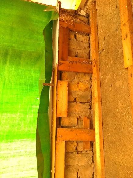

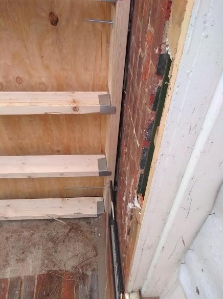

  14. OK so I hired a builder to rip off and replace a flat roof on my conservatory / family room, I'll call him G. I have a new builder M who instantly condemned the whole structure and ripped it all down to rebuild due to it being structurally unsafe. Caused by rotting of the window frames and also where G had reversed a small digger into the building causing all the piers to crack and shift. The extension wasn't actually knitted in to the house (not sure of the correct term?) so that should have been a big sign according to M for G to STOP and not do the flat roof. I won't go into detail of the the rest of his mucking about and failings but will start from day two of his 'effort' on the flat roof. He said he was going home and I went to have a look at his work. The pier next to the house had a huge threaded bolt sticking out of it. I asked why and he said "When I pushed the boarding against the other wall on the roof, that pier pushed out by about a foot, I had to push it back as far as I could get it. It's ok though, that's not going anywhere, I'll cut the end off and it will be fine" He then left shoved a plank of 'summer house' paneling under the wood frame "That'll be safe Yz no worries!" and left the building... and I set to inspecting the rest of his work. Baring in mind he said all he had to do was come back and felt the roof this is what I found. The boarding he used was shutter ply, I had asked him to use OSB. The shutter ply got very wet over the next few days and rotted. He had bent the joist brackets behind the wall fixing plank instead of fixing them to the wall as M has said he should have done. G NAILED the brackets with thhe nails in the photo below. He only put 4 nails in each bracket. There were also 3 threaded bolts going through the wall board into the main house but they were not fixed in and easily pulled out. Anyway, I didn't like any of the work, the fact the pier was held in place by a bolt and the way everything looked wonky, huge gaps over the windows and wrong boarding made me call a new builder. M walked in and the first thing he said was the wooden window frames were rotten and he pulled a chunk out, he said NOTHING should be built on those frames as they will collapse under the weight. M then looked at all three piers and said they were all fractured and pushed to the north. I said G had reversed a mini digger into the south-west pier and he said that is what would have done it and NO WORK should have been done on those piers. He completely ripped apart how G had built the frame too pointing out so many faults it was starting to make me feel sick. He said the nails G had used to hold the joists up on the brackets were for flashing and would not have held the roof up for long at all. Meaning it would have come crashing down on us. The joists were twisted and not level, they were running the wrong way and well... the list goes on. So I sacked G and asked him to return the money I had paid him for materials. G is saying he can't refund me as he did by materials totaling £168 (8 untreated CLS, 2 shheets of shutter ply, 8 joist hangers, a couple of threaded bolts and a handful of nails!!) G also says he needs 2 days labour from the money - £130 a day (he spent 4 hours one day and 5 the next) I have said he can have £130 for labour and £170 for materials and want the rest back. I think I am being more than generous considering EVERYTHING has been demolished and rebuilt from foundations up. Some photos of G's work below.
