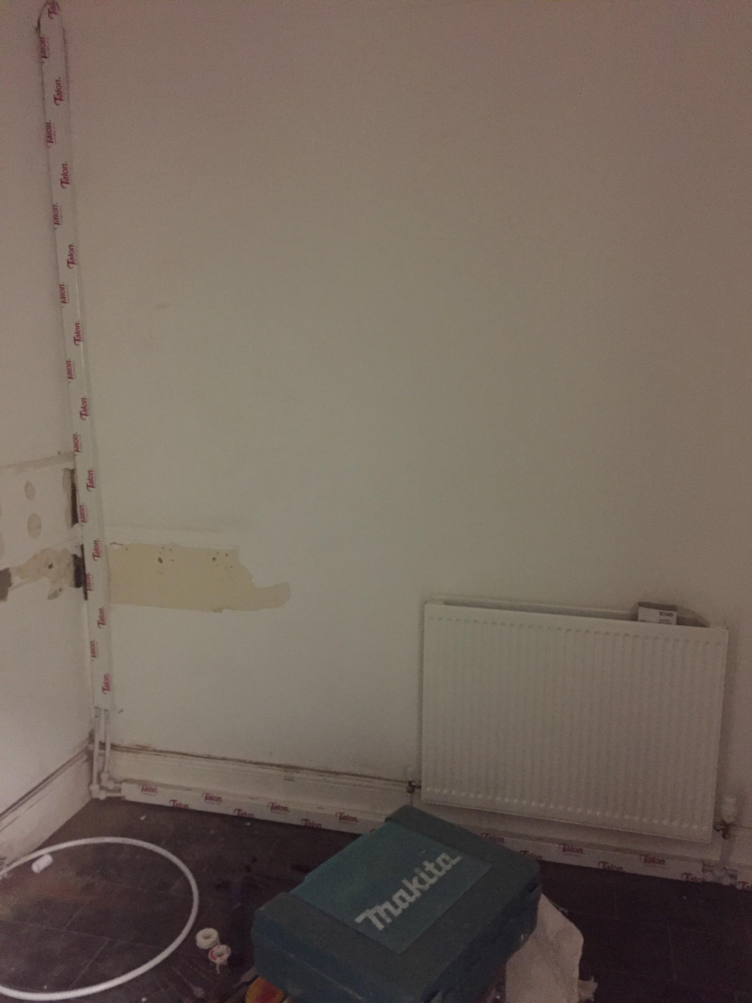

  1. I've now shut off the two rads in the front office that were getting heat and now the left valve on the small rad ( the new one) is getting hot!
  2. I'm here now...new pipe from loft comes down from the ceiling and connects to this small radiators. Then carries on to the room on the right. Here
  3. i'll pop over and take some pics, back in a while

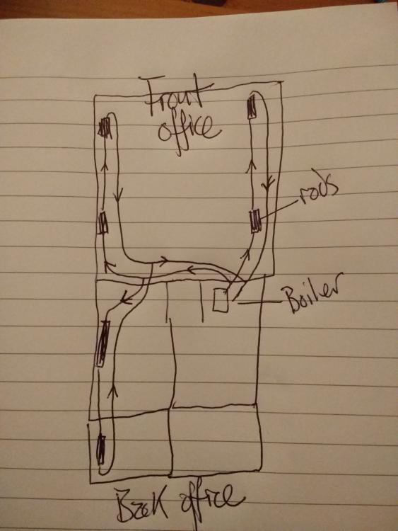

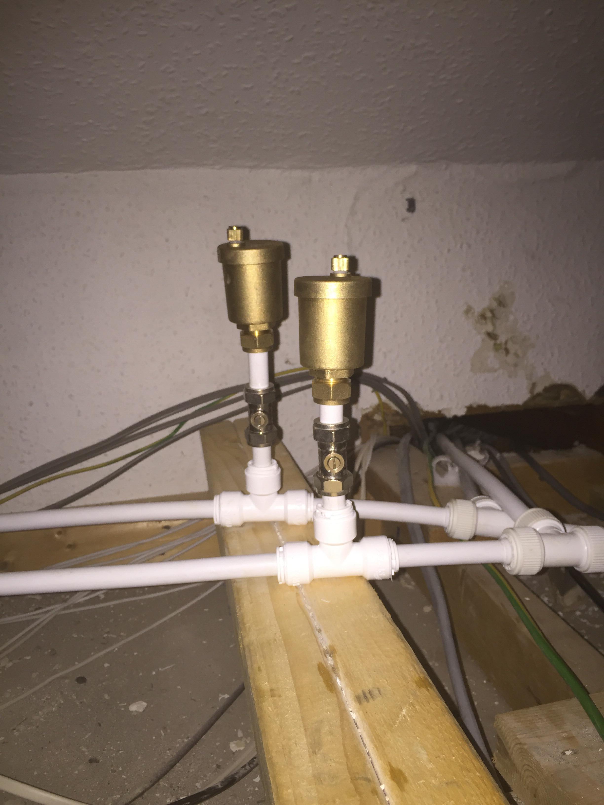

  4. Anyone...? Could the flow and return be mixed (i.e. the wrong way around) where its teed in in the loft? System was cold so how do you know which is which?

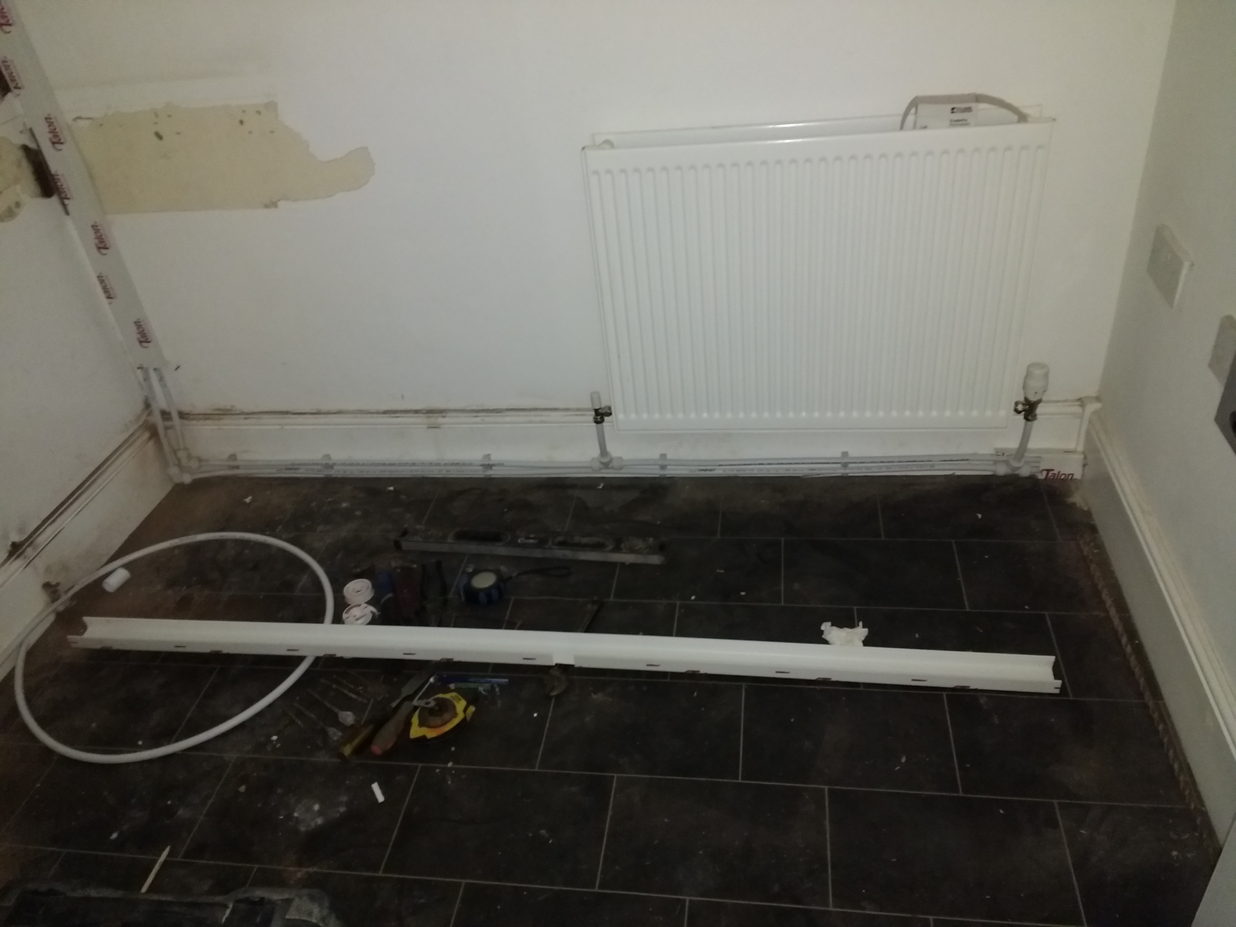

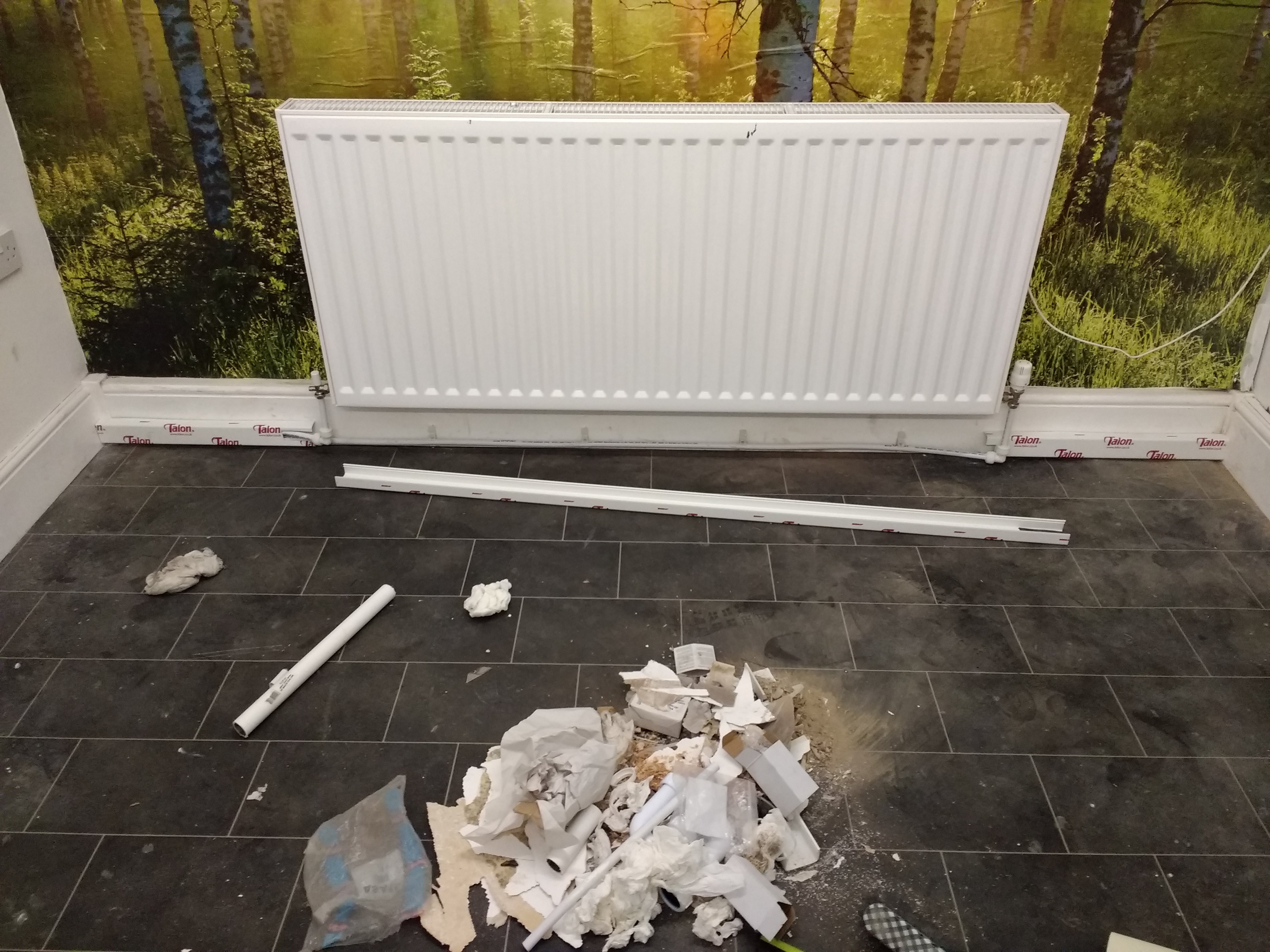

  5. Pics... should these valves not be about 400mm up from the F&R?

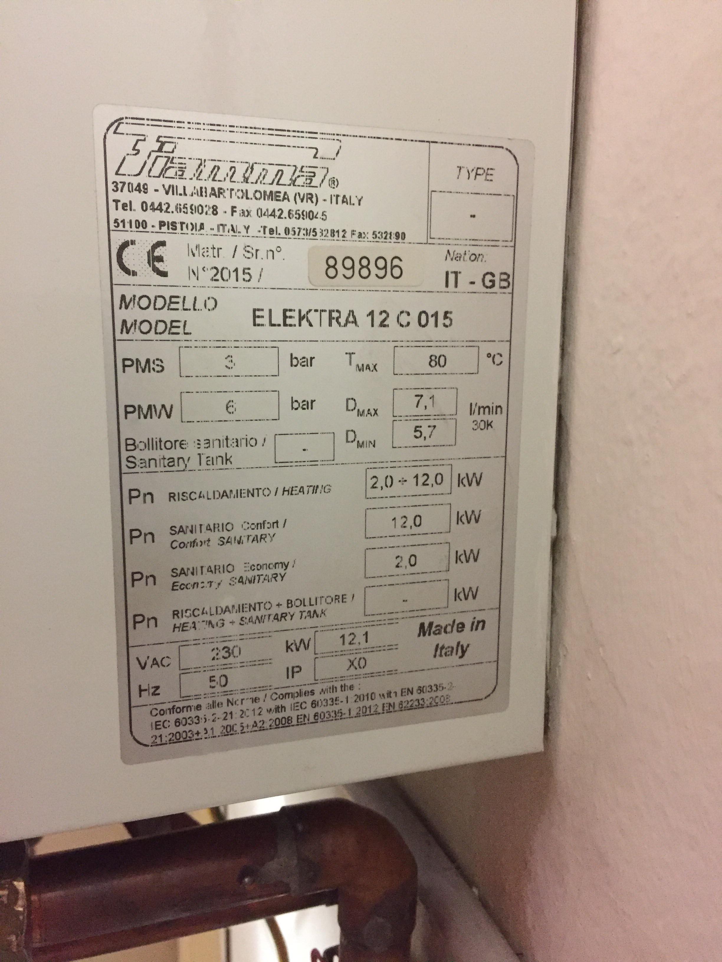

  6. @Nickfromwales I've not been out to site but Div has now fitted the air valves and still nothing. He's going to send some pics of the job later but wondered if the pump may not be up to the job as it's an electric boiler? Any thoughts?

  8. Nope none of them, do you fit on both flow and return at the highest point or only on the flow?

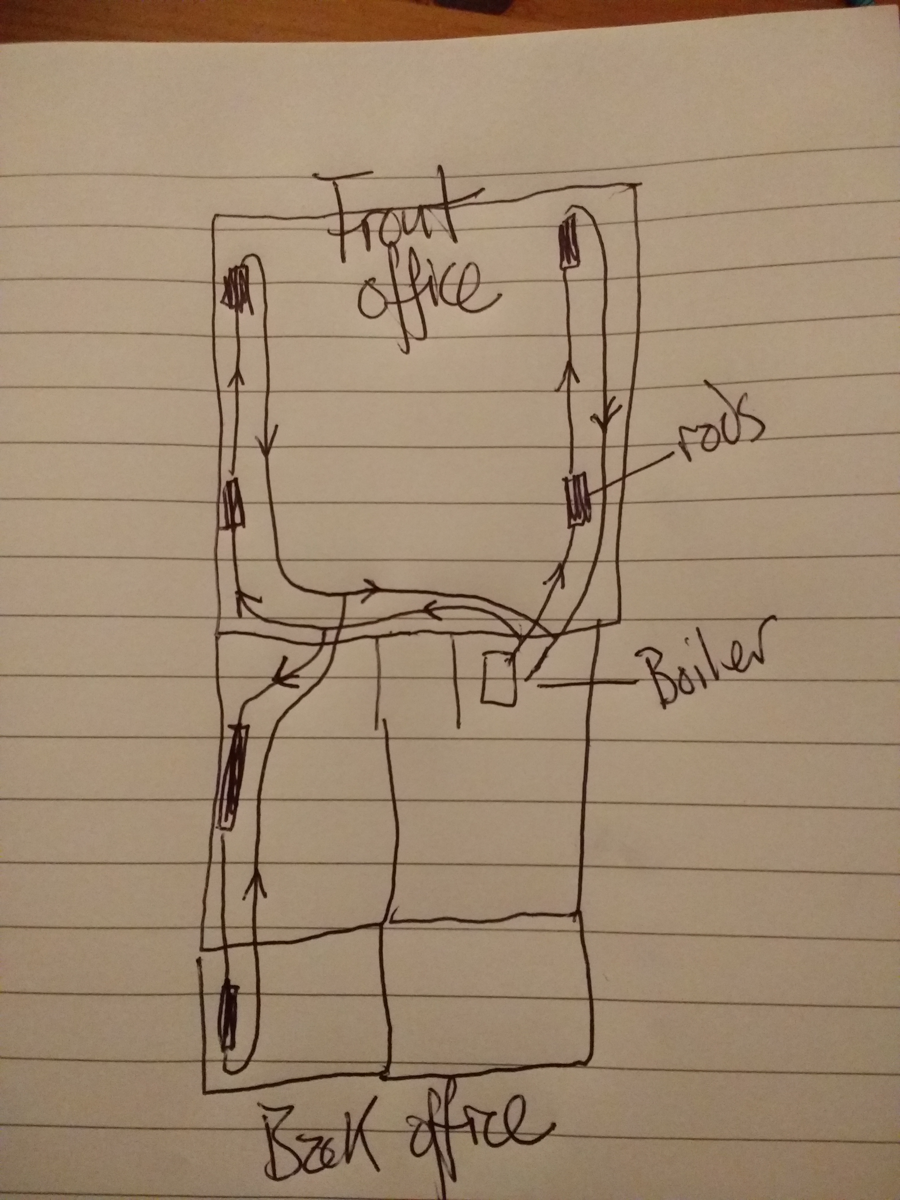

  9. I'll get some pics after the holidays @Nickfromwales I got a plumber ( dope smoking Dave) to do it but he's scratching his head at why it's not working. I think my drawing might be wrong and they are connected in parallel. He found the flow and return pipes in the loft and teed off these to the new radiators but as I say only two now have heat. Could it be anything about balancing or commissioning the system?
  10. @Nickfromwales Can you see anything wrong with this? The two new radiators were added to the back shop and system repressurised but only the two rads on the right of the picture are heated? What have I done wrong? Prior to adding the two new rads all four in the front office were hot.
