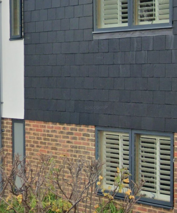

To be thermally efficient I understand that the glass units should be within the insulation zone, whereas if flush with the brickwork they will be in the cold zone. I have done some a bit like this in Velfac but used a small cill projecting about 25mm:
