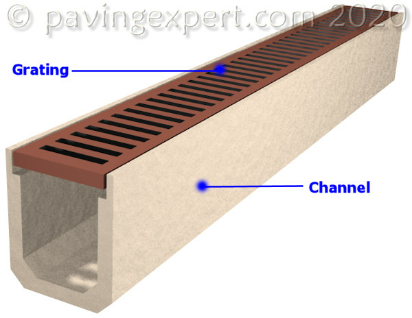

We put in quite a lot of linear drainage around our place. Works pretty well if you have somewhere to send the water. How does the road flood without your house flooding if there is a 10 degree slope down to your house? If you put a linear drain across your driveway entrance will you end up effectively providing drainage for the road? Have you got somewhere other than soakaways to send that much water? whats at the back of your house? Could you run a drain right around the house and off down the slope or would that just flood neighbours? We had the reverse situation. Water going down our drive out onto the road. Put a linear drain across the end and put the outlet into a piped ditch under the road. Effectively we added a long thin gulley to the existing road drainage system.

We have something more agricultural like this but I forget the make. The main thing is to make sure its strong enough. You might only drive a car but the dustbin lorry or oil delivery driver for mr Jones down the road might decide to turn in your driveway. On ours the grating can be removed for cleaning by undoing a screw. https://www.pavingexpert.com/drain06
