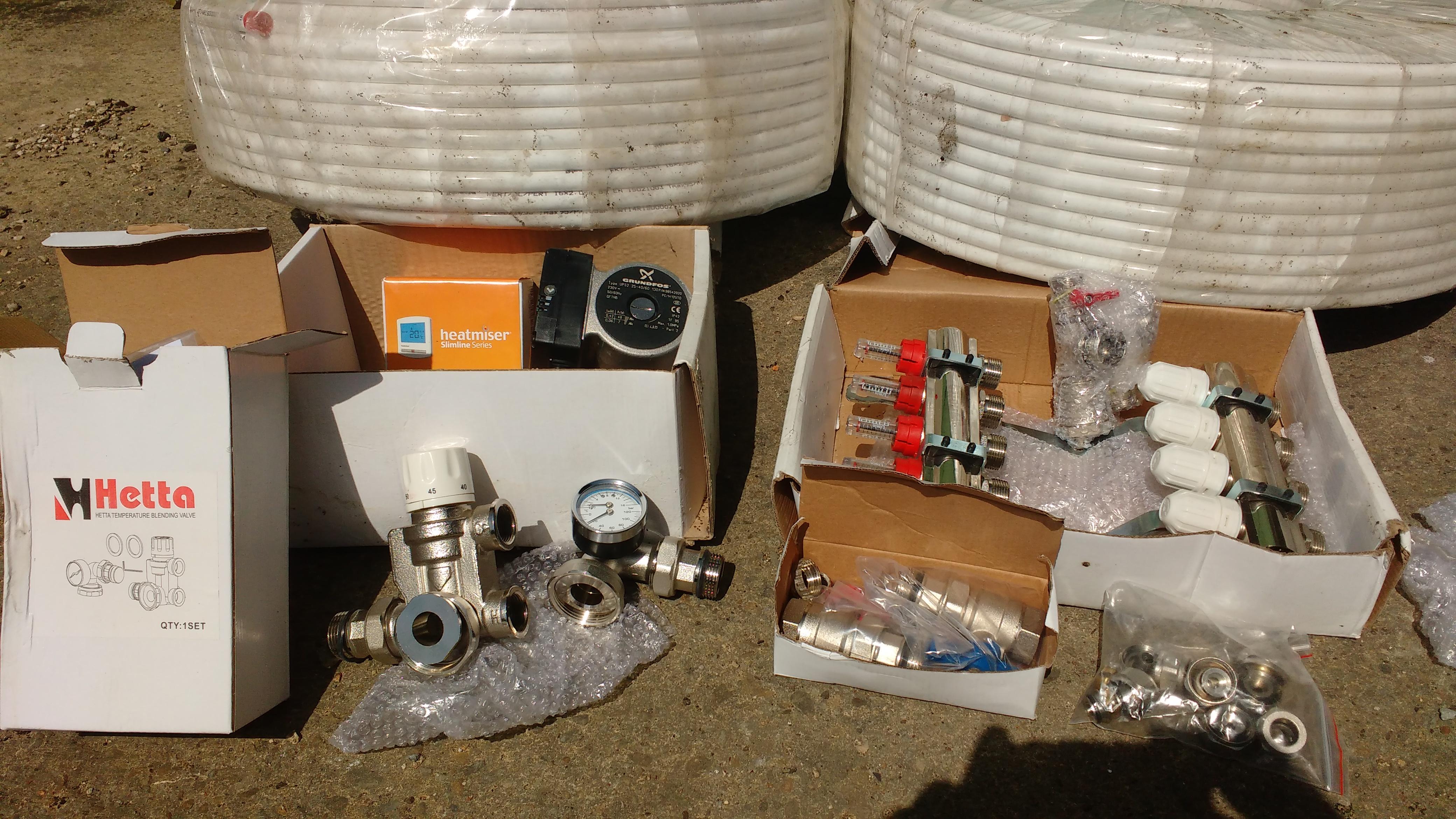

I am getting set to pour my concrete slab with A142 mesh and UFH pipes attached and have a couple of questions. I bought a Hetta 4 way manifold kit with 2 x 200m 16mm pert-al-pert pipe second hand (unused) on Gumtree a while back so hopefully it works and has all the relevant bits! 1. I notice that the kit doesn't include any 90 degree conduit for near the manifold - should i get some like this? https://www.toolstation.com/jg-speedfit-conduit-elbow/p74951?utm_source=googleshopping&utm_medium=feed&utm_campaign=googleshoppingfeed&gclid=EAIaIQobChMIx_qppoKM4wIV4b3tCh3k_QOcEAQYASABEgKTl_D_BwE 2. i have a couple of expansion joints where the pipe will go through - should I use conduit for those sections as well? 3. I was not planning on pressure testing before the pour (mostly because plumbing isn't my strength, don't have a compressor, having looked at some advice on here suggesting it isn't absolutely necessary, also will be running at low temperature (100mm spacing) so pipe expansion issues not so relevant) - do I have to fit the pipe to the manifold before the pour? I was thinking I could leave the pipes sticking up in line and fit manifold later. I think I need someone to tell me to stop being stupid/lazy and just fit it now as I can see it can't be as easy to fit later - it is just that the wall isn't quite ready to fix to yet. 4. Can I use a vibrating poker when I am pouring the concrete or could that damage the pipe? 5. It is an open plan space of 25m2 - at 100mm spacing I make that 10m per m2 so 250m pipe in total is needed. It will all be run as one zone. I am planning to use 2 loops of 125m each in a spiral pattern. Is there any reason why I should do 4 shorter loops instead?

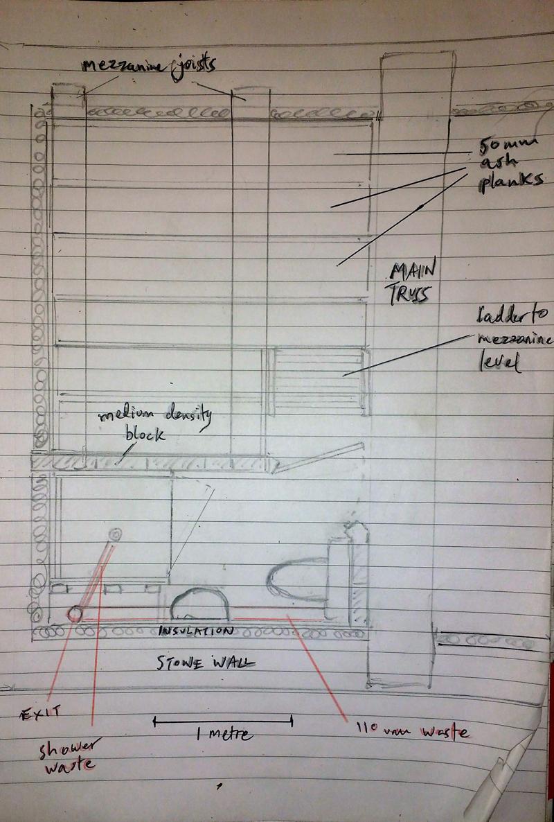

I have been wrestling with how to fit in a small shower room into a small barn (3.5m x 4.5m) with a mezzanine level/bunk bed. The plan I have come up with is attached (apologies for the lined paper). It includes a steep ladder up to the bunk bed and an angled door to the shower room that includes a 800mm x 800mm shower. Any thoughts on layout? Originally it was going to be just a toilet and the soil pipe come up in the corner of the building. With the toilet now 2m from the exit pipe I presume this should still work considering the pipe layout/sink position/toilet pipe outlet height? One last thing - is there a good way of making a thermal break where the medium density block joins onto the main stone wall? I plan to use a wall starter kit as normal but is there a better way that provides a thermal break to match the IWI?
You can also get graphite EPS which has a better lamda value of 0.030. it costs about 30% more than the normal white EPS. I normally get mine from Ecclestons.

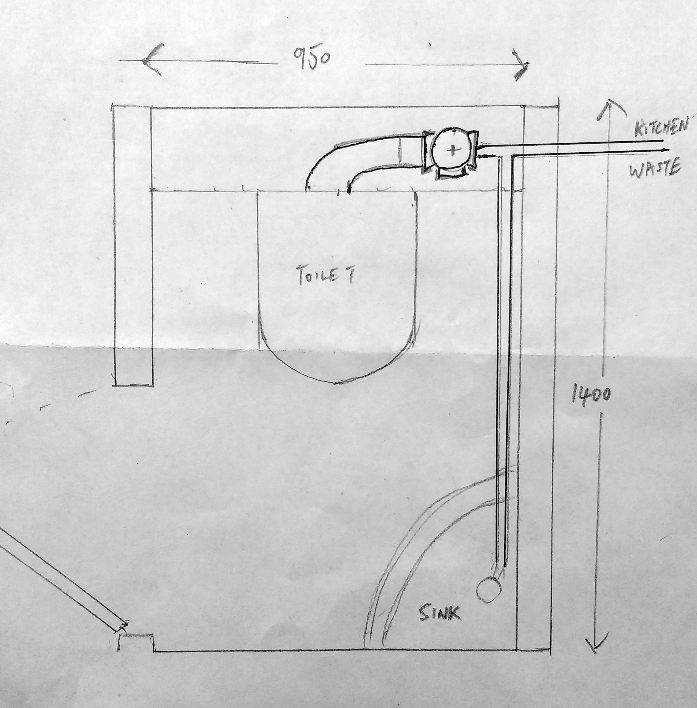

That makes sense Dave. I thought i wouldn't need an AAV as the longer branch that goes to the upstairs bathroom will vent through the roof (off mains, have STP installed). The two branches join at a y junction about 2 metres from downstairs toilet. I'll have to look into anti syphon traps.

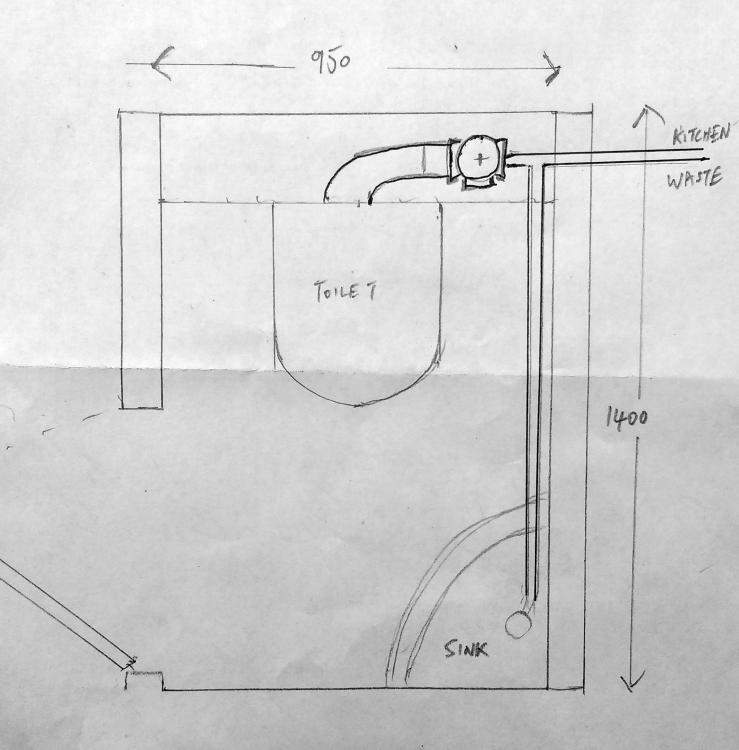

I have a downstairs toilet where the 110mm waste pipe comes up in the corner of the attached plan. I am looking to get an access branch that allows me to take the toilet waste and the kitchen and toilet sink waste as well. I was thinking of getting this : https://www.toolstation.com/access-branch-110mm-9250/p26539 Access placed on top. Toilet waste would go into one side branch and 40mm waste into the other 110mm branch via a 110mm to 40mm reducer. Does that sound sensible?
