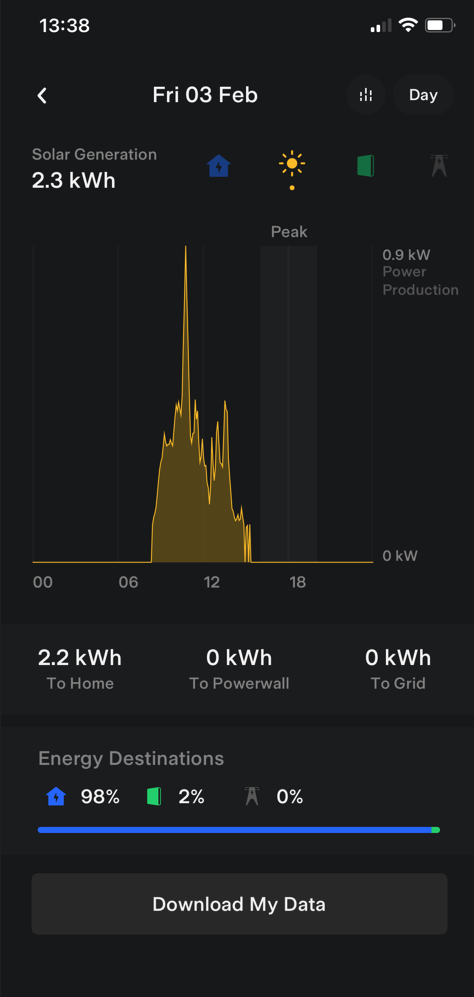

there is some intelligence to it for sure, it 'knows' what your solar profile is so keeps a bit spare.

how have you set it up to charge ? Mine is programmed with the cheap rates (im on 3 different rates depending on time of day) and it keeps to them perfectly.
