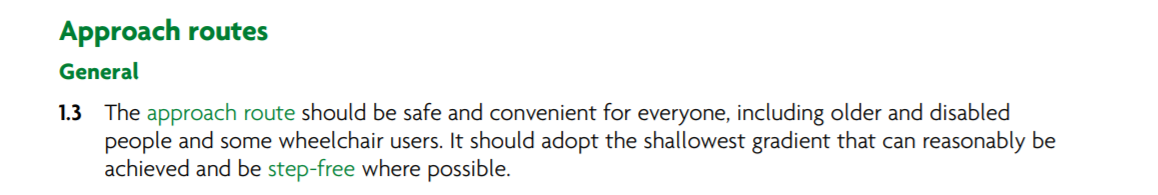

Cover over foul water pipes
Dave Jones replied to MortarThePoint's topic in General Construction Issues
no it doesn't say that, that is your own made up interpretation. Maybe go take a drive around a new persimmon or wimpy site, it will probably boil you over in rage the lack of 100's of ramps that these selfish owners haven't got.- 19 replies
- foul drainage
- pipe
It really doesn't matter what your personal opinion is and if you think people are selfish or not for designing their own home to their own tastes. A bit like the nimbies who plague the country objecting to every planning application. A step or steps are perfectly acceptable even on perfectly flat sites. Should the buyer wish to adapt or change this they are free to do so. It is after all, nearly a free country.- 19 replies
- foul drainage
- pipe
(and 1 more)
Tagged with:
thats what I mean about the BCO being anal making you go through that sharade.- 19 replies
- foul drainage
- pipe
(and 1 more)
Tagged with:
Fair enough if you have a disabled occupant, in which case I would have made a more permanent job of it. Part M also states, in case you missed it, that steps are allowed.- 19 replies
- foul drainage
- pipe
(and 1 more)
Tagged with:
that was a really anal BCO you had to make you do that. There is no rule stating a step cannot be used in Part M of the regs.- 19 replies
- foul drainage
- pipe
(and 1 more)
Tagged with:
whats with the ramp ?- 19 replies
- foul drainage
- pipe
(and 1 more)
Tagged with:
