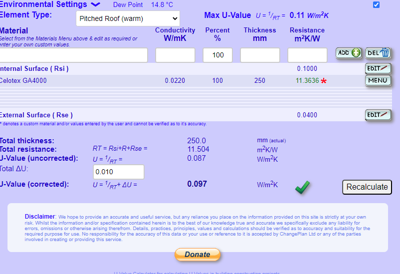

you need 250mm of celtex to meet new build regs or 150mm for a refurb. Issue putting it externally on the trusses (warm roof style) is how are you going to fix the tiles ? Putting it between 8 x 2 trusses and then 50mm again under that works. You then have the issue of making it vapour tight which is very hard as you are left nowhere to run cables unless you batten again to make a service void but it wont be deep enough for downlighters unless you use 4x2 at which point you have now lost 150mm of headroom all over the roof. No easy wins.
