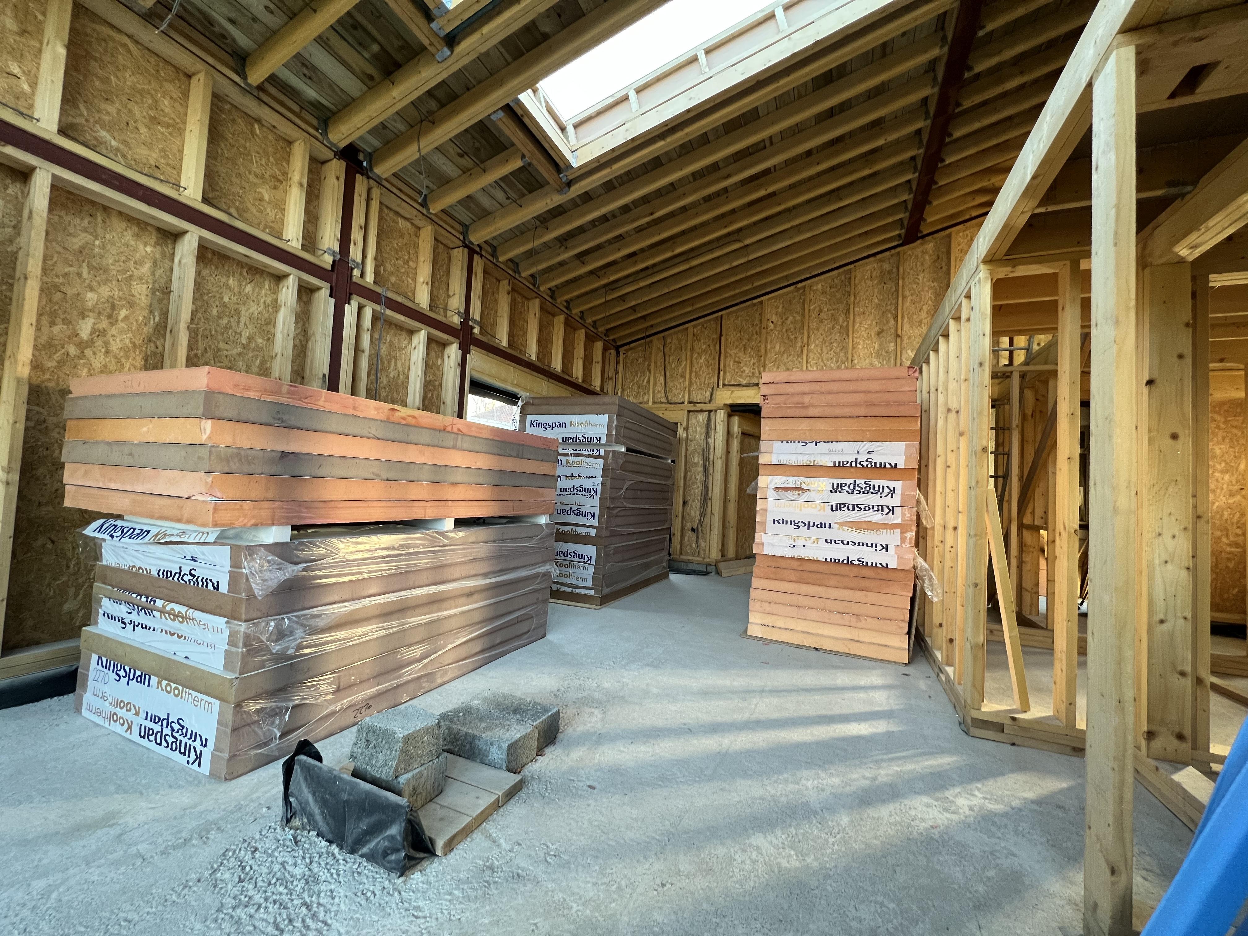

  9. So we had a ‘small’ delivery of insulation arrive yesterday Took Mrs GGC and I the best part of two hours to move it from the driveway where it was offloaded , into the build to keep it safe and allow access. Anyway 😁 As we have a touch of OCD regarding neatness and accuracy…. Whats the best diy’ers method of cutting this with minimal waste, and the best odds of accuracy without creating badly angled cuts creating less insulation against the wall timbers please ?
