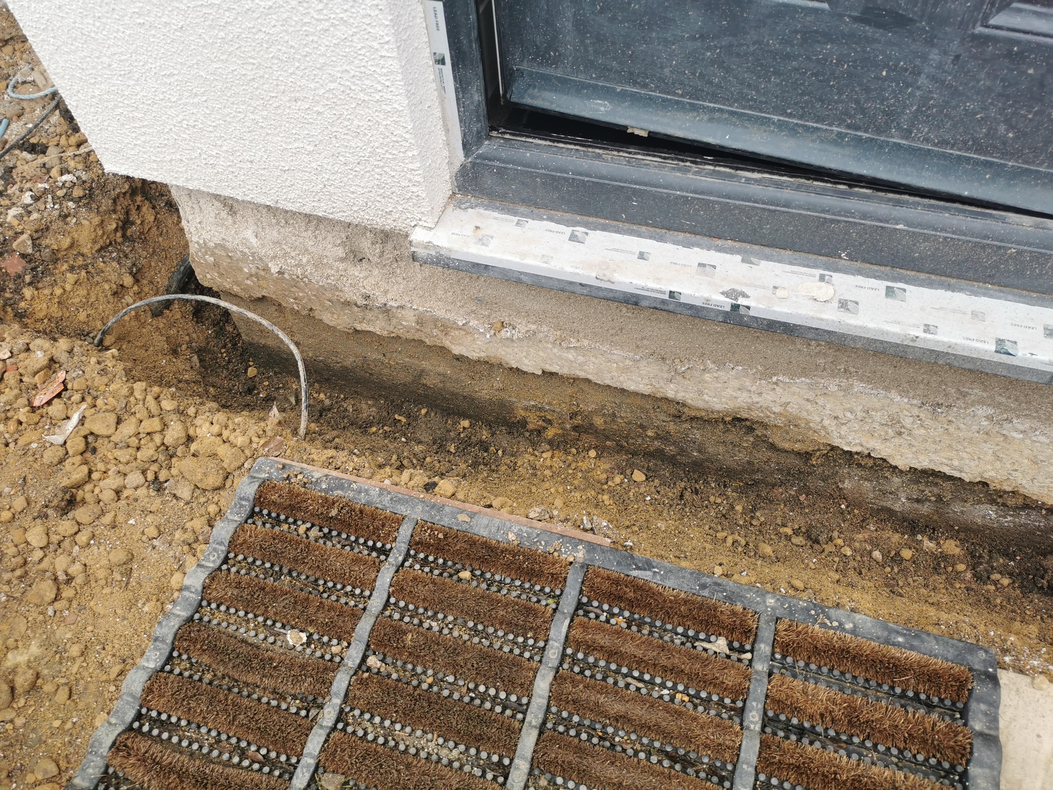

  2. Thank you very much, I will look into this. I took as well some pictures today and noticed that old pebbledash rendering is still on, below the ground soil level. So I guess this needs taking off too to reduce bridging, or?
  3. Hi. I wonder what would be best to use to waterproof the exterior wall below ground level. I have to dig up around almost all of the house for a cable and as we have permanently a problem with rising damp I thought it would be a good time to put a french drain pipe in and possibly tank the exterior wall as well. But I can not see which product would be best to use external and below ground. A lot of videos I found show a product like Everbuild Black Jack Damp Proof Membrane , whilst it says on the product description just above ground. And then is the Everbuild Febtank Super Tanking Slurry for example? What material would you use to waterproof the external wall please, costing not the world? And breathable I guess. Thank you for your help and ideas. Manfred

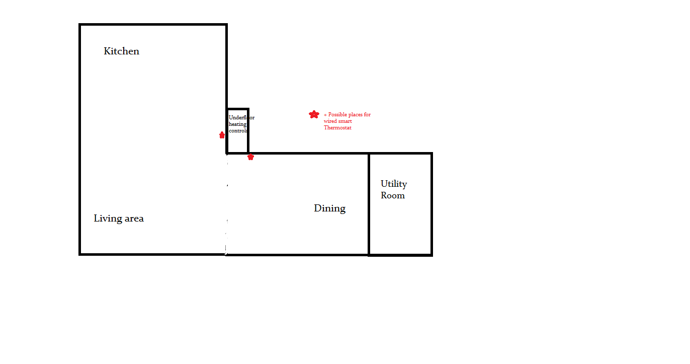

  13. Hi. I wonder if someone could help me to make the right decision please. We have a new underfloor system in an open space Livingroom / Kitchen in a L-shape. The builder put 2 zones in the kitchen are ( one end of the imaginable L-shape ), one zone in the middle where the main Livingroom area is and one zone at the other end of the L-Shape area, where the dining area is, plus it goes over in a nearby small utility / toilet. ( see image ) At the moment we use upstairs radiators tado valves, and we have bought but not installed yet a Tado Starter Kit Wireless Smart Thermostat, to control the Worcester Bosh boiler, and one wired Smart Thermostat for the underfloor heating. The whole space is not huge, maybe 8x4m one direction an 8 x3.4 m the other. I wonder how we can control it best via Tado and how many Tado wired Thermostats are useful, as I could just install them quite close together ( like around the corner with 1 m each from the corner ), maybe with new wiring one direct in the kitchen area and one in the Livingroom/dining room area Somehow it feels that max two Thermostats would make the most sense, and to turn the existing pump for the underfloor heating with those on or off in addition. ( At the moment we do not have any electrical actuators installed , just manual controlled) For example a heatmiser 4 zone with 4 actuators installed. Could I get each 2 Actuators controlled by 1 Tado wired smart Thermostat, I would like to turn the underfloor heating off when a max temp reached and/or over night incl. controlling the underfloor heating pump. Does this make sense or what are your thoughts please? Thank you in advance for your help.
