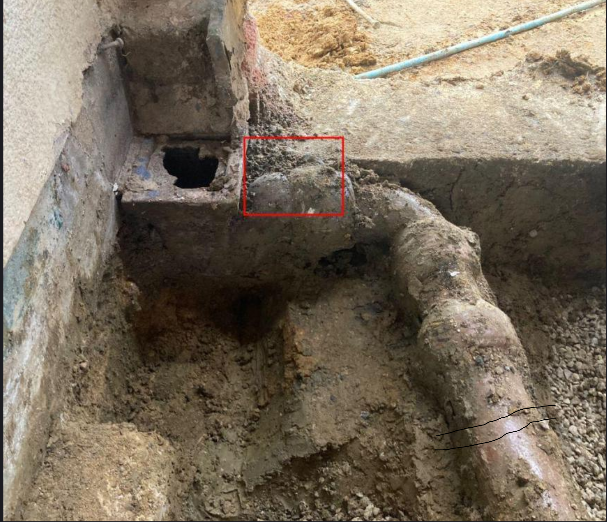

id cut it per the photo then clay to plastic collar and whatever bend you need, there will be some give in the collar as well so easy enough to get it where you want. then haunch it in place with lean mix.
