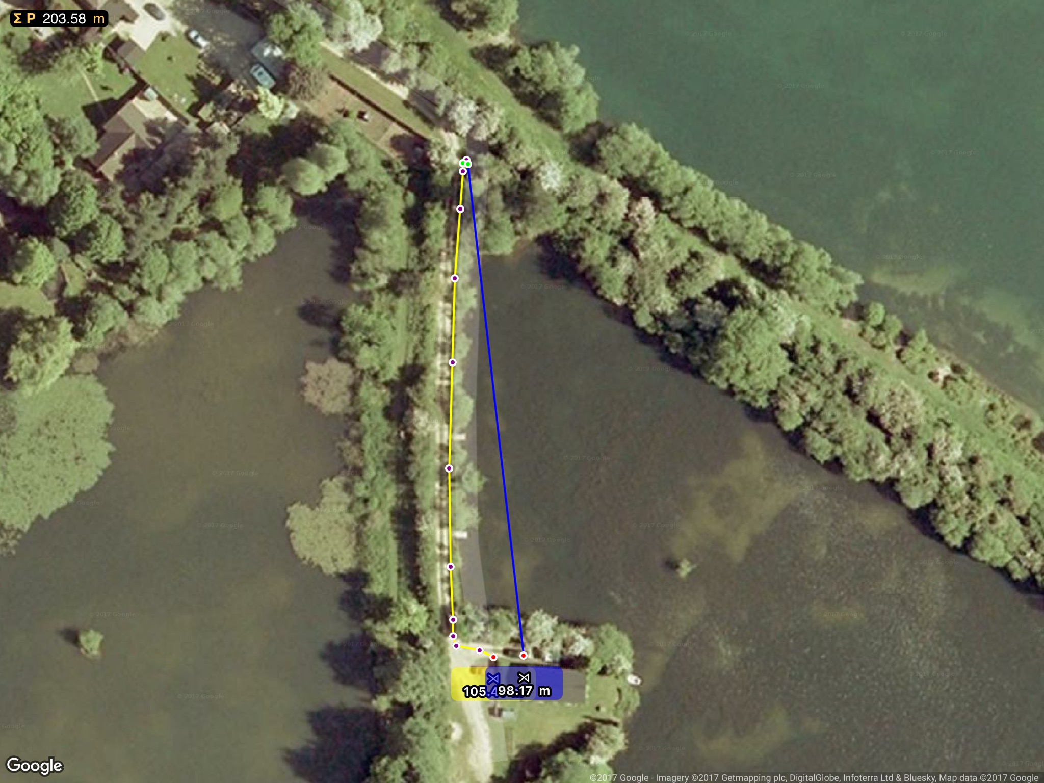

  8. That existing cable had been under water for 30 years it gets lots of light in the summer and I am concerned if I take it out of the lake it could end up being a bit brittle or soft or whatever. Bugger just going to go for a whole new length, just need to work out size as jumping to 70mm is a big cost.

  10. The yellow line will be the new cable, the blue line is where it runs now, on a sunny day you can see the cable laying on the lake bed in about 4 feet of water.

  12. How does every one feel about running a swa cable under water???? wtf I hear you say the cable that feeds the cabin at the moment runs directly across the lake underwater.

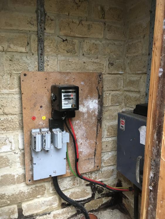

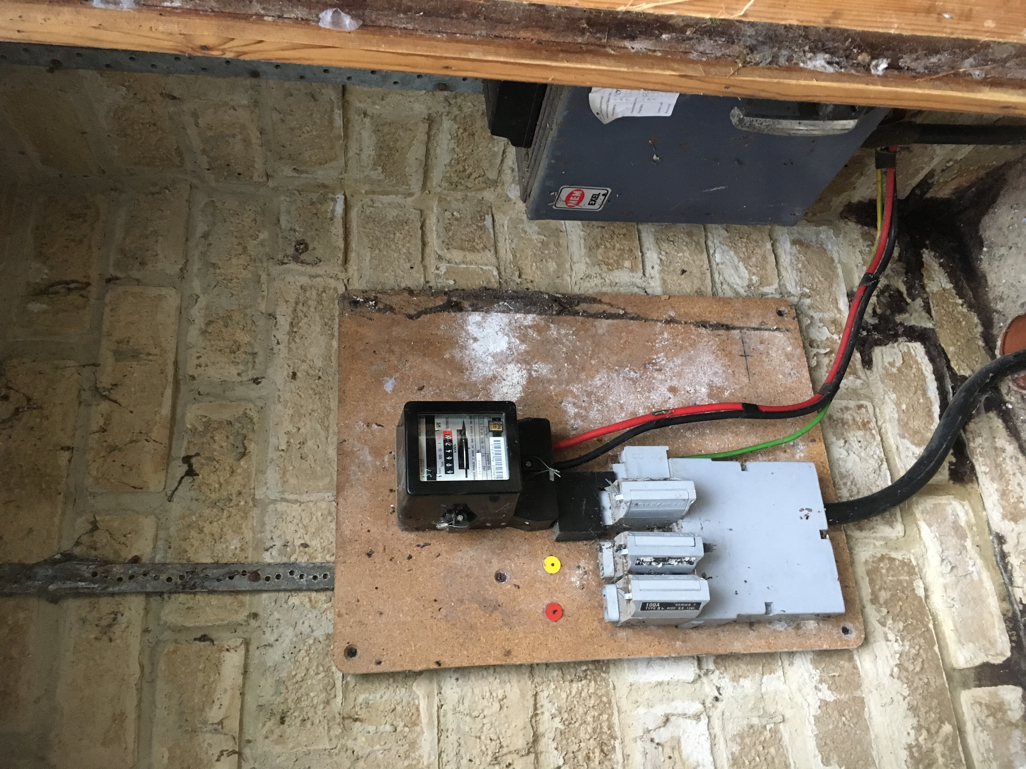

  13. Im not a sparky so I could be wrong, but the 3 phases come to the brick cabinet but only a small feed comes out as it is just feeding a small wooden cabin at the moment.
