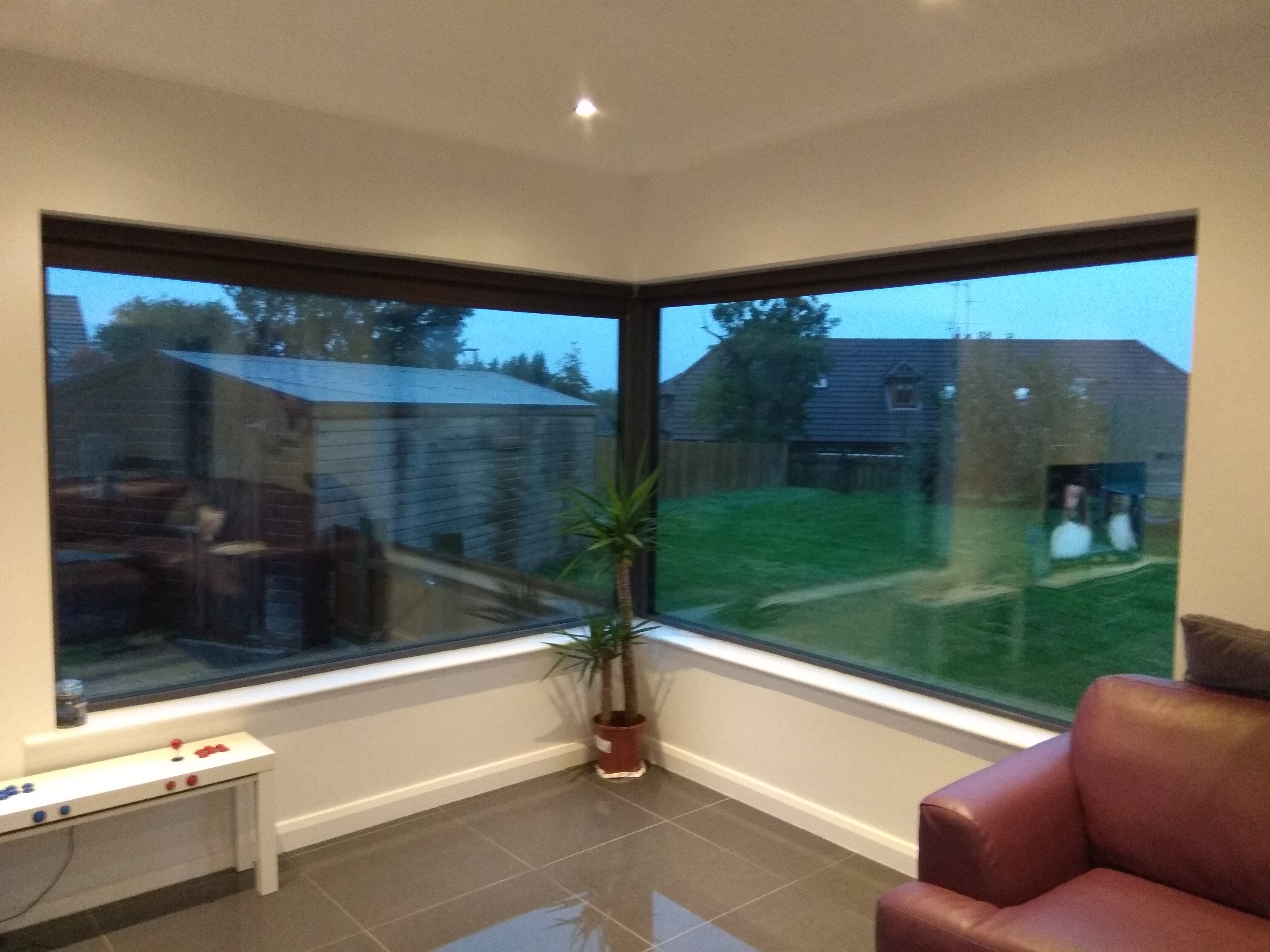

  5. Was monsoon conditions outside so inside pic it is.
  6. No problem I will post one when I get back from work. As far as costs go I think my post was £100 and the catnic was £300. That was 3 years ago and like everything we get it much cheaper than the rest of the UK. My windows either side are 8ft long so thats why the catnic was expensive. Got it all from a steel guy in Banbridge. It's not that it will feel cold it's just that no matter how you work it the metal post is sandwiched between 3g passiv Windows so will always lose more heat than the Windows. You wrap the post in aerogel as it's very thin but is an excellent insulator.
  7. I have a corner window in my sun room. Not that difficult to do. It's basically a heavy wall box section with a plate on the bottom bolted down. Then it's 2 steel catnics that bolt together and sit on a plate on the box section. Nothing to expensive or difficult although having a large steel post in the room will be a cold spot but sometimes you just have to except you will lose a bit of heat for these kinds of things. Have no pics on my phone but will post one tomorrow when I get back from work if it's still light.

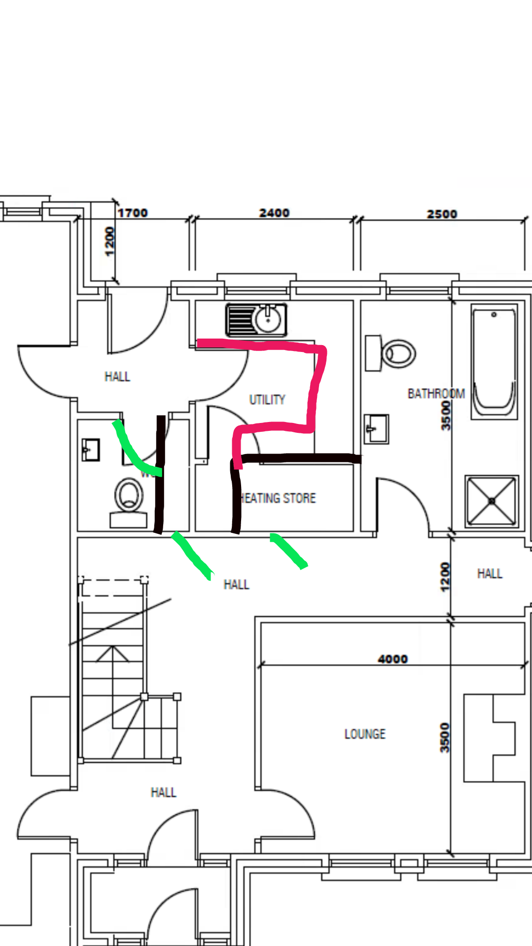

  9. Your down stairs toliet is 1700mm wide which for just a toliet and sink is massive. In order to get access to the utility room from the hall you could reduce this to 1000mm and then take 200mm from the heat store to give you a door. Put a door into the heating store ( what's going in here with a hotpress upstairs) from the hall and it will give you another wall for more units in the utility room. Will still give a floor area of 1200mm wide between the units so won't feel small. Green are the new doors, pink is the units and black is the walls.
