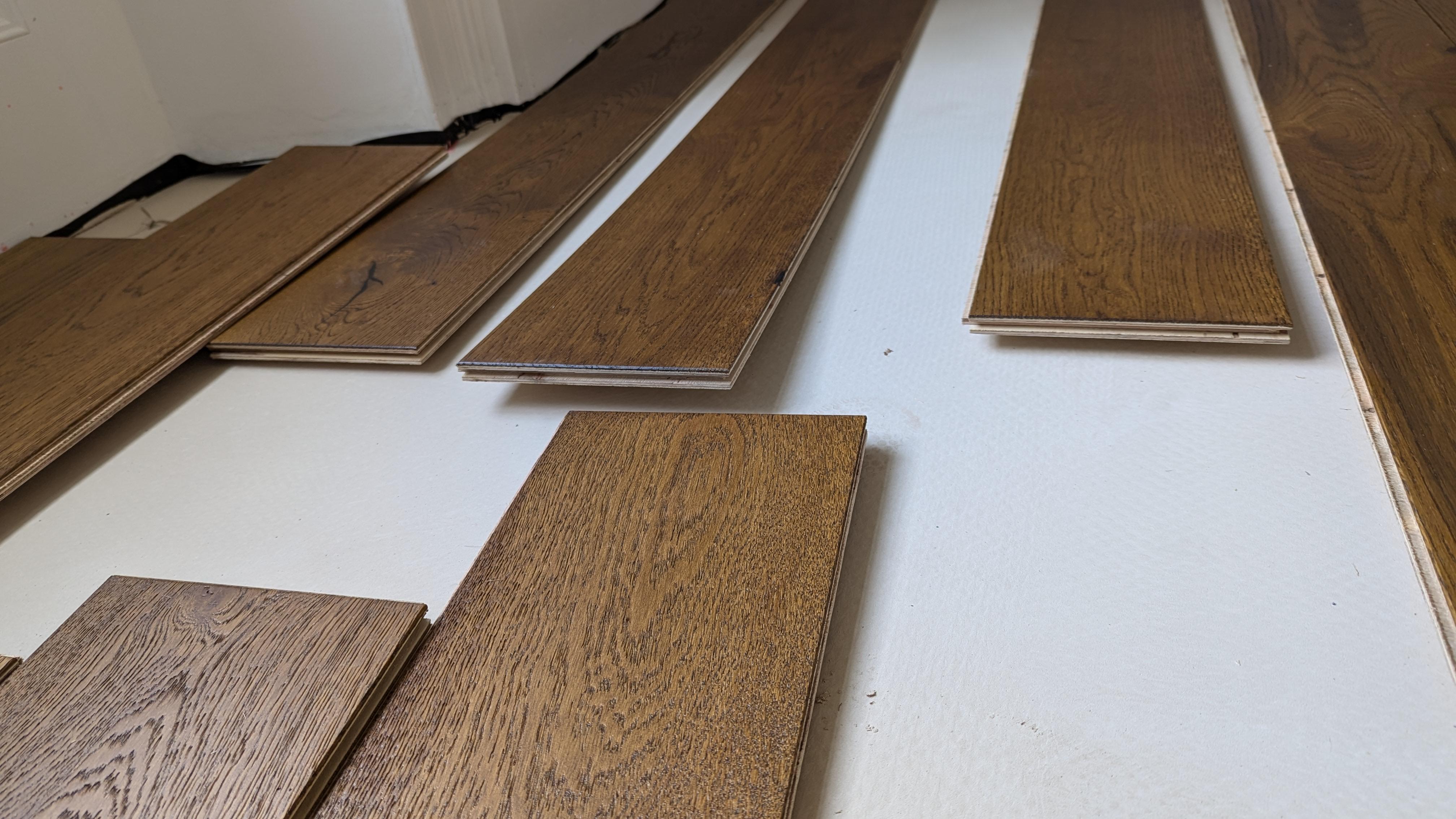

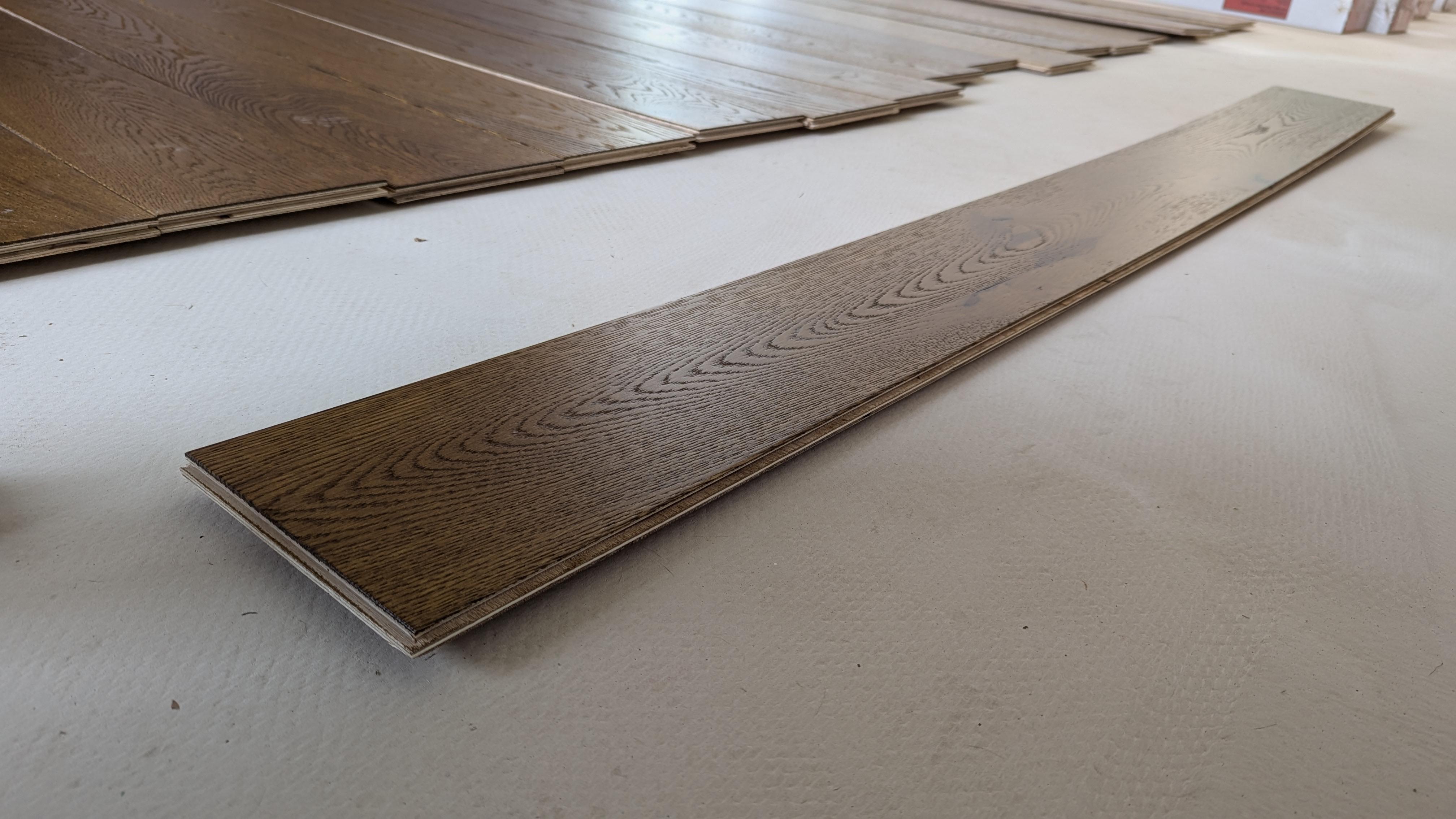

  2. Just bought 30 sq m of T&G engineered Oak flooring. The second sentence on the Installation Guidelines sheet inside the box states "Your Emerald 14mm T&G Engineered Flooring does not require a period of acclimatisation however warranty conditions dictate that the engineered wood flooring is to remain in the sealed packaging prior to the date of installation". So we unwrapped four boxes Friday night, and by Sunday morning, many of the planks had bowed - one of the images below shows a 1850 x 190 plank bowed by 8mm at one end and 22mm at the other end. (Its sitting on a SLC floor which was poured a week ago. RH in the room is 75 %; house is in Cornwall and RH is seldom below 75% ...) The Installation Guidelines sheet also states "at the time of installation and thereafter, conditions should be within the range expected when the building is in use. The RH of the air should be between 45 deg and 65 deg" ..."These figures also apply once the floor is installed" ... "The installer/owner assume all responsibility for the final inspection of both the site suitability and product quality prior to installation in order that the requirements of these instructions are fully complied with. Claims of any nature will not be accpeted if a fault is visibly noticeable prior to installation". I do not have a good feeling about this situation. Thoughts?

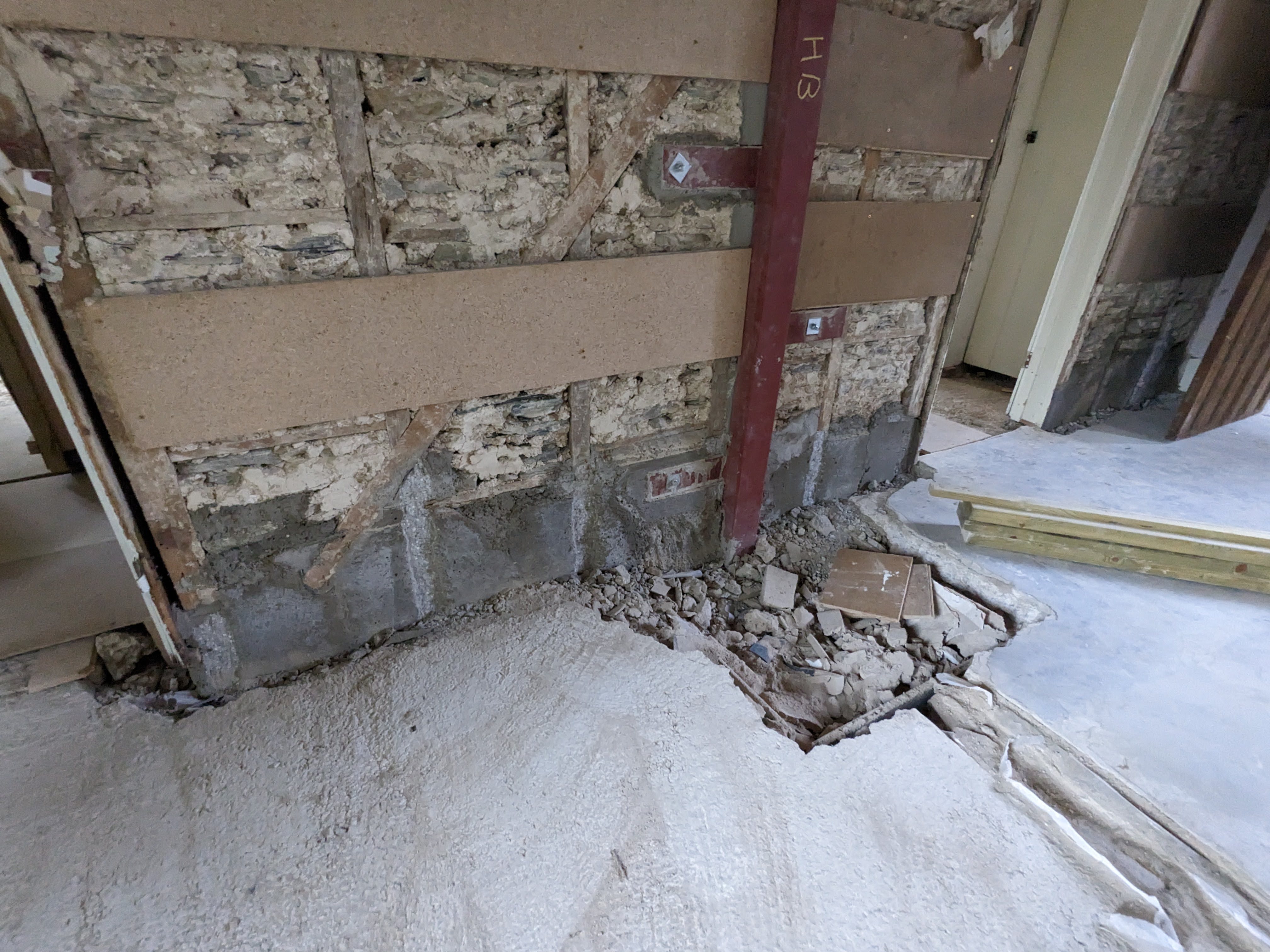

  12. In fact, what we did was to cut away the rotten section, screw in a stud, put a temporary shutter around it and then and then cast a new concrete 'foot' to support it - seems like a good solution to me.
