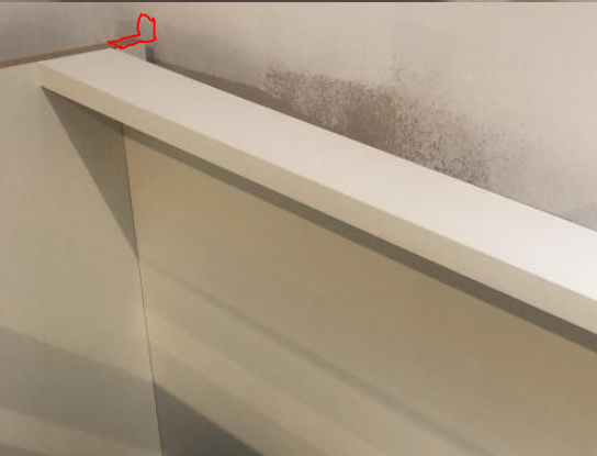

Get a pack of small brackets and fit one to the top of each side panel, screwed to the wall. The worktop will cover them.
