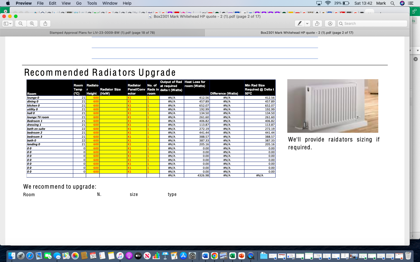

Hi all, and a happy to New Year when it comes. My plumber needs to know the sizes of radiators I am using and as usual I have left planning it to the last minute and thought interpreting the information I have from the heat pump installer would be straightforward (it may be that I am just overcomplicating things as usual!). The heat pump installer has provided the heat loss calcs for the rooms. I am only having rads in the bedrooms: 1,2 & 3. The radiators I am finding online seem to only need to be fairly small to match the wattage calcs as recorded below (at Delta 50) - I had expected them to be required to be much larger (i.e. oversized for a HP). Am I missing something? Should I be looking at achieving the stipulated wattages at Delta 30? Thanks in advance!

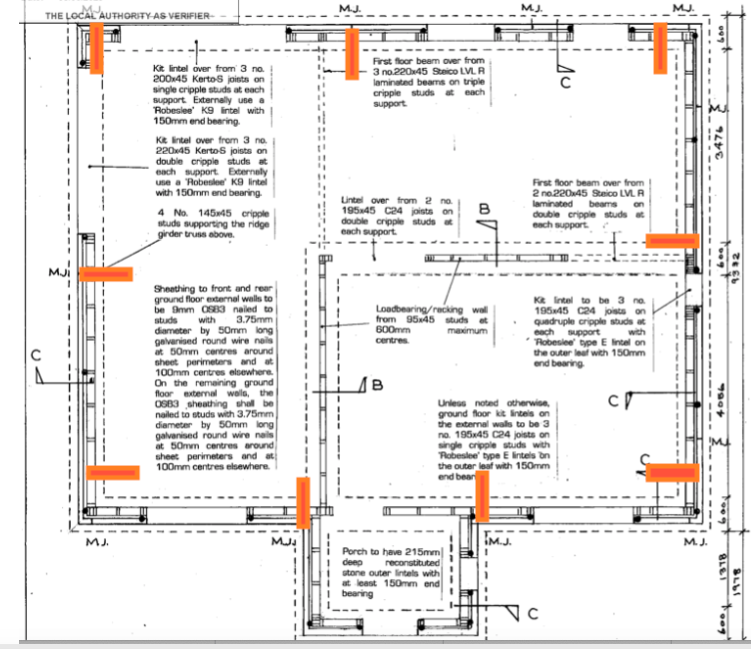

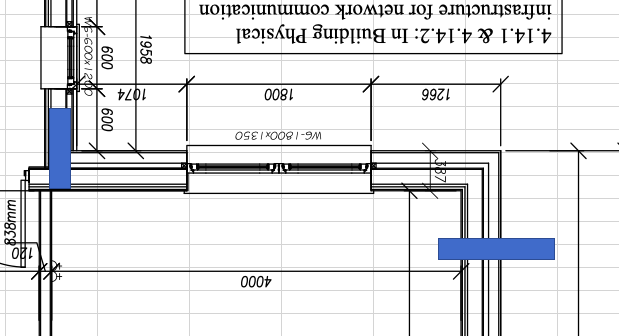

Hi George, Many thanks. The engineer has done the drawings but the brickie has come on site and basically said that what has indicated is a bit excessive and plans to rationalise from 11 to 9. The 9 proposed (in orange on the drawing) seems to make more sense to me but I am just trying to understand the rationale for the SEs drawing. Cheers, Mark

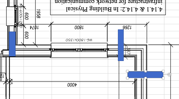

A quick question I hope someone could help me with re: movement joints in blockwork. Guidance suggests that in structures constructed of cement based materials (concrete blocks, artificial stone, concrete bricks, cement render and the like) then movement joints should be provided at 6m intervals and within 3m of corners, however re: the corners - does this mean within 3 metre in each axis from the corner, or just one per corner if that makes sense? (i.e. the difference between the 2 pictures - movement joint in blue): Many thanks!
Expansion joint locations
