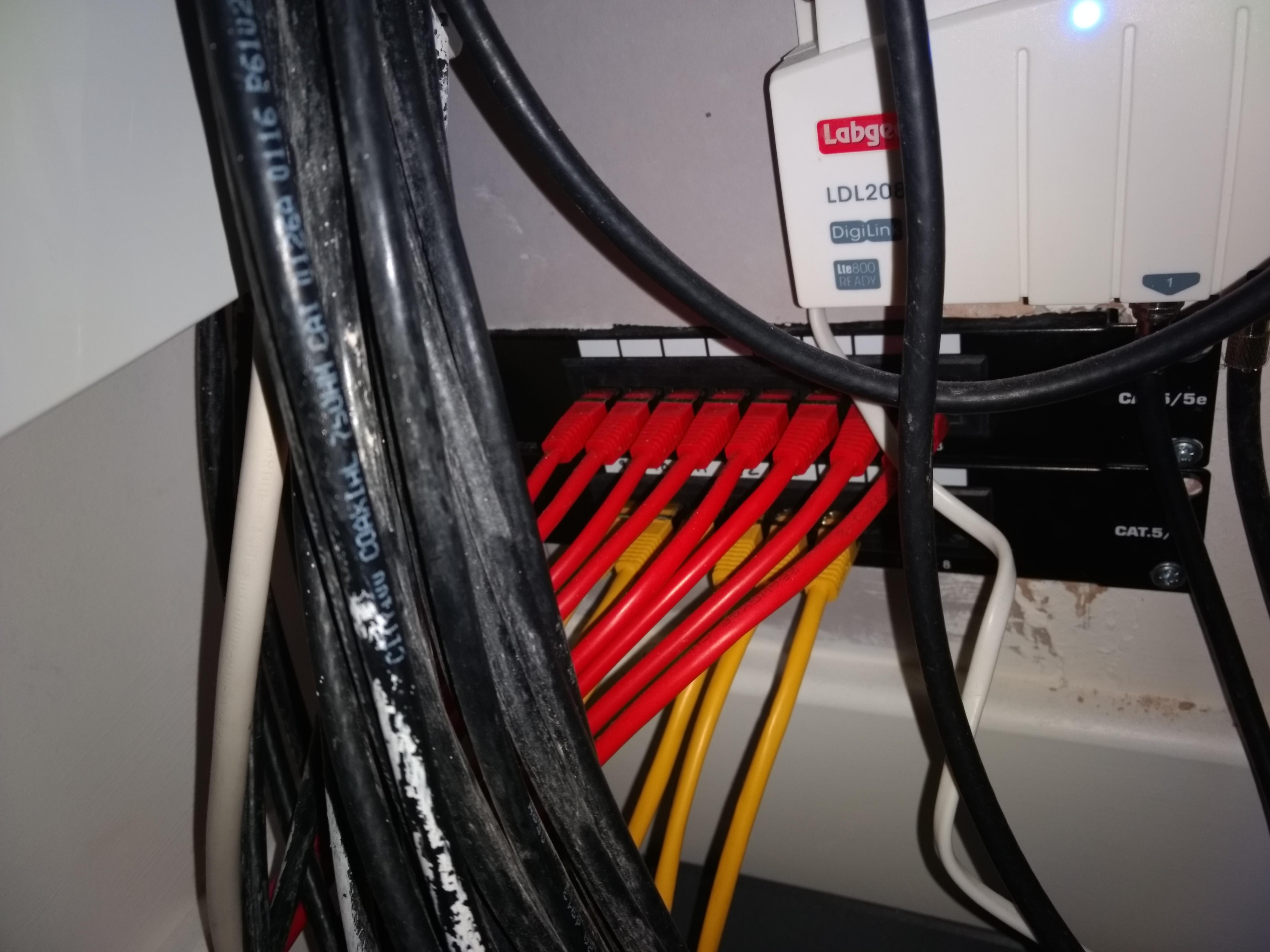

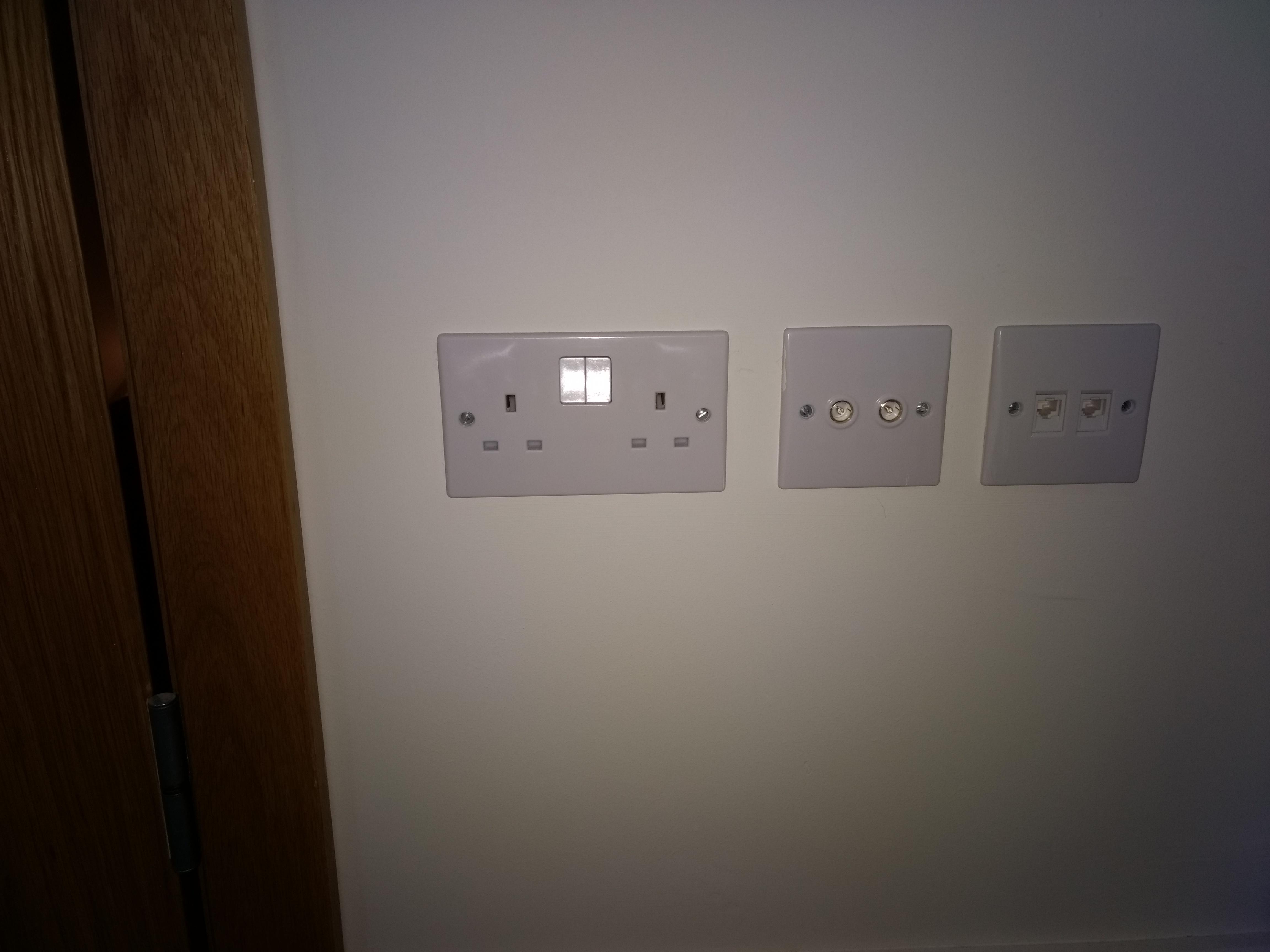

I would go for running 2 anywhere you are likely to use a tv, computer, printer or phone. Run back to a central location where you also have power. I terminated them into a couple of 8 port Trendnet patch panels flush mounted into the plasterboard and connected up with patch leads into a 16 port gigabyte switch. I went for a fanless one as it is a wardrobe and I didn't want any noise. Also ran all the tv coax to the same location. It is a bit of a cable fest, but it works well. -
