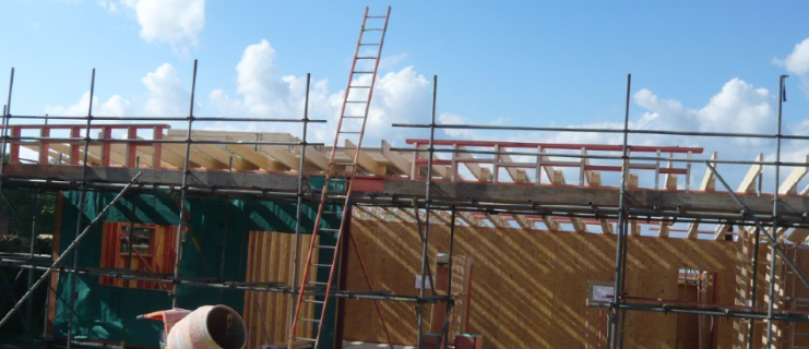

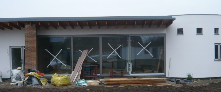

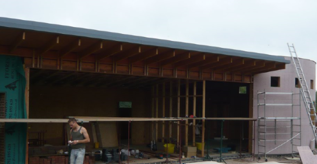

Can you add some timbers for the overhang on the top of the roof joists so they line up with the top of the insulation, so 120mm insulation and 120mm overhand pieces? Then bring the wall finish up to meet them. You will need to insulate around the timber outrigger pieces.
