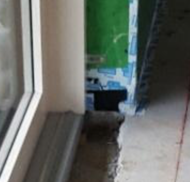

  24. Vivienz, what's your final floor build up consist of on top of the concrete slab? I'm hoping there's a degree of 'optical illusion' going on in this photo.....the slab height relative to the window unit looks somewhat 'marginal'?
