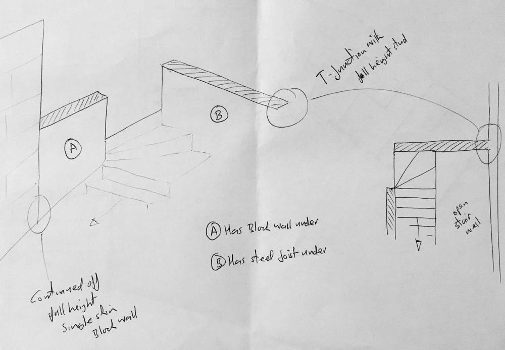

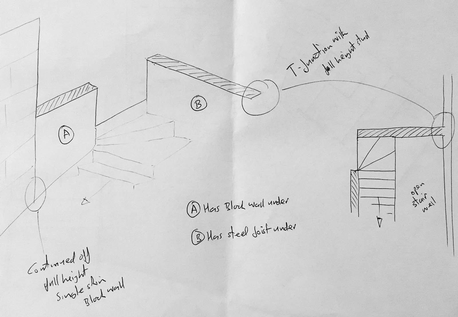

How to make 'open -ended' stud work rigid.
mvincentd replied to mvincentd's topic in General Construction Issues
That's broadly what I was thinking (..or all that I could think of), but was unsure it would be enough. My SE said not to build these in blockwork as they'd be weak so i've been paranoid. Thanks. -

Forgive the cryptic title....'open-ended' is perhaps not the best description. I have 2 sections of stud work which are both only balustrade height and at one end are not captive by another wall. I'm concerned for how to give them sufficient resistance against overturning. Any ideas? I'm realising as I type this a sketch might help;

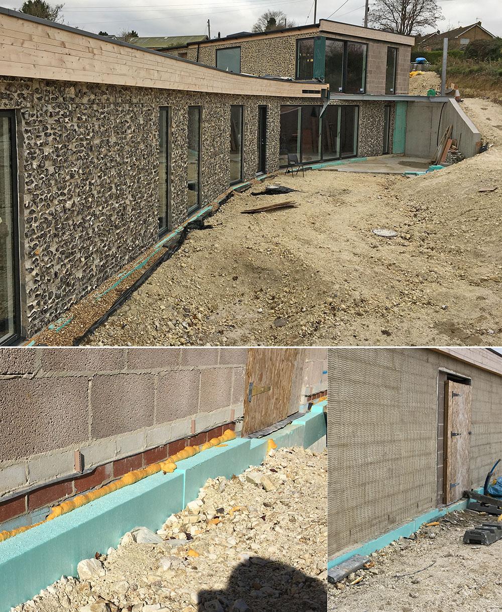

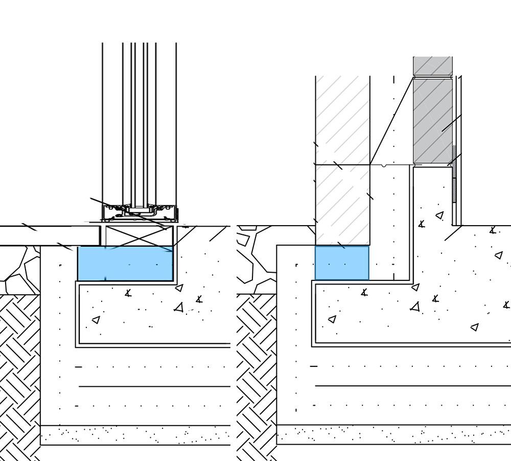

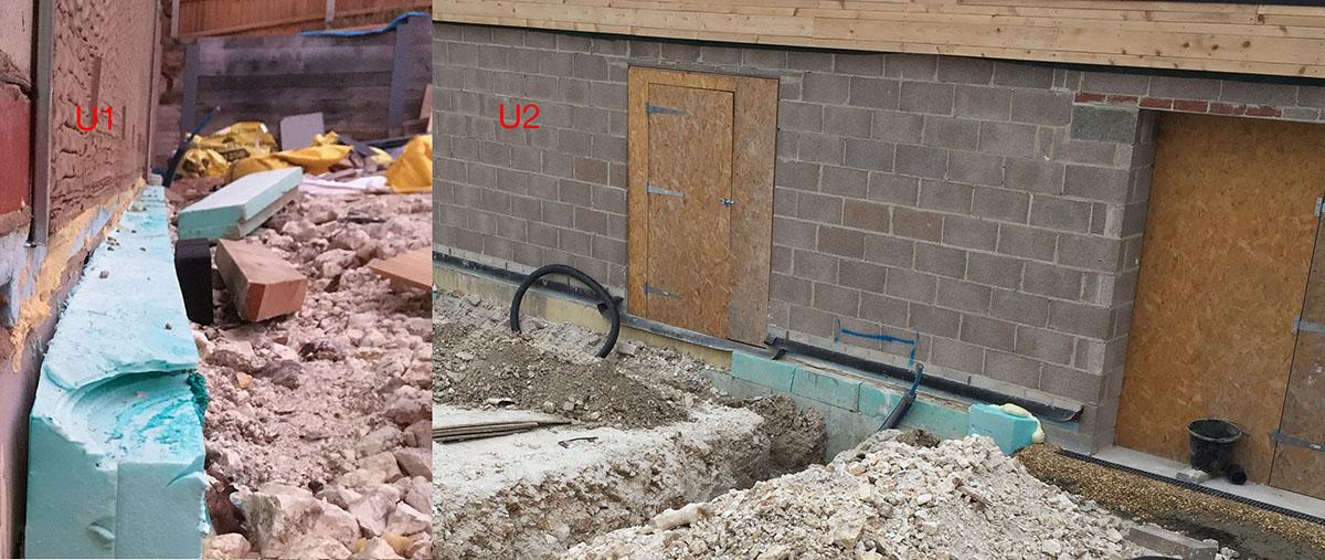

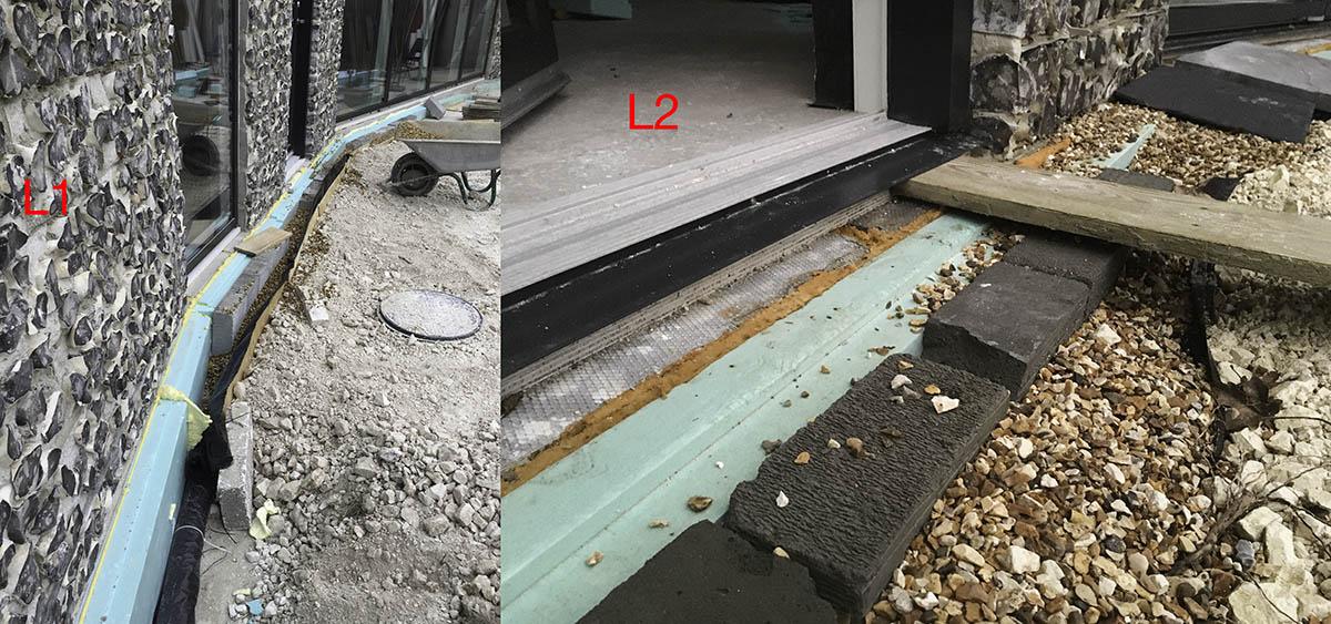

Every opening in the pic I posted earlier is in fact a door style of window....some flush threshold, some with an amount of frame to step over....but always terminating with the same cill and relationship to the structure they're built on. I've 2 issues, but just to first remind where I came into this as I seem to have hijacked @weebles issue/question.......weebles is faced with removing insulation to accommodate something like a paving slab at the door threshold, which to my eye introduced a possible cold bridge. The first of my issues is much the same....for me it's not a total cold bridge (cant tell with weebles from his pic) and only a minor issue of finding a slim paver to bed into limited height. Attached pics L1&L2 shows the scene and the attached sketches show what those thresholds are sitting on (ignore pics U1&U2 for now). My 2nd issue lies not at the thresholds but along the remaining walls where they meet external ground level. On the sketches I've coloured Marmox blocks blue. These are bedded on mortar. You'll see external ground due to exceed the marmox height so i have the porosity of some flintblock & 2 mortar lines in the ground(marmox is watertight)...QUESTION 1: would you put weeps in so that cavity can drain...below ground level?? QUESTION 2; would you continue the threshold pavers along the whole wall? When we go to the upper floor (pic U1&U2) it's a similar issue in so far as I have to bring xps up to meet the Marmox but the bottom of Marmox is at door threshold level...ie higher.
Yes, broadly the sort of solution i'm reluctantly looking at around my walls but not doors/windows because as @Weebles says.. As shown in pics here I have floor to ceiling windows that open like doors and sit on ffl inside. Meanwhile outside my xps rises to a point where it comes alongside the Marmox block on which the flint outer leaf is built (in turn the marmox is alongside the cavity insulation and so the 65mm height of the Marmox is what gives thermal continuity from internal to external insulation). The top of Marmox is circa 22mm lower than the underside of the minimal ali cills that protrude from windows to the outside edge of the flint. On the upper floor (to be rendered) I only half lapped the xps onto the Marmox and used a bit of foam to affix it and fill the odd void, trimmed foam and scratch coated......heavy rain resulted in this combination harbouring a fair bit of water on top of the xps which trickled and soaked through what i presume must have been the mortar joint under the Marmox(below this point its waterproof concrete all the way). Don't waste any brain trying to fathom or solve this....it's simply a unique and ridiculous design detail the professionals did for me that I now have to bodge my way through! My original post questioning @Weebles plan was really to direct his attention to an issue I wasn't sure he'd yet realised existed for him (but if he had and solved it perhaps i could learn from him). It's these shitty little details that bring about quite big aesthetic compromises all because designers don't address them.....my build is bugged with dozens of them...and they're spoiling the fun.
@Russell griffiths yes but that still leaves eps very close to the highest possible point of his external ground level where it meets his cill and what i'm asking is how will that eps get concealed. What is a foot going to step onto beyond the cill and how much insulation is compromised to accommodate that material? I have this particular detail in a multitude of positions on my build and am struggling to arrive at anything other than an inelegant compromise.
