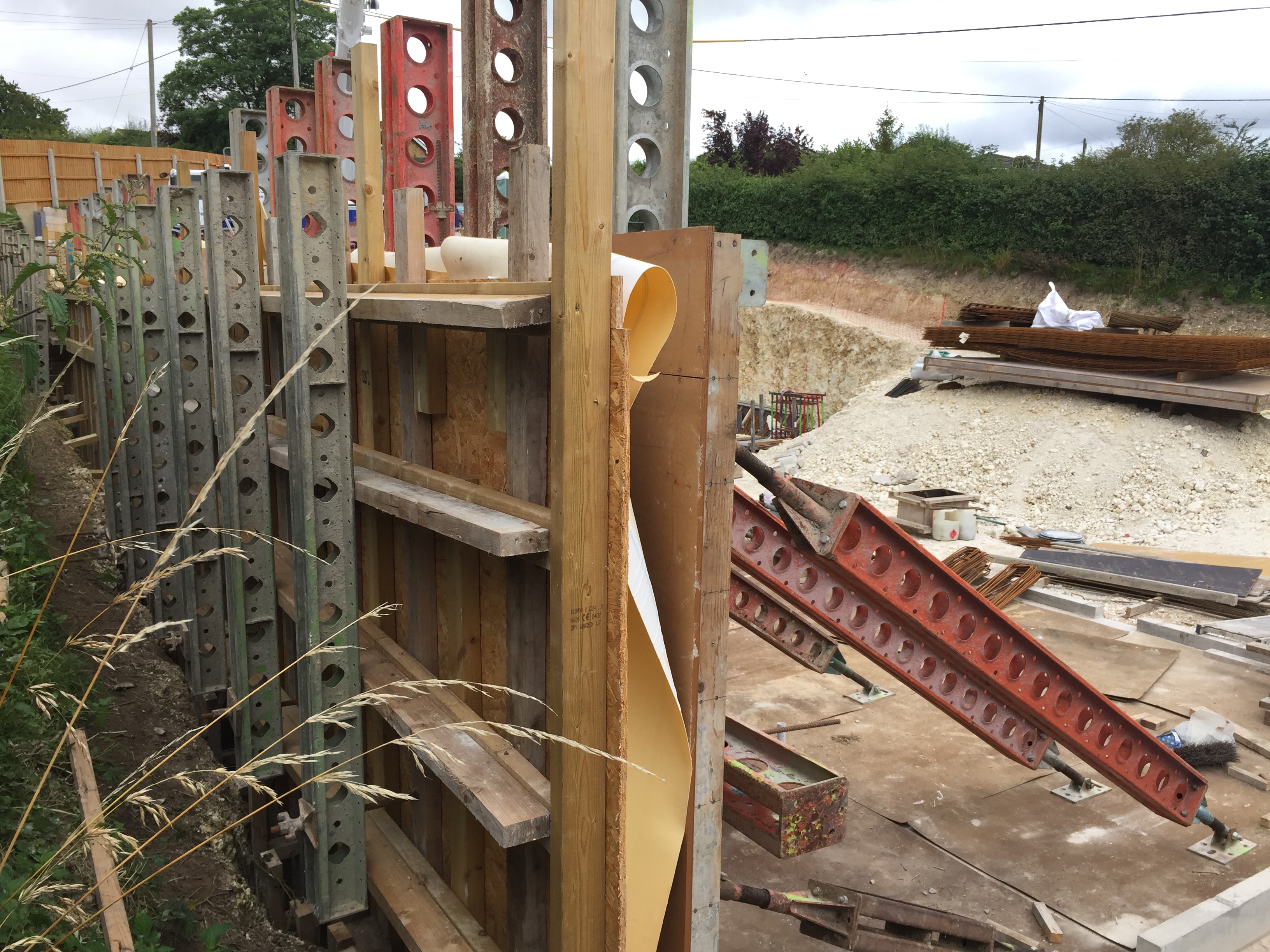

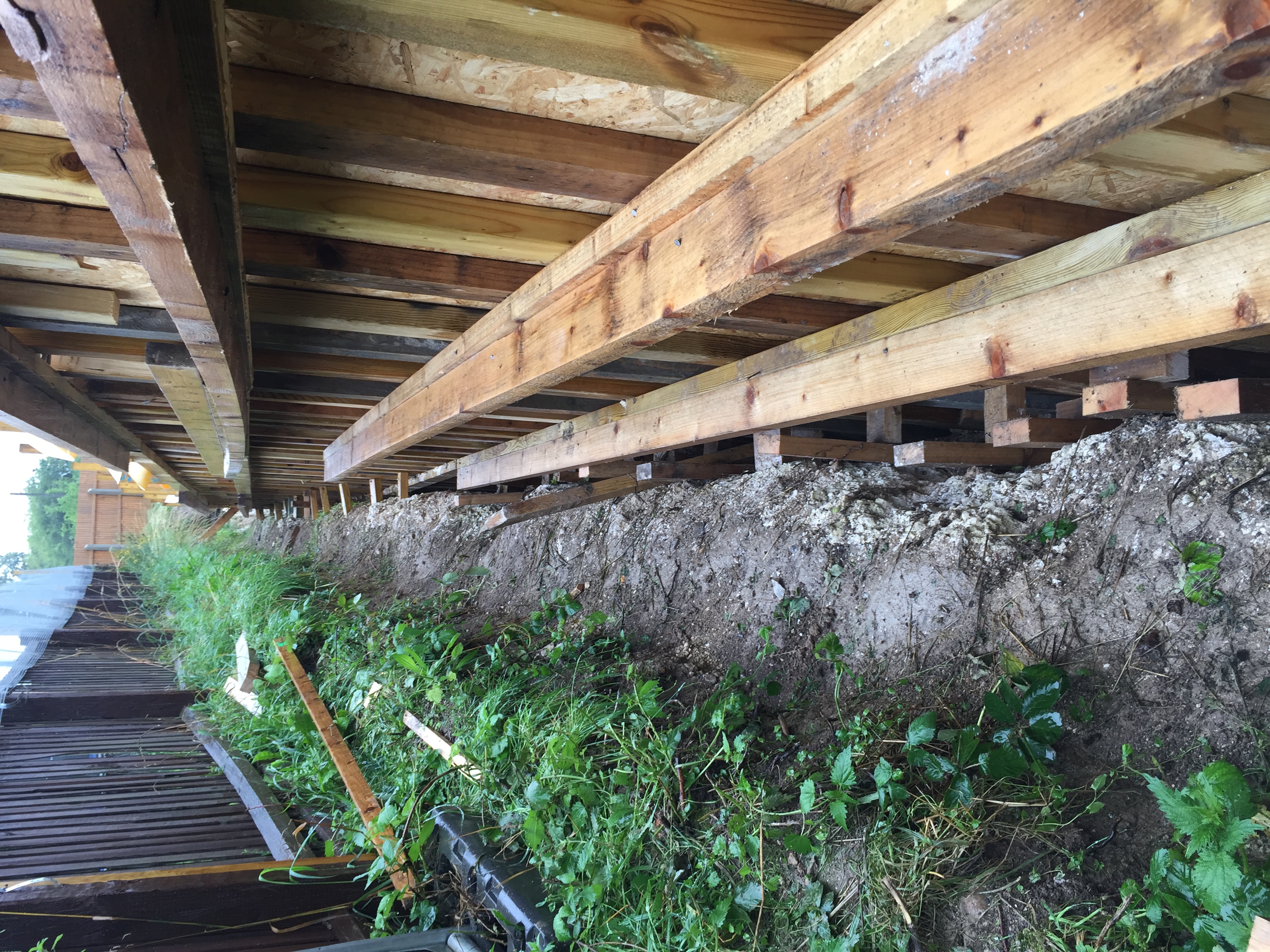

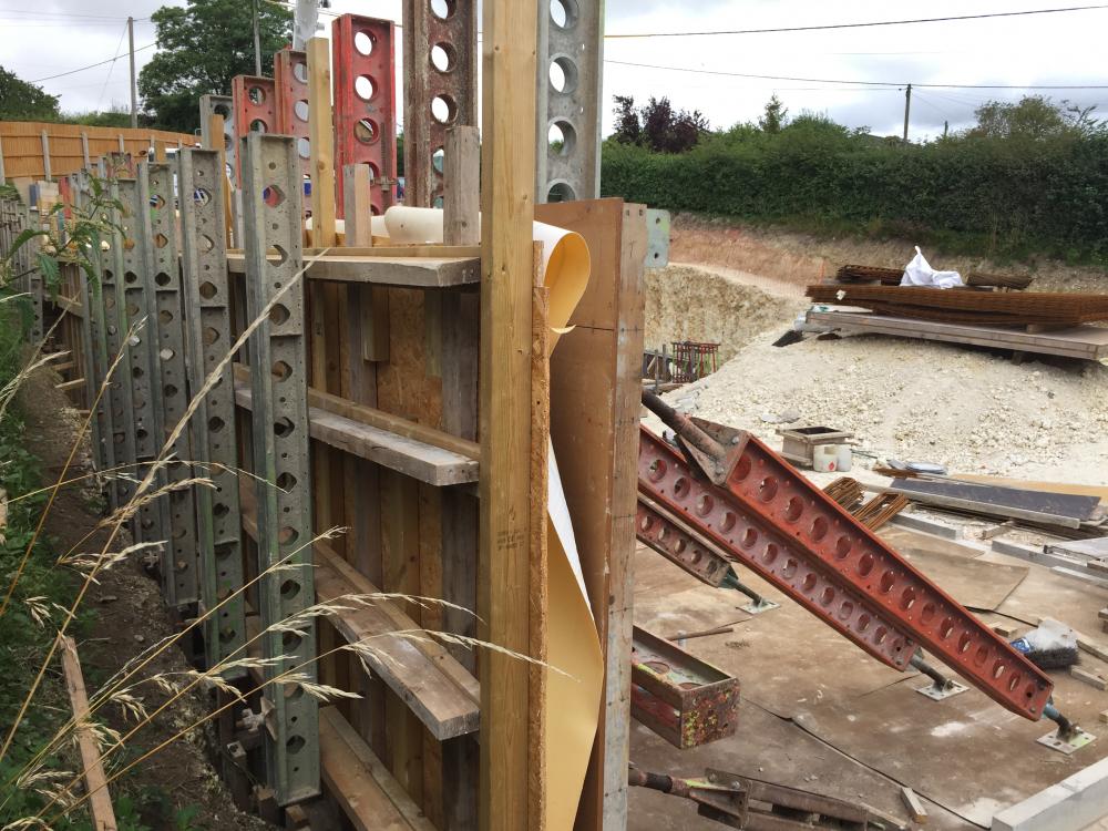

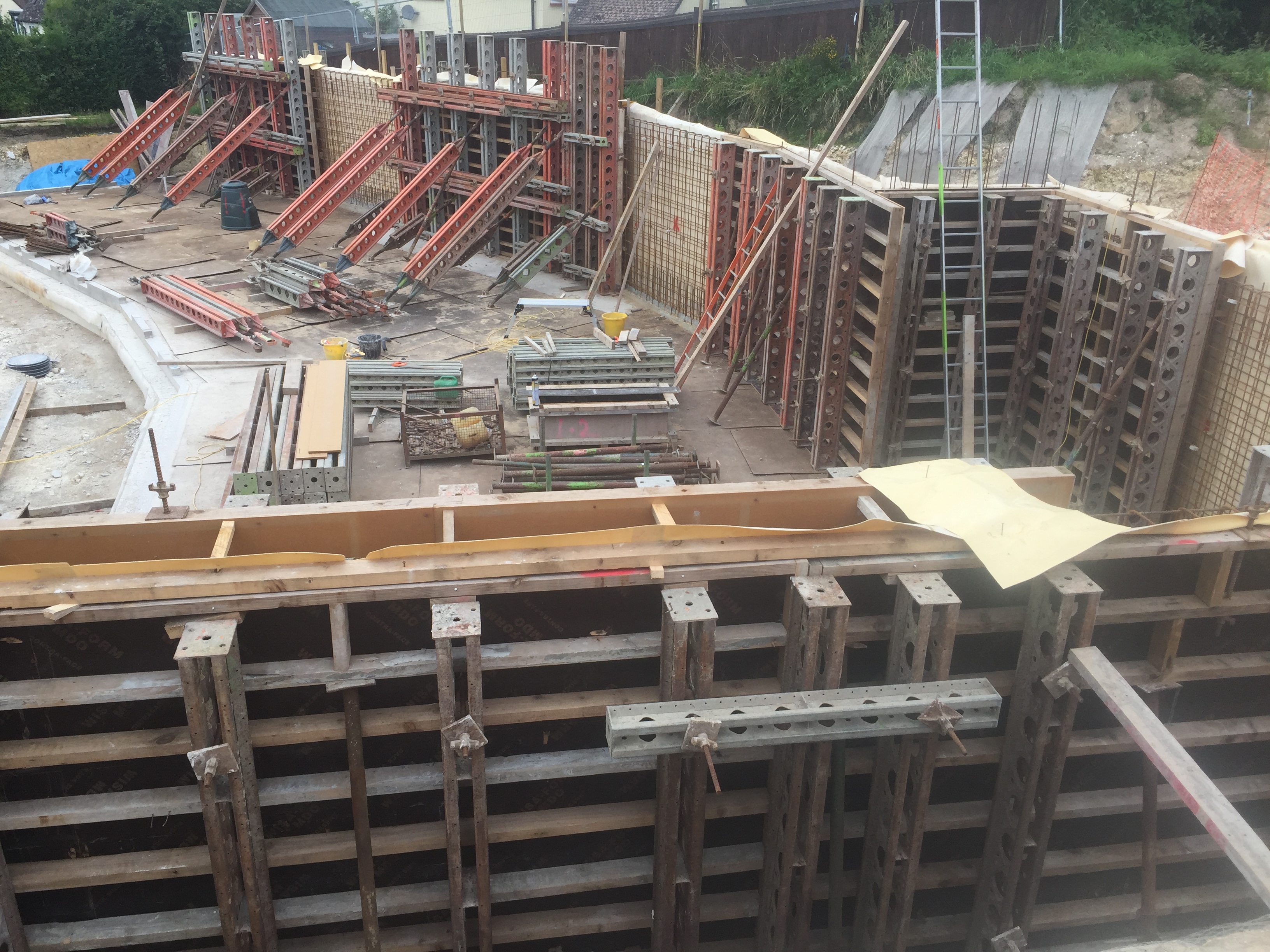

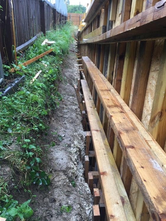

  10. As Bitpite suggests, do not underestimate the complexity of shuttering and the heavy duty-ness of it. Part of my construction was 'single-sided' shuttering.....in other words too near a boundary for them to be able to form their usual shuttering so I had to create a sacrificial face to cast against. I used 18mm osb on vertical 4x2's which i concreted into the ground....then I added horizontal 4x2's...then i chocked it against the chalk face with more wood...and added more bracing where I could. The rc guys just laughed...well, rolled their eyes. When we'd done all we could with wood they added metal soldiers to tie my rear shutter to their front shutter....then they added huge diagonal push-pulls so they could wind the whole structure back during the pour to keep it vertical. Their front shutters are also held in place by captive bolts that were cast into the kicker along with the slab...helping to fight the lifting forces that the poured concrete exert on the shuttering. This is the tip of the iceberg as far as the complexity and intricacy of the shuttering work goes. They were on a fixed price...i don't think they'd do all this stuff if it wasn't necessary. One of my vertical 4x2's still snapped during the pour, thankfully to no significant effect.
