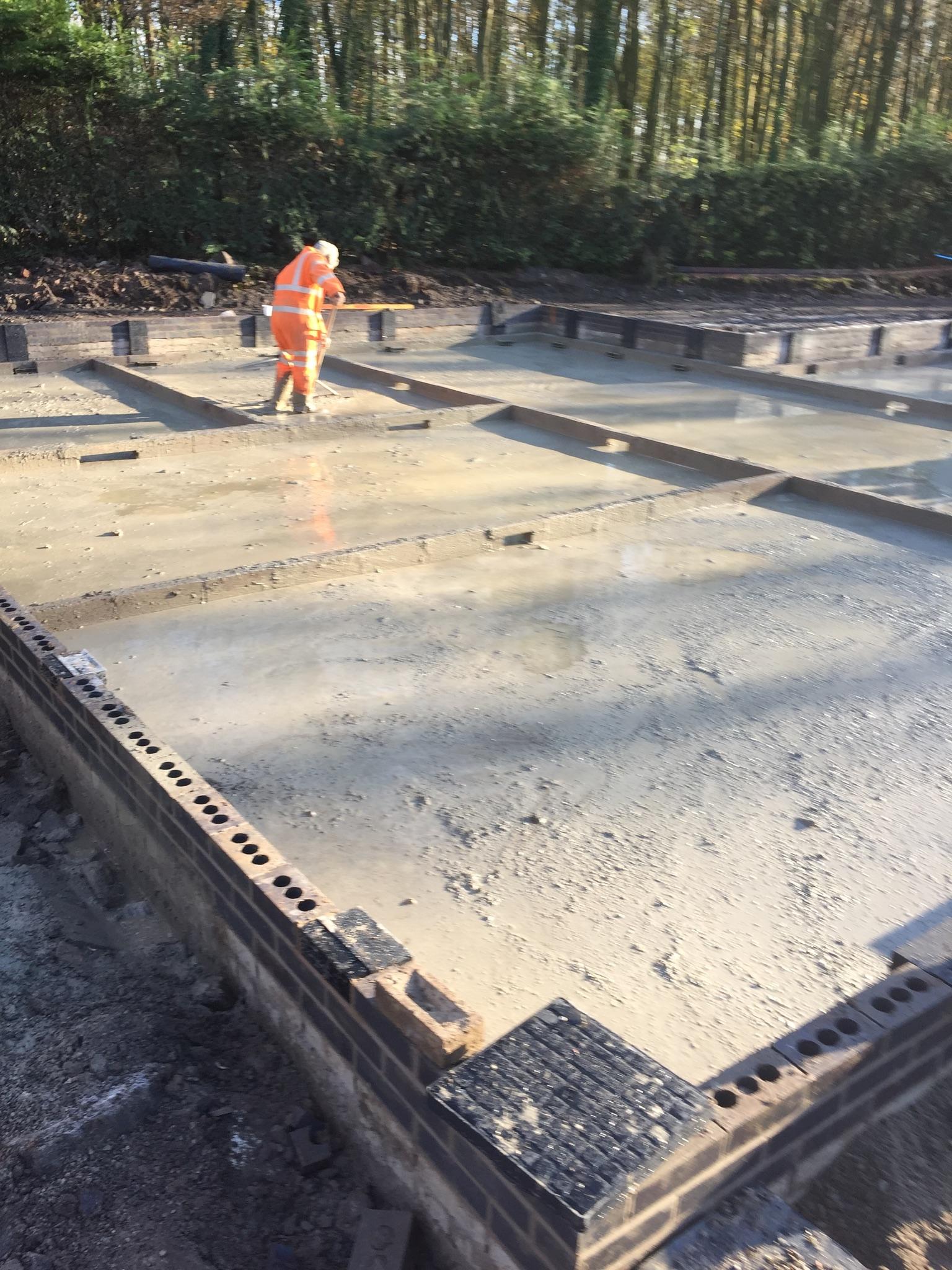

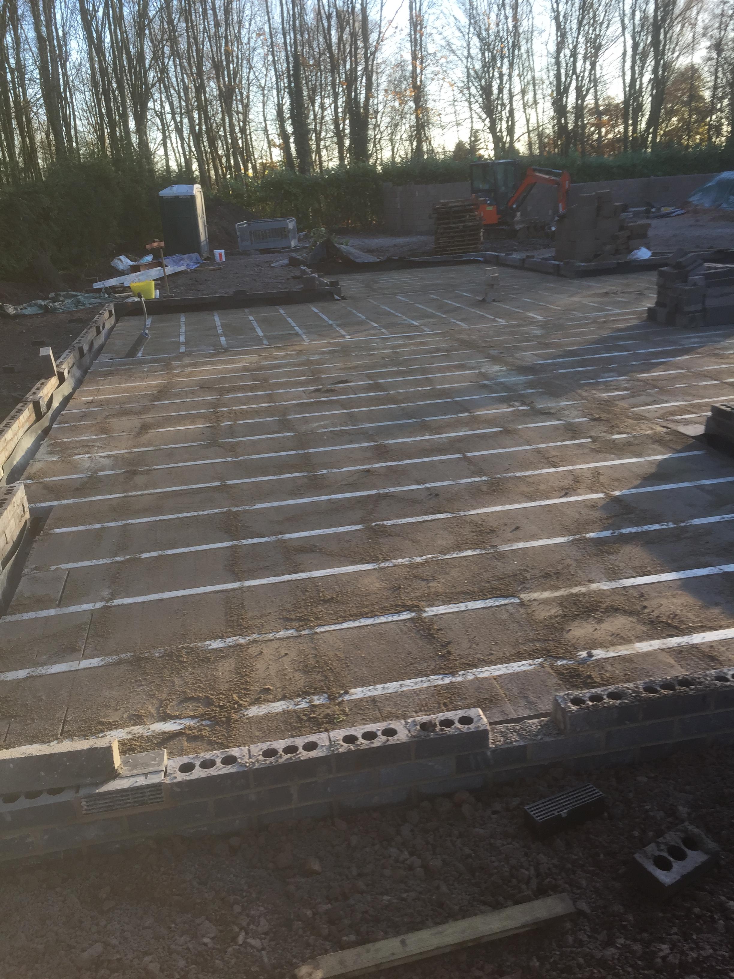

  19. It can mean a.number of things One thing we did have to do Was run several cube of concrete under the block and beam floor that fell to a.central drain This would keep the house clear of water should the garden and contents of the treatment plant flood
