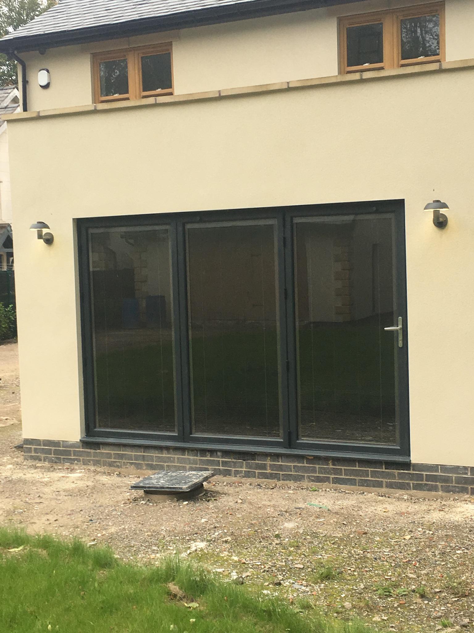

  14. You can just make out two above the lights We render some mainl Housing associations With weeps ever 450 along the DPC and around the middle of the building 10 mil proud They look really bad
