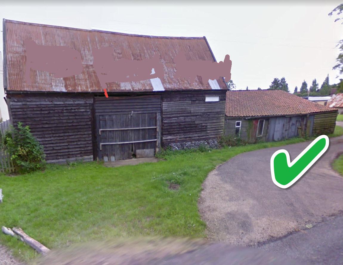

  5. I'm not much of a photo taker so this came from Google Maps. Not much has changed: I had to take out the corner of the adjacent building to get my caravan through on the right and my static sits at right angles in front of the old galvanised roof building you can see in the background on the far right. I was going to start demo. work on the adjacent building this year but I've been so busy. I'm a bit conflicted about the old pan tiles: mixed pans never sit well and I don't have enough to do the whole roof of the barn or anywhere near, but I may have enough for the extension. I'm not sure whether to sell them and use all new or keep hold of them...

  11. Thanks for the replies! Sorry about the quality of the photo below, but it does give you an idea. I'm in Suffolk. It's not listed and is in pretty good shape. Mostly elm. There's an issue with some racking to the front corner, but otherwise it's fairly sound. I have permission to convert and add a t-shaped extension. I have plans etc. but am still not sure how to go about the build as I've been so busy. I hope to be able to work a bit and then spend money on the build; rinse and repeat for as long as it takes. I don't like loans etc. and have never had a mortgage, but I may have to consider it....
