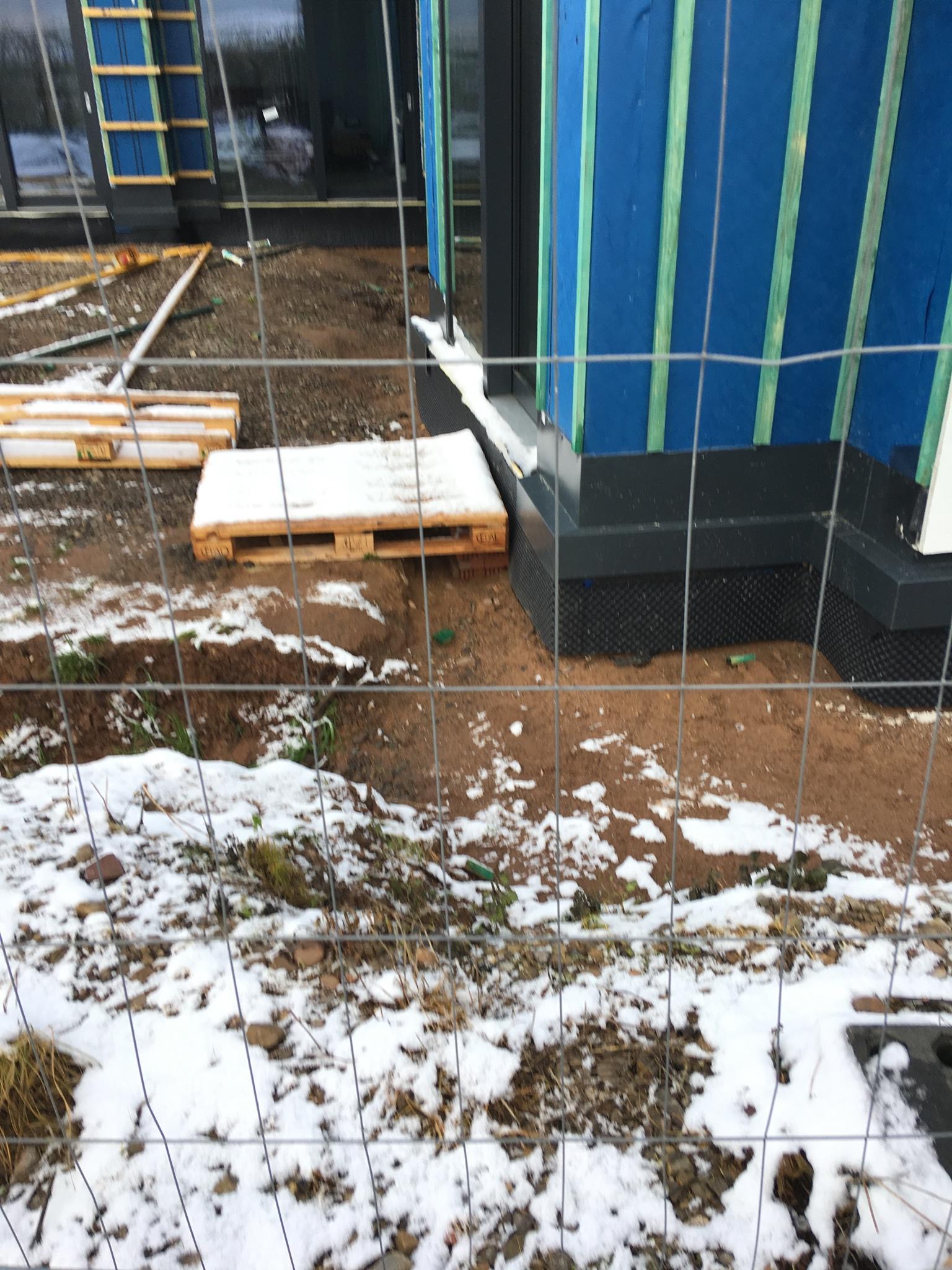

Filling round EPS foundation up to finished ground level
lizzie replied to Weebles's topic in Foundations
This is the membrane we used...its very thick and bobbly and we had special mushroom fixings into the eps. It went on before the aluminium flashings and we filled up with the gravel for drainage then the hardcore for the base of drives/paths/patios. -
We did a french drain too -
We used a membrane....remember it was £250 a roll, had a full roll untouched and pm took it away as had a buyer for it, never seen it or money for it since....can find the name from invoices if you are interested. -
