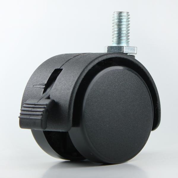

  17. Take the wheels off and replace with feet or replace with castors that have a brake..
