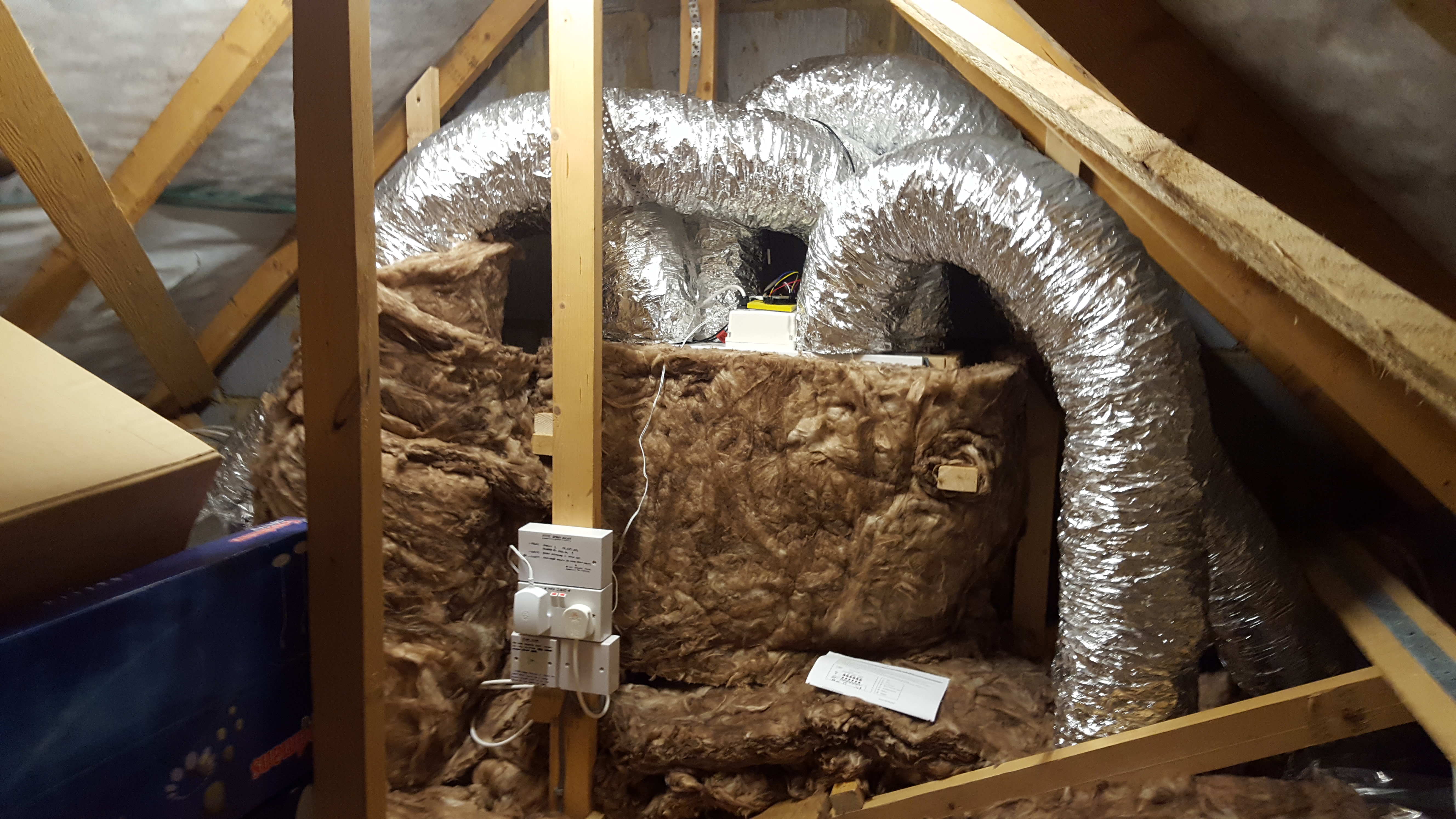

(Tripped the file limit with the first pic so following on here) And then more towards the end once the distribution pipework had been put in (4 extract and 8 supply if memory serves) along with insulation around everything: -

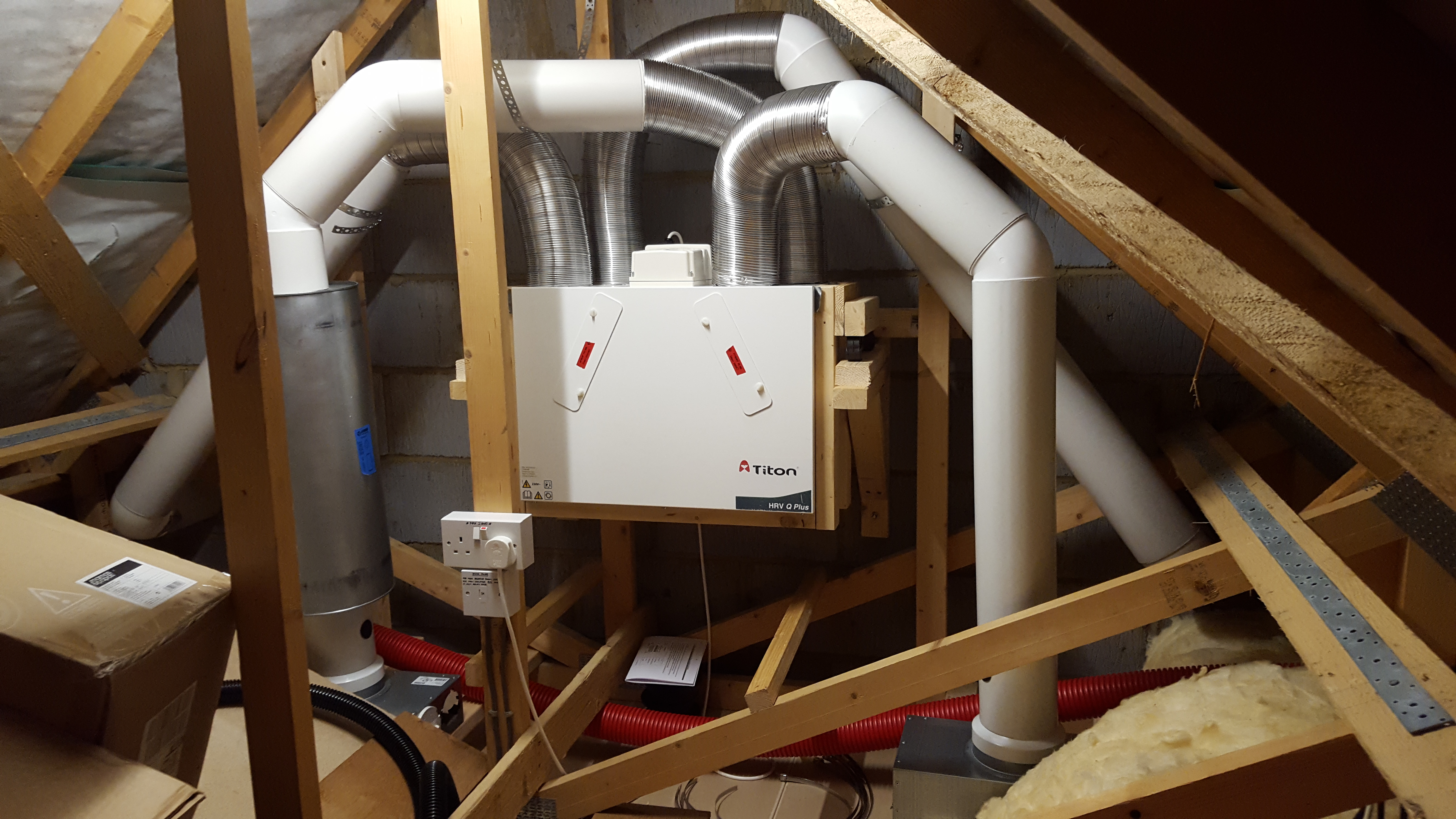

Sure! Anything in particular? As a starter for ten, here's the 'bare bones' unit mounted and with the primary connections made: -
