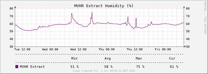

Is there a reliable and fool proof occupancy sensor for WCs out there
MJNewton replied to MikeSharp01's topic in Lighting
For what it's worth I've been using a duct-mounted DHT22 humidity sensor to detect a >5% rate-of-rise in humidity (over five minutes, measured across the whole house extraction) and in the few years we've had it running not observed a single false positive or negative. The 5% was intended just to be a starting point but it's turned out to be perfect. You can see from the graphs how prominent the spikes are (the first three are showers, the fourth a pan of boiling water) and so quite easy to detect without being triggered by more gradual variations: -
