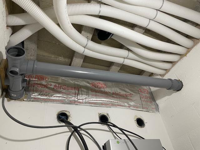

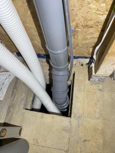

after much deliberating about the 90° access bend on the vertical and whether or not I should change it I decided to leave it alone. it got the thumbs up from @Nickfromwales and, eventually, got a 'should be ok' from @PeterW which is good enough for me! 😉
today I moved on to another bathroom which drops vertically to the comms room and joins the pipe going through the basement wall. I also managed to connect Monday/tuesday's work to it and it all seems to fit together ok so far and seems to be falling at correct levels!
as usual, I am very open to comments both positive and negative.

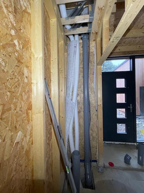

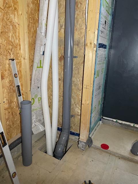

the branch for the loo. it will go vertical to the loft where I will fit an AAV.

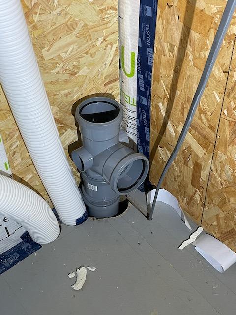

drops down with a boss fitting attached for the shower waste and maybe sink if I can't get the sink to boss above the branch above.
down through the block and beam and in to the comms room.

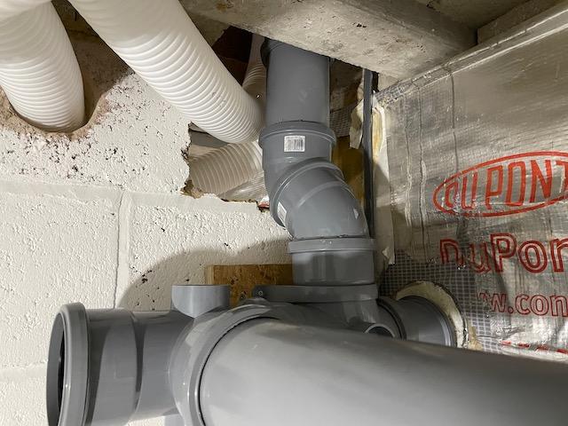

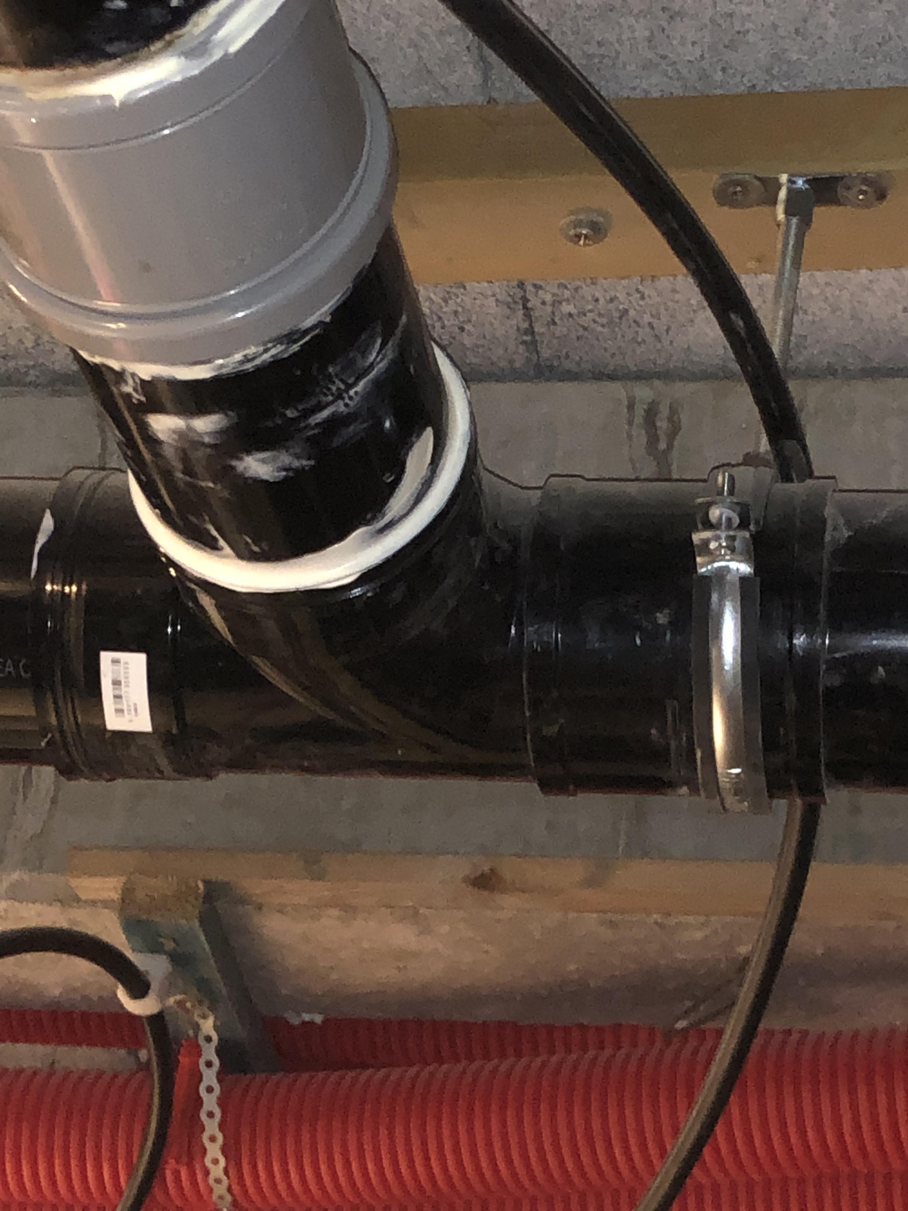

and out through the basement wall
and the other pipework joining up.
I'm happy with it and think it's correct! I know it all needs supporting but it was getting late so I'll do that tomorrow.
ps. a quick tag for @pocster to critique so he doesn't feel left out.

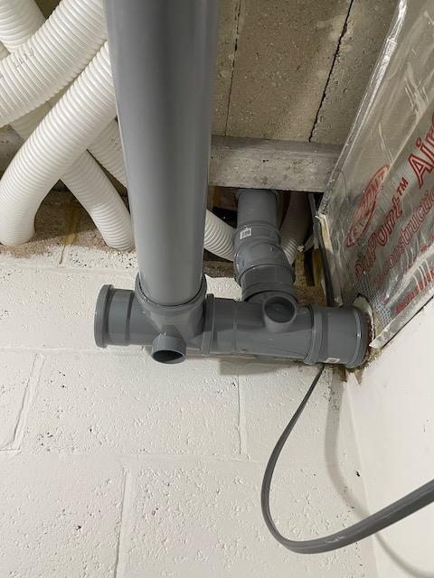

So at the bottom of a "long drop" it ends in a branch.
That is going to go "splat"  that should be a rest bend at the bottom.
the long drop goes in to a 135° bend to offset a bit before hitting the branch. does that make a difference?
also, I can't seem to find a Floplast push fit rest bend! and it's been previously suggested to pick a brand and stick to it, especially with push fit as sizes could differ. 😞
actually, I can't seem to find any sort of 110mm soil pipe rest bend that isn't designated for underground use!
1 hour ago, Thorfun said:
Plumbing is not my thing but those fittings look like they are in the wrong orientation.  I looks like you are doing a below ground design but with above ground fittings.
Yep @ProDave is right and that should have an elbow on it - if you can't get a rest bend then use a pair of 45° bends with a short section of pipe between.
I would bring the horizontal tee closer to the wall and then run the stack further out and into the back of it.
Where does the WC plumb in on that boss tee..? How close to the boss..?
you're assuming I have a design! I have little space to run these soil pipes. I've come to the conclusion that our house was designed for aesthetics with not a lot of thought about how everything is going to put in. I have to run soil pipes around MVHR ducts, block and beam, posi-joists and lots of other obstacles that make it hard to do simple runs. hence the number of 135° bends to offset around obstacles.
I'm not sure what you mean by wrong orientation though? I'm just trying to get s**t from the toilet branch to the soil pipe through the basement wall! we have 3 bathrooms that will go out through that single outlet.

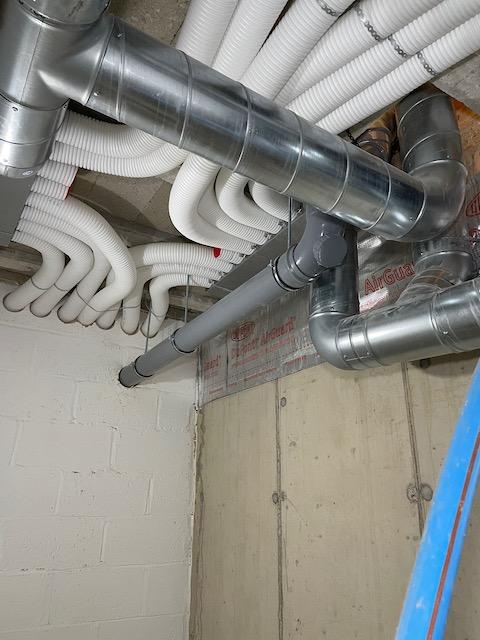

At picture 6 i don't think it will flow. Splat as delightfully explained above.
Must admit I did wonder this also ( honestly ! ) . So splat and liquid runs off but solid might linger …
The rest bend ensures solids and liquid stay together and flow.  If the liquid runs off and the other stuff goes splat it won't carry on flowing.
Yes . I have swept tee’s for this ( I have no long drops - but would want a nice bend if I did ). On your straight connections @Thorfun I see no swept tee’s which I think @Mr Punter was indicating .
Edited by pocster

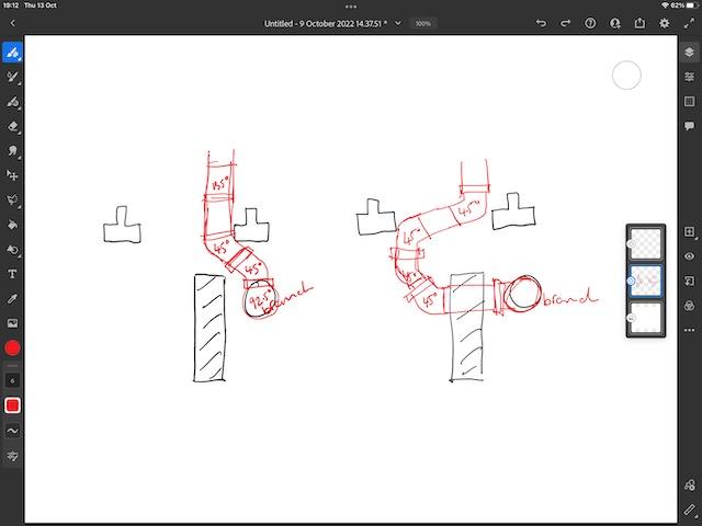

if I understand you correctly I think you're saying to put the branch on the horizontal and 90° in to it using 2 x 135° bends? if so, that would mean I would have to run the pipes on the other side of the wall and then bring it through that wall on the horizontal. but there's not a lot of space so it might not work!
in the drawing below what I've got at the moment is on the left. is what you're proposing on the right?
if so, I might have enough room to do that.
the WC goes into the branch in this photo.
the boss is just below the chipboard flooring for shower waste.
If the WC goes direct into the stub itself you may have a problem with distances to the entries for sinks and showers. Have you got a copy of the regs..?
