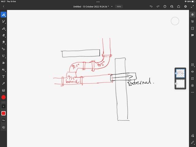

5 minutes ago, Thorfun said:

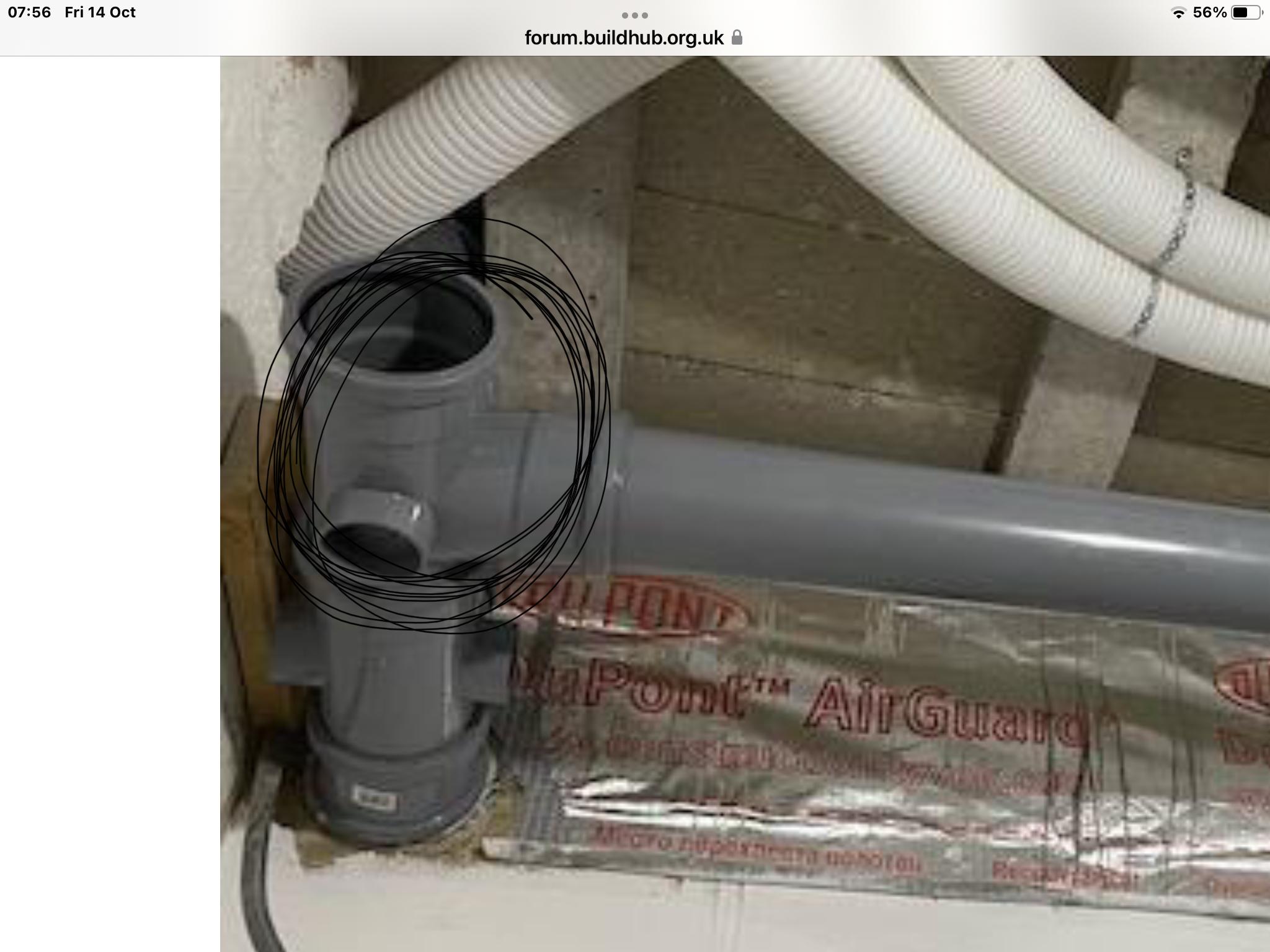

in the drawing below what I've got at the moment is on the left. is what you're proposing on the right?
if so, I might have enough room to do that.
no as you’ll lose solids again on the drop. I meant can you go further away from the basement exit point with the vertical stack ..? Or is it fixed ..? So as per your right drawing but straight up from the pair of 45’s

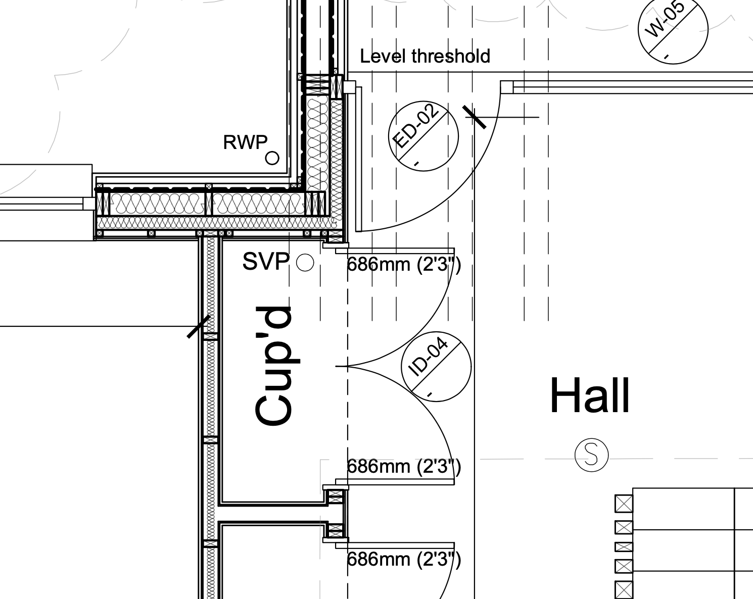

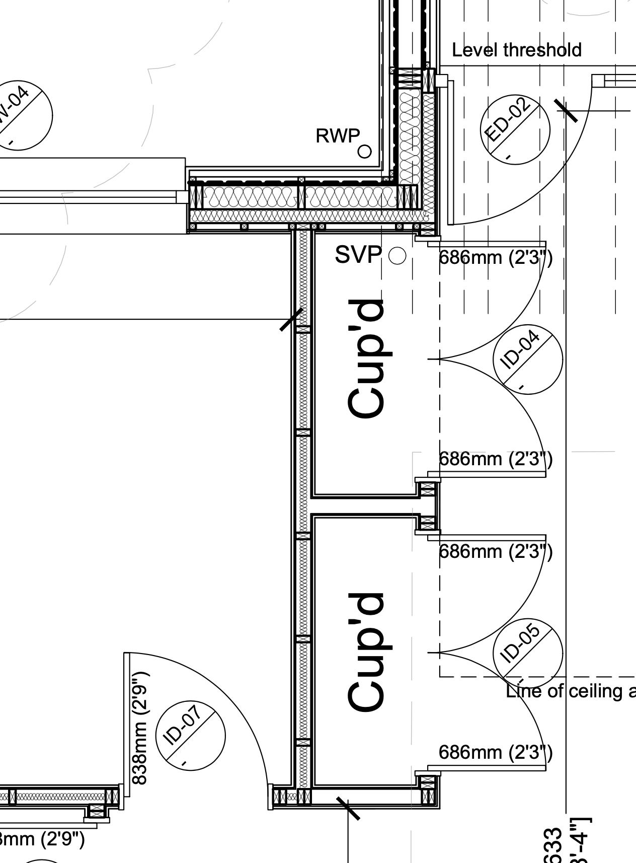

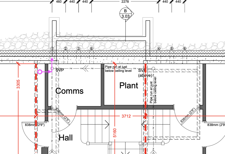

I'm not sure if that's possible. here's the plans for the area where talking about.
so the SVP in the drawing is pretty much where I've got it currently running. so I could double back on the run in the comms room in the basement, something like this side on drawing?

so I can simply use a pair of 45° with a short section of pipe between. I'll take a look in the morning and see if I can run the soil pipe straight down and bend to the horizontal and branch into the pipe through the wall (in purple below).
it all depends on how much room I have and where the beams for the block and beam are.
I'm sure it'll all be clear in the morning!

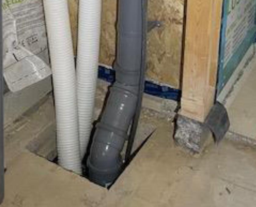

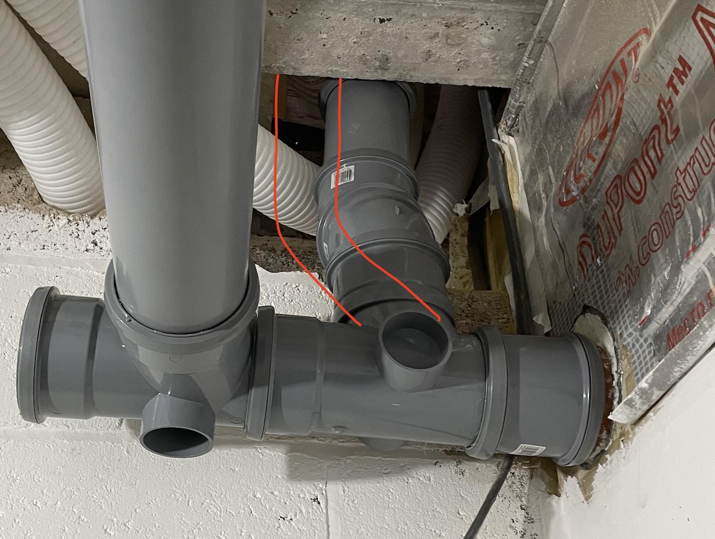

@Thorfun Get over the mix / match of underground fittings as you’ll be needing some. That branch, the one tight against the basement  wall, needs to be a Y branch not a T branch, with a 135o single socket 45 into it to collect the bottom of the ‘drop’ from above. That’ll put the brown dolphins and they’re associated paperwork travelling in the right direction for sure ;) . You wont be able to change to a rest bend as you’ll still need the rear open socket from the Y branch to pick up the second incoming foul pipe.

BCO will be happy it’s not a rest bend btw, as long as you fit a clip ( rubberised clamps ) immediately on the output of the branch, and another immediately behind it where it picks up the second incoming foul.
That one ideally needs to be the same, with a Y branch and a 45 going in to it.

ok, so I can leave all the above pipework as is and just change it to a 135° branch coming straight down? don't need to relocate the above pipework to rest bend on to the horizontal?
Yup.
135 is a Y branch 92.5 is a T branch. T branches are used in vertical pipework where gravity promotes direction of flow, Y branches everywhere else where velocity is the only thing keeping the brown dolphins moving as they should.

so, should the the branches where the WC enters be 135° branches as well then? I've used 92.5° branches.

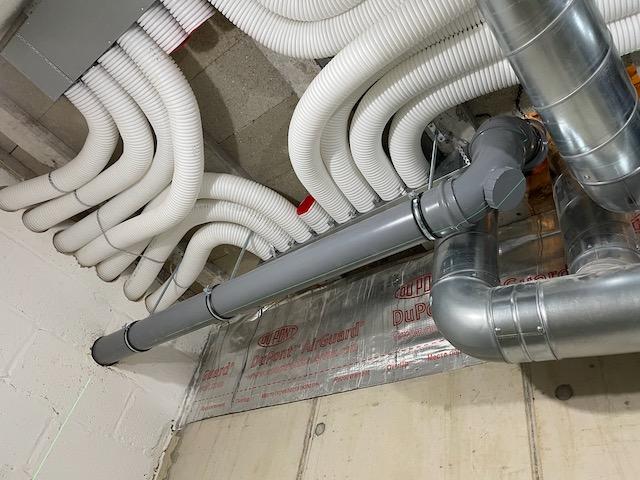

My two pence worth.
If it’s a fight between MVHR and SOIL.
Soil wins, unclip the mvhr and drag it out the way.
Soil in first mvhr will fit around it, it’s only moving air.
4 minutes ago, Nickfromwales said:
Yup. Typically only available in the underground range. Get 2 as you’ll need to do the upstream one as well.
I might get 3 and change that 92.5° bend with access point to a 135° branch as you previously suggested you'd do differently.
(photo in case you've forgotten! 😉 )

yeah, I have been doing this in certain places where possible with the 92mm rigiduct. but those massive intake/exhaust metal ducting can't be moved. at least not without major upheaval!
