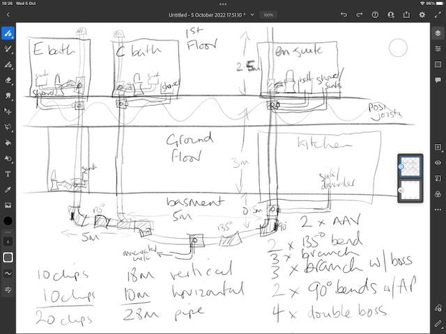

....how frequently does 110mm soil pipe need to be supported with pipe clips?

my initial soil waste design. it's quality back of fag packet stuff. 😂

1 hour ago, Thorfun said:
ok, found this on an online supplier website:
When installing 110mm PVC soil pipes, clips should be used a 1.8m centres vertically and 1m centres for horizontal pipe runs.
does everyone concur with those centres?
This is the guidelines and design criteria. If the clips are secured correctly yes. Now a 2metre long waste pipe blocked up could weigh around 150kgs which many people don’t realise and stick a couple of short screws in poorly drilled holes.
vertical yes, horizontal at 600 centres or every joist but don’t forget your falls

The way we used to install in anything other than domestic short(er) runs was to fit a metal bracket protruding horizontally, with the pipe suspended underneath, eg so there was little to no shear forces on the fixings.
Agree with getting it fixed well in a domestic setting, but I’ve never done anything other than plastic coated all-round band ( horizontal runs through posi-joists ) or plastic clips for vertical. All-round band is a joy as you just tighten / loosen the screws to raise / lower the pipe and set the fall. Tres bien.
The rule for frequency of fixings is dictated by whether or not its a solid continuous piece of pipe, or broken up with joints. A rising branch, for eg, would get a fixing immediately either side of it, and then around every 800mm, or less if you come to another fitting sooner.
Remember not to tighten a fixing where a fitting is captive, eg the pipe and fitting are not free to move together, as that can cause the rubber seal in the fitting at the bottom to be under very little pressure, and for it to be badly compressed at the top. A situation which can cause a weeping joint at the lower ‘relaxed’ part of the seal. If the pipe enters a captive fitting, put the band of that fitting and not the pipe immediately prior to it. ;)
